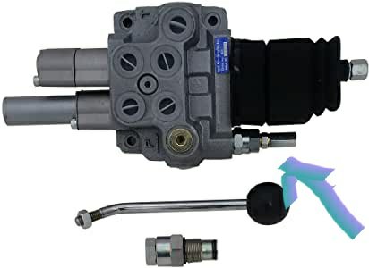

Photo of your FEL controle valve wil help us to help you ?
   / I'm feeling lucking! 1987 NH Ford 3910 with no hydraulic pressure for loader/backhoe.
This is the valve. Its a Pace 7040. Koyker still sells this one. This valve is the first thing the hydraulic power goes to. Out of the remote power block under the tractor seat to this valve on loader and then from power beyond port on this valve to the backhoe attachment and then back to tractor housing/tank. I wonder if this valve is simply worn out and returning fluid to tank anytime pressure is in the system? I mention this because the valve is plumbing power beyond and there is a return to tank on the valve too, so it's possible.
   / I'm feeling lucking! 1987 NH Ford 3910 with no hydraulic pressure for loader/backhoe. #4
This is your reliefe valve.
I think your pump is on its way uot. TEF and digger at the back is a lot of hydraulic work !20200711_174306.jpeg
I did take that relief valve apart. It looked ok. I suspect the FEL valve is just worn out and diverting pressure back to tank. Isolating the backhoe to the hydraulic system would take that valve out of the equation. If it works properly in that configuration, I know what to do.
