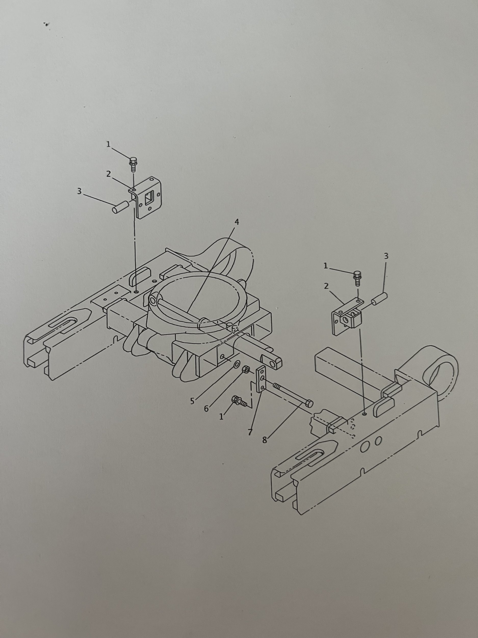

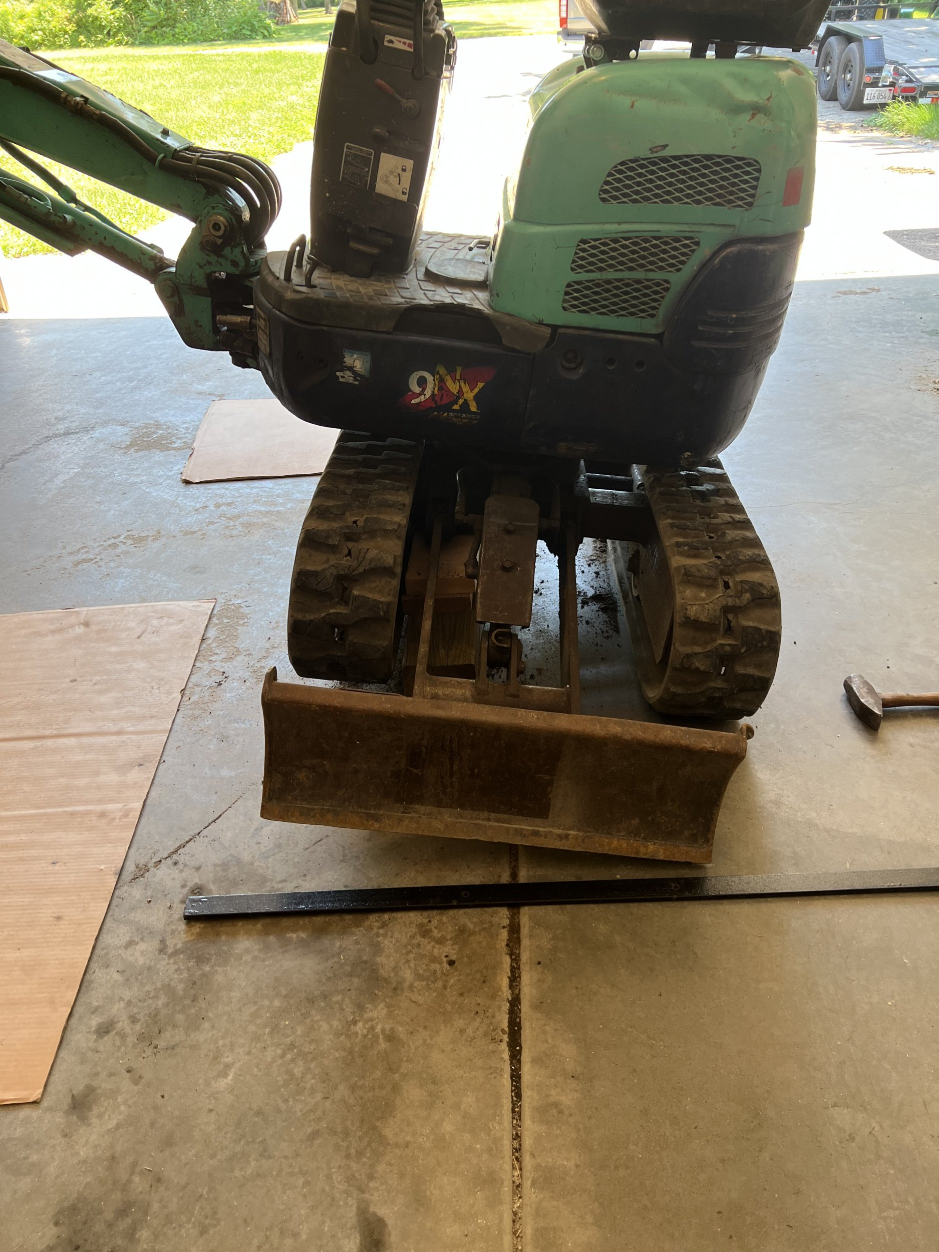

Bought an IHI 9NX-2 Mini Excavator on an auction. Fixed everything wrong with it except the tracks will not extend on the right side.
It is a simple tube in a tube design with one hydraulic cylinder that pushes the tracks out till they hit a stop bolt on either side.
The left side extends the correct distance and hits the stop bolt. Right side does not budge. Checked the stop bolt and it is fine.

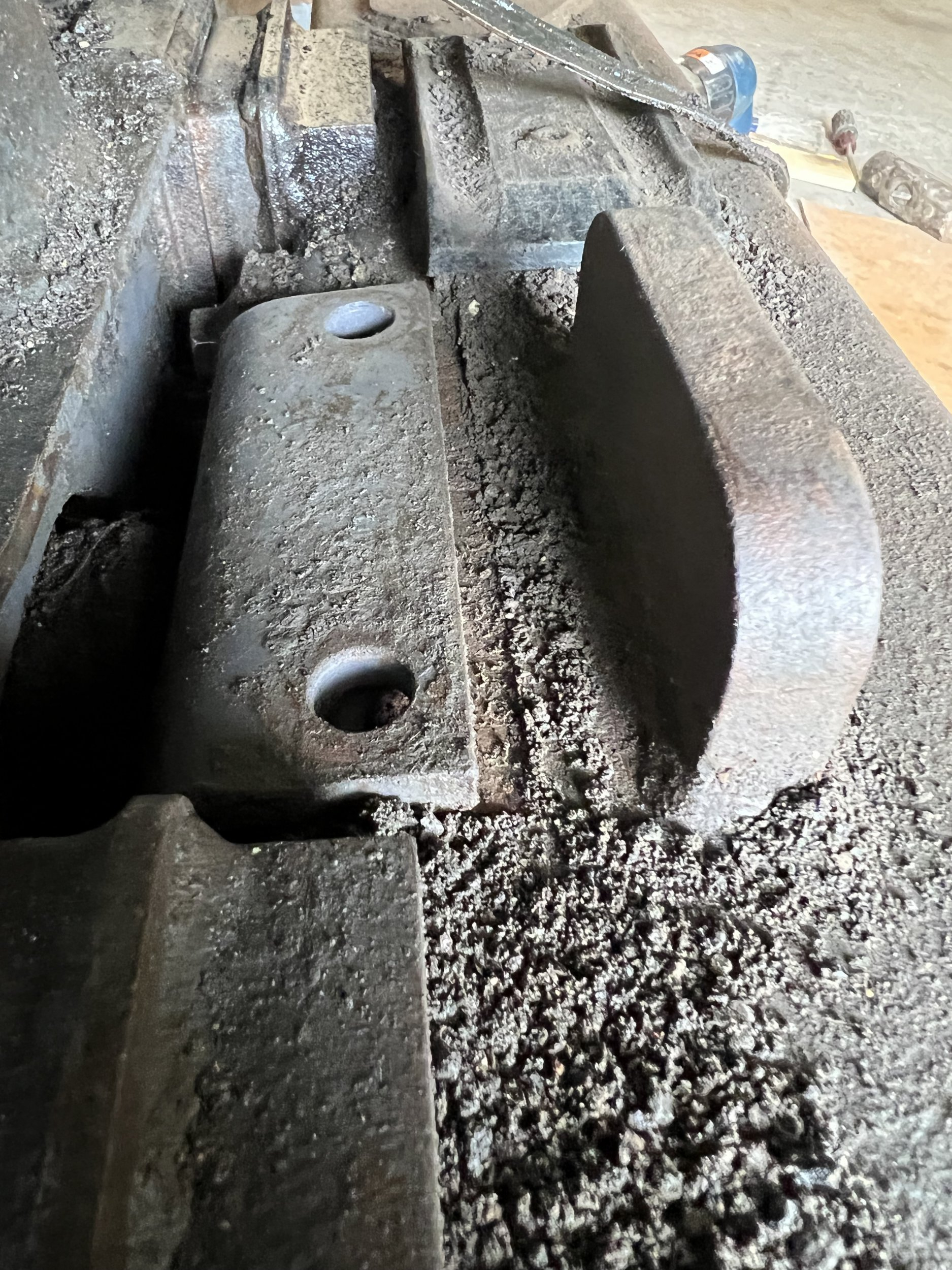

Loosened the track frame plate the cylinder attaches to and the cylinder will retract about 3/8 inch. I'm assuming if there was a cylinder issue, I should be able to manually force the track frame out 3/8 inch. Still doesn't budge.
I took the plate off the bottom of the main frame below the hydraulic cylinder. I was able to place a bottle jack with the base against the frame and the piston pushing on the same plate the hydraulic cylinder pushes against. Doesn't budge.
Tried soaking with penetrating oil for days.
The right track frame does look like it was hit hard. Has 2 dents like a forklift hit it. I'm guessing the hit jammed the tracks in so hard they are
wedged tight. Only idea I have left is to completely remove the left side track frame to look inside the main frame tubes to see if there is an internal stop the right side is wedged against. Any ideas on how to tackle this problem would be appreciated. Thanks!

When Required Maintenance And Checks; Tracks Check/Adjust; Track Tightening; Track Loosening - IHI 9NX Service Manual [Page 72]. Seems like you know plenty about it . I'd say your just about to figure out issue.
