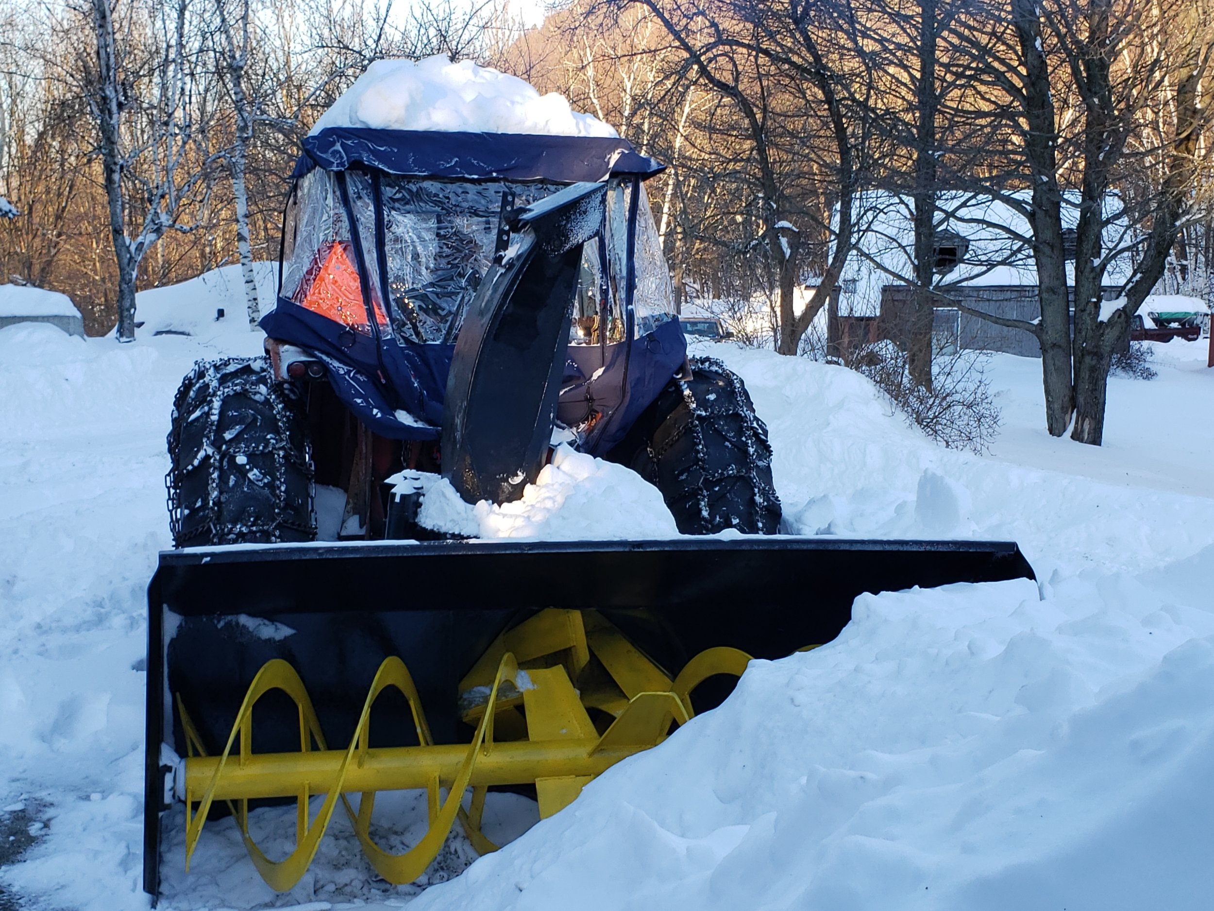

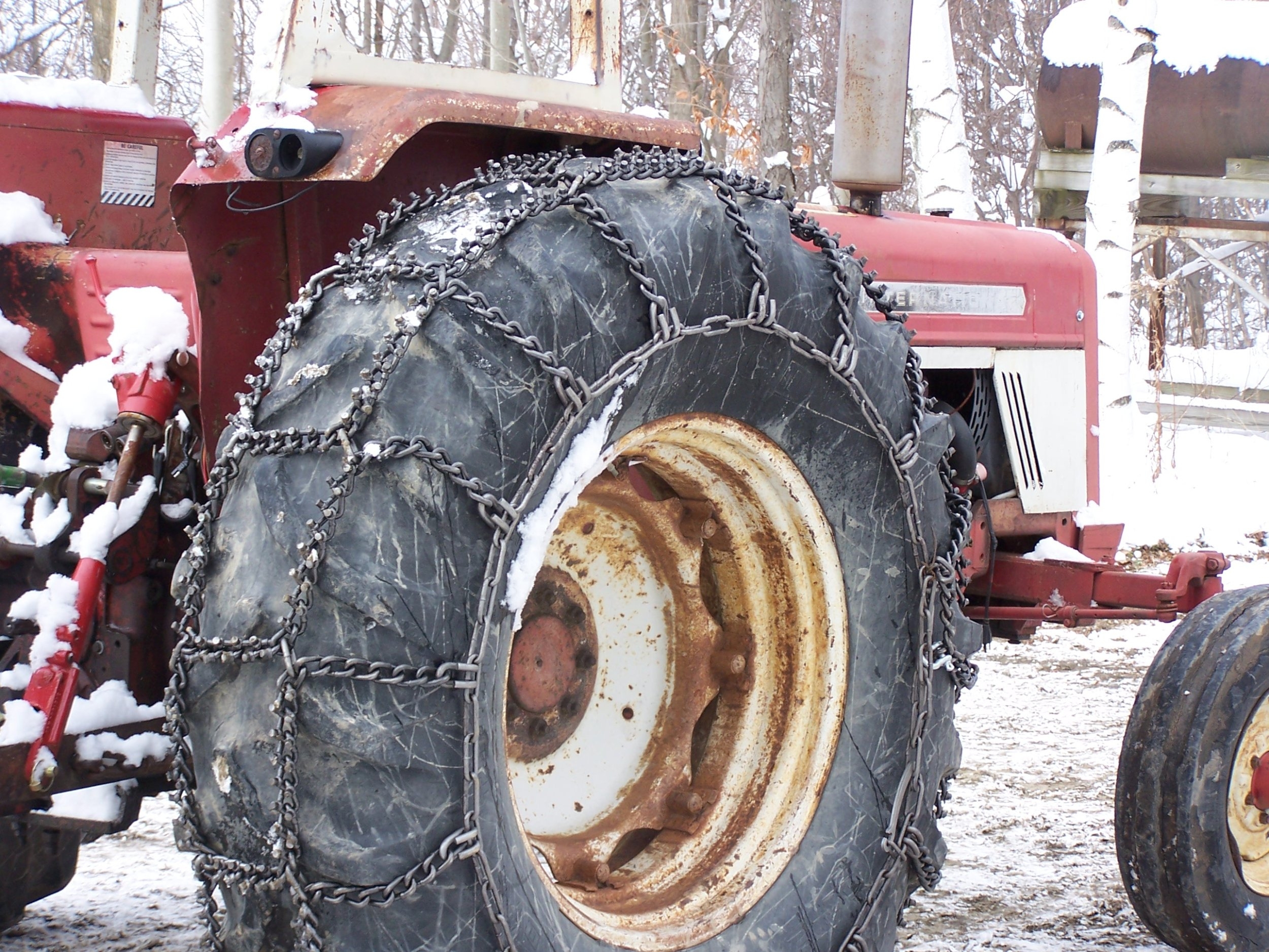

I have used the blower on her, I also run chains.
   / IH674 with cab and blower tire pressure
Nice studded chains, thats alot of welding:) , With my blower 1/4 inch steel it bends at bottom of tire about 2 inches with blower raised , didn't notice a bend with other tires it was my friend with 574 that noticed, then he checked his and was 30 , he has same blower, but 30 seems alot, my tires say 28 max
   / IH674 with cab and blower tire pressure #6
By bending I'm assuming you mean that the sidewalls are bulging out a bit were the tire meets the ground. If you do not get a good sidewall bulge you are not getting much tread on the ground.
you can see the bulge in the sidewall in this picture, if you look close you can see that I have two thread bars in contact with the ground.
