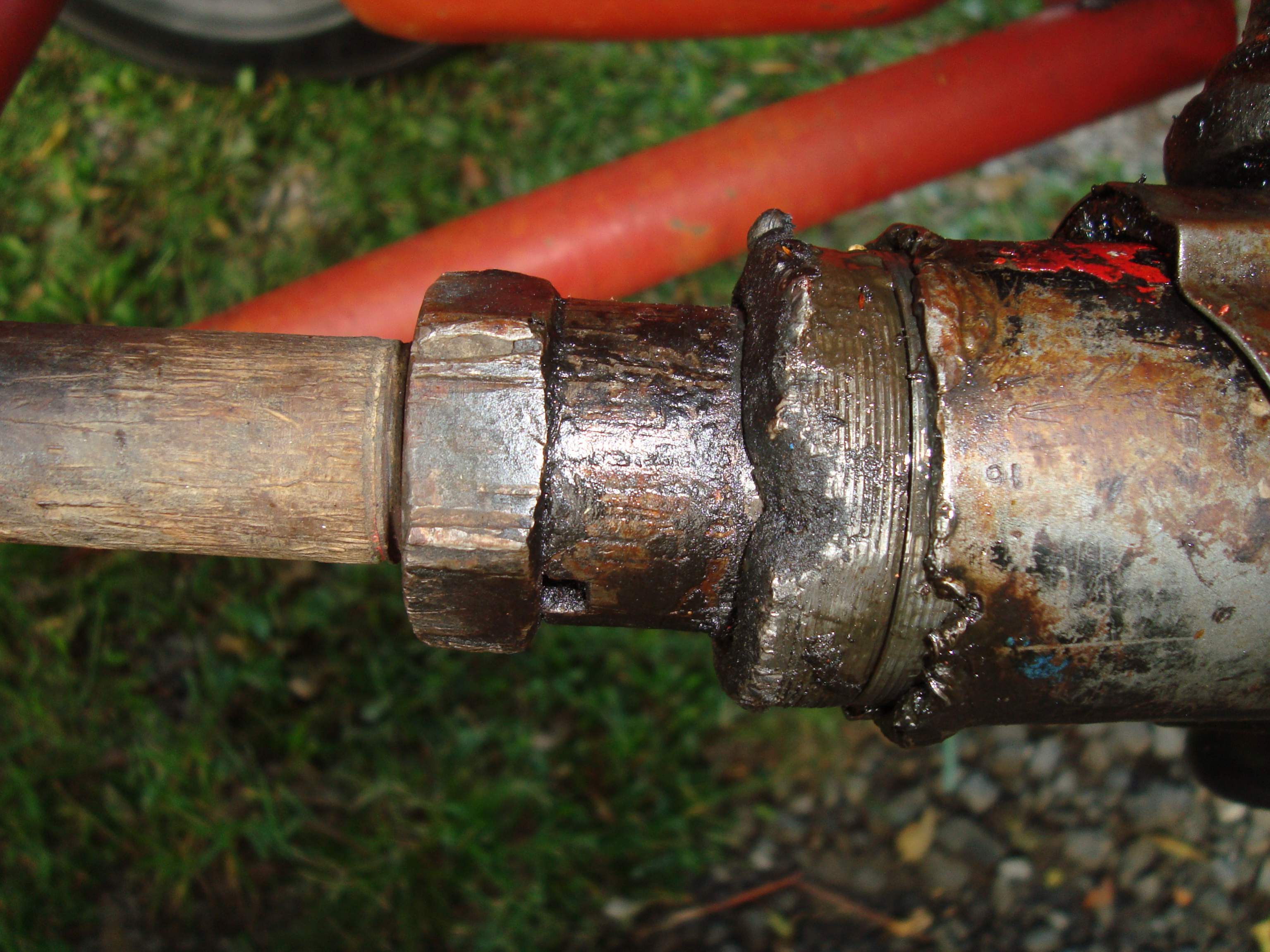

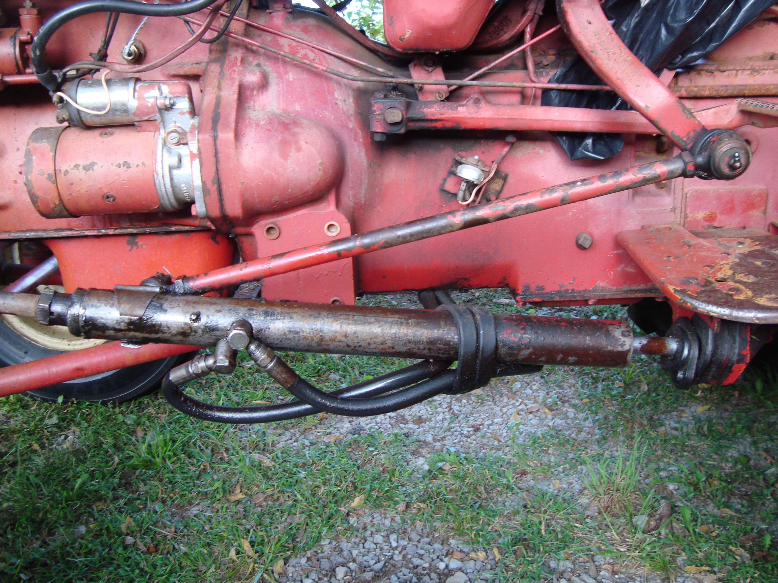

Need to replace a broken power steering cylinder for my English-built tractor. The part number is 3043938R92. The old cylinder broke at a previous weld repair. Had it broken just 5 seconds later, the tractor would have gone into my pond! Can anyone out there help to find a serviceable replacement cylinder? DSC02557.jpg
Thanks!

I enlarged your picture. Looks to be the ram part of the cylinder towards the back..?? If you have a good hydraulic repair shop near, I'd be tempted to see if they could make you a new ram. That is, if the cylinder tube is still good. It may be a bit cheaper than the used cylinder. Just a thought...
More than likely metric, but with all the newer equipment, I'm sure there is a lot of metric stock around.

It's actually broken at the forward end of the cylinder where a weld repair had been made long before I bought the tractor. I'll attach a photo. Meanwhile, I have ordered the used cylinder from Wegners. Fingers crossed on it! Thanks.
Was going to replace the hydraulic line banjos, bolts and washers at the same time because they have always leaked some oil, but only the washers are available from CaseIH. Maybe the banjos are just some kind of industry standard item? I have to check on that.

Hope it does the trick. Usually there is some sort of warranty, or at least I'd think, for that kind of money... Believe I'd go to epay, and search that part number, or tractor description, then save that search. If ever one is posted to sell, it will let you know. If it goes for a reasonable price, believe I'd salt one away... I did the very same on a shifting cover for my old 310 B Case hoe... Found two within a month for $35.00 and $32.50. Well worth that, and let them go with it, when I sold it.

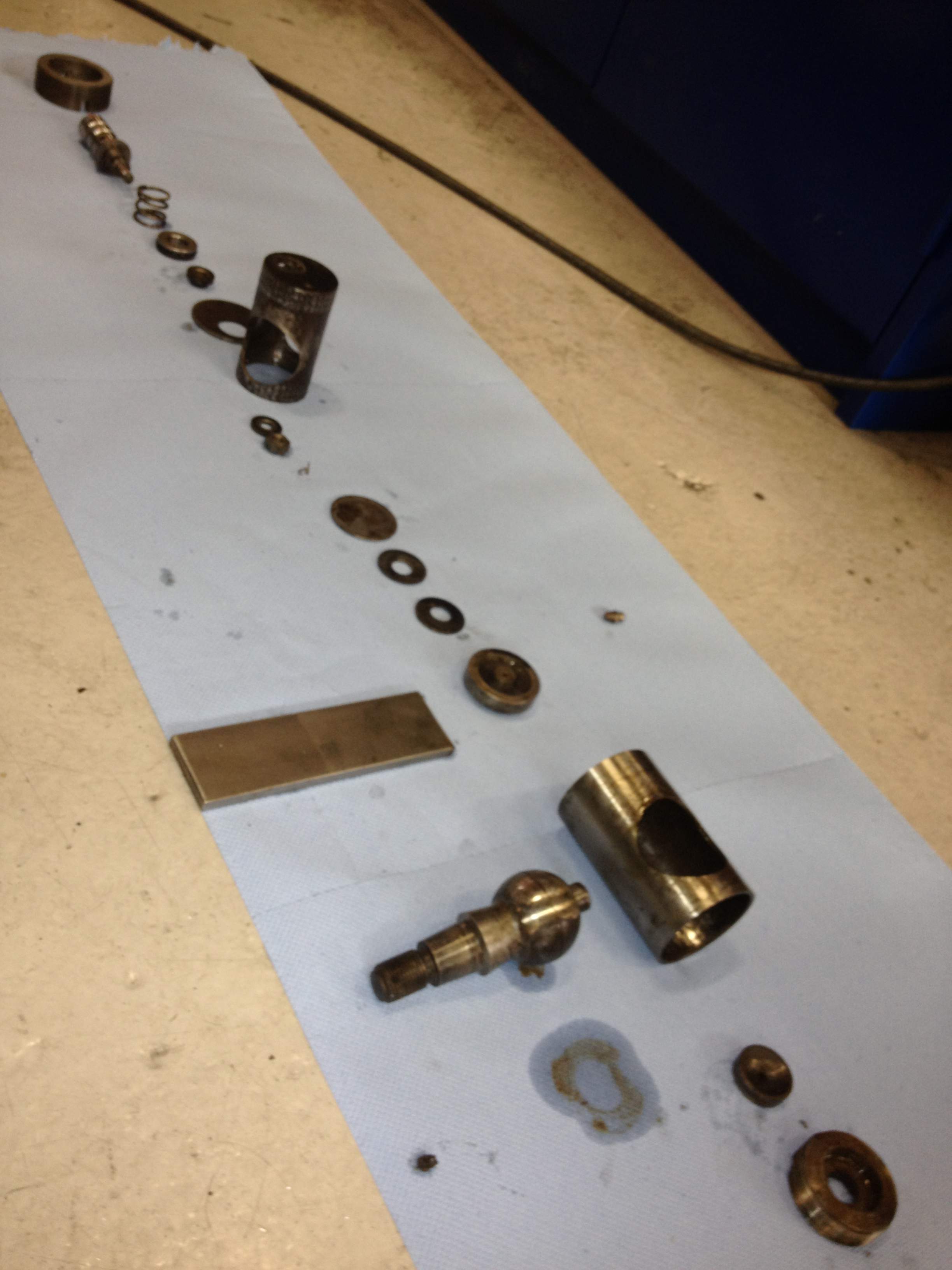

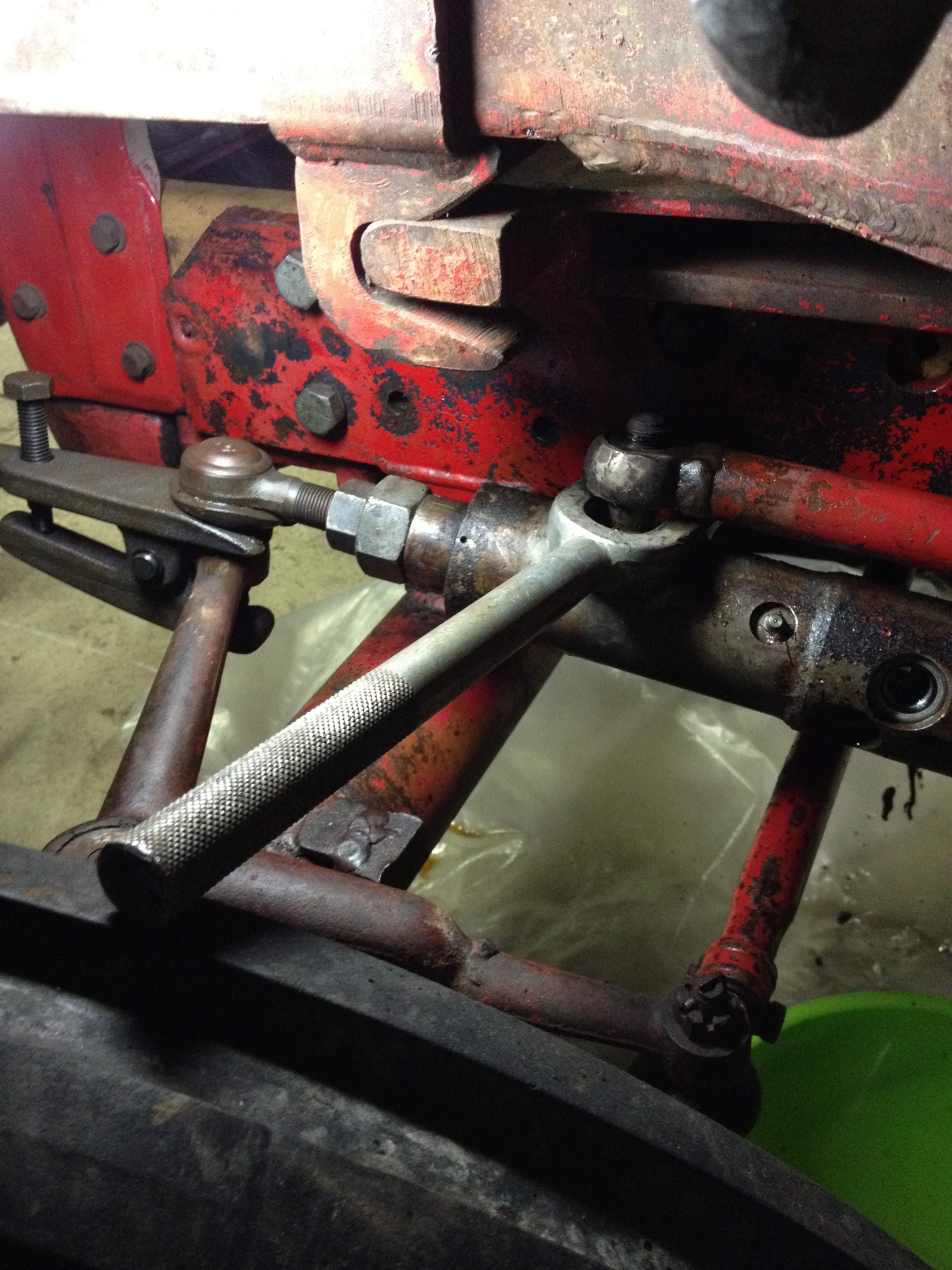

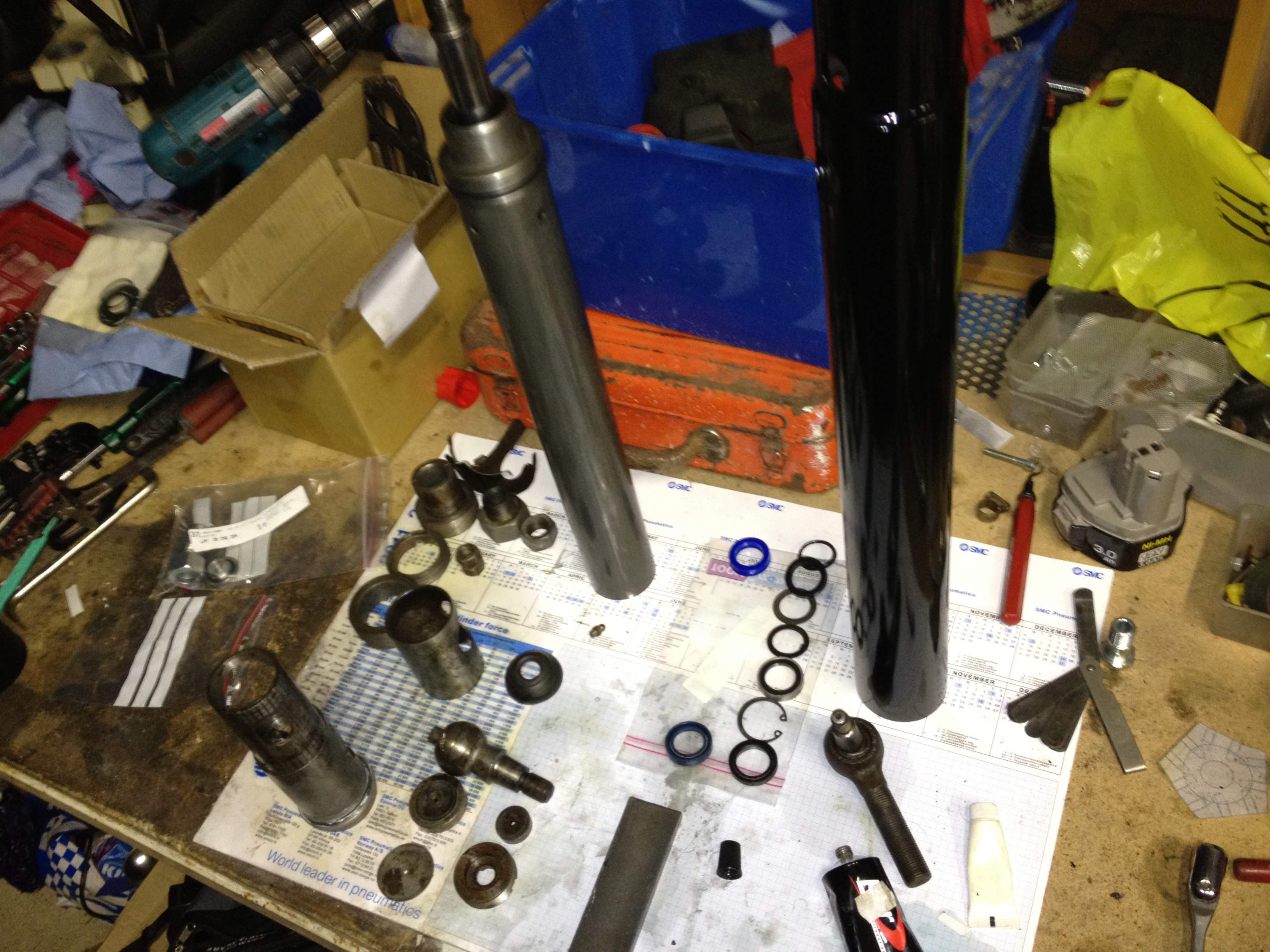

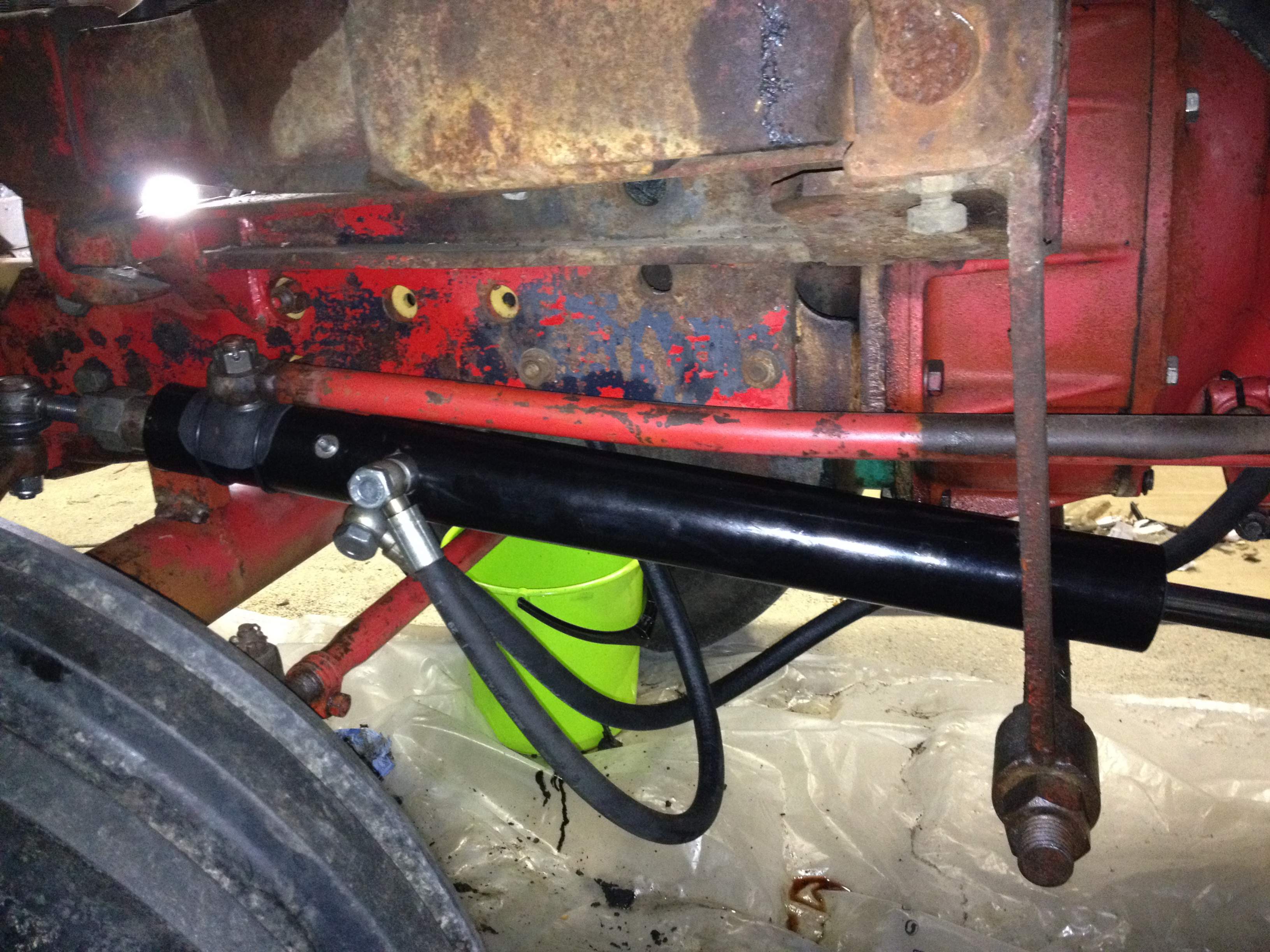

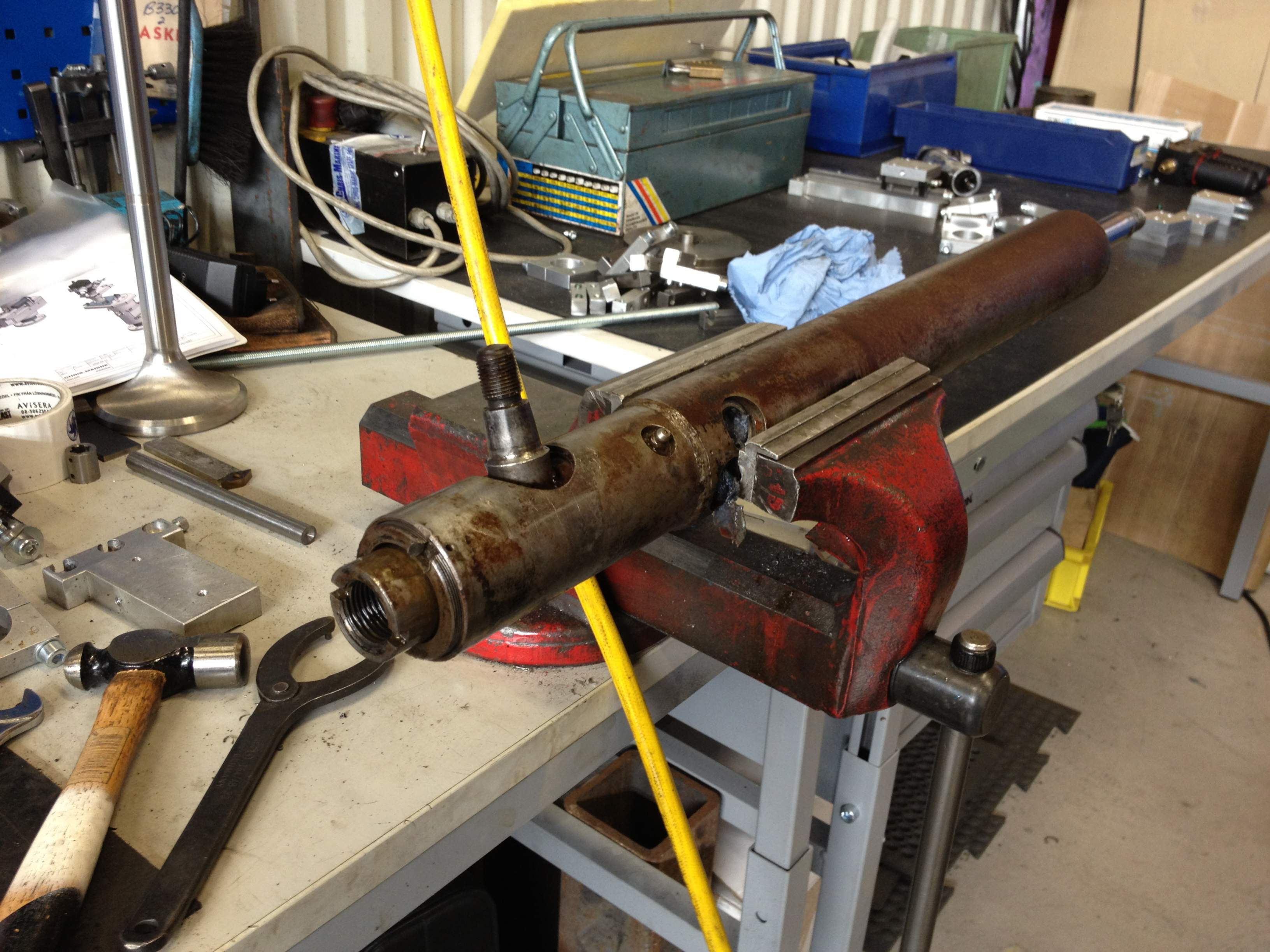

Hi!
I'm just now looking for a "lookalike"- power steering cylinder since I'm refurnishing mine of my Volvo BM Buster 320 for which it's non original.
Got to ask you not to throw away your broken one and let me know if you want to sell it. ;)
I need to ask you about your cylinder - what kind of make is it and is the o-rings/seals in it metric or inch?
I have made an overhaul on mine but the valve cage part is still leaking, so by replacing the old ones with new was a mix of both measurement system. But I guess someone else have been fiddling with this cylinder before. Do you know of a repair kit for these cylinders?
Now, about the banjos.
I also was looking for replacements but soon found that I had to make my own since today’s standard are too short or double banjo. It's really not that hard but you have to order M16x1x45 bolts (little uncertain about the length, just make sure the non thread part is long enough) and drill the holes yourself. Not only can you make them the same, they will be better since the bolt head is larger and gives you a better sealing surface.
Choose modern steel/rubber seals and not copper washers.
This part worked great on mine; you can have more details if you like.
Best regards/ Henrik - from the south of Sweden
