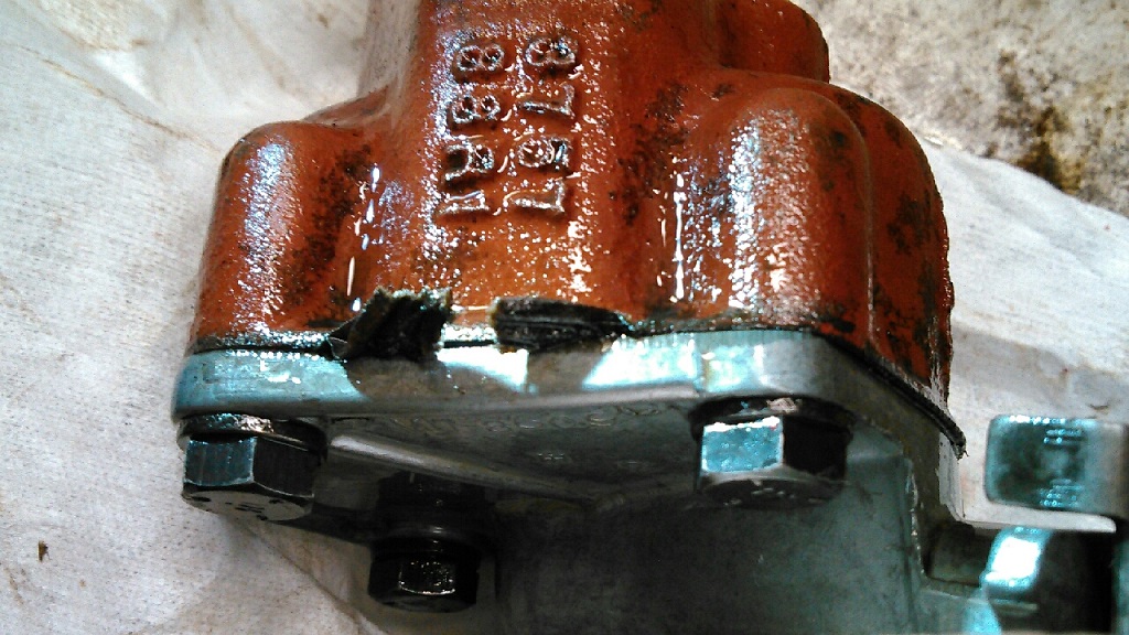

I have a 444 that loses oil pressure when engine warms up. I removed the oil pump to find the gasket blown out and the pump cover
bent about .020 between 2 of the bolts. Anyone else have this issue, or know a good fix?

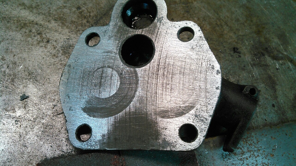

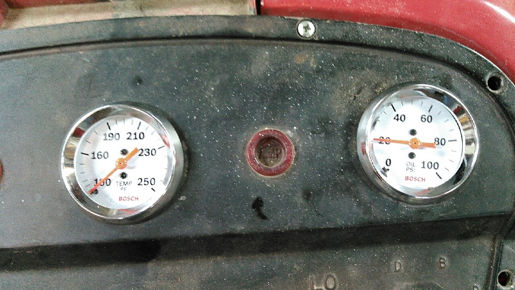

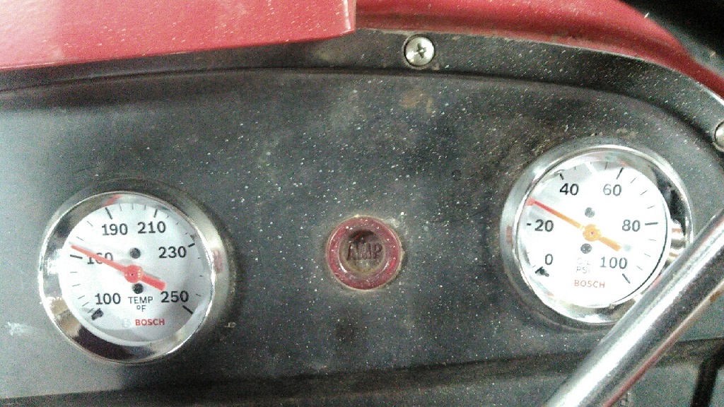

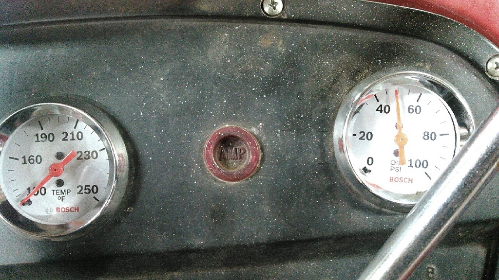

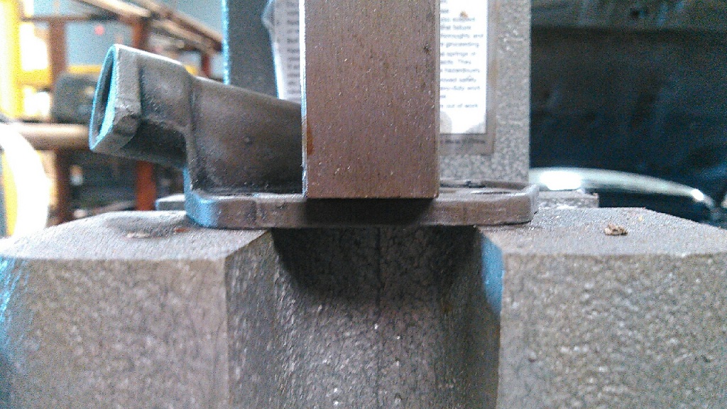

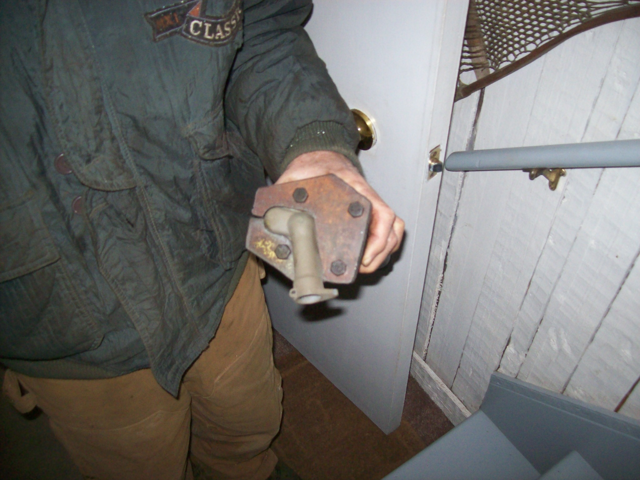

There is a known problem with this pump bending the end plate. I thought I would share what I have learned and how I have fixed mine.

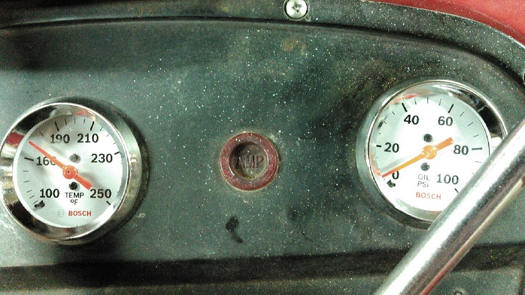

First I got rid of the oil light and installed gauges so i would know what the pressure is. The first 2 pics are idling, cold and hot.

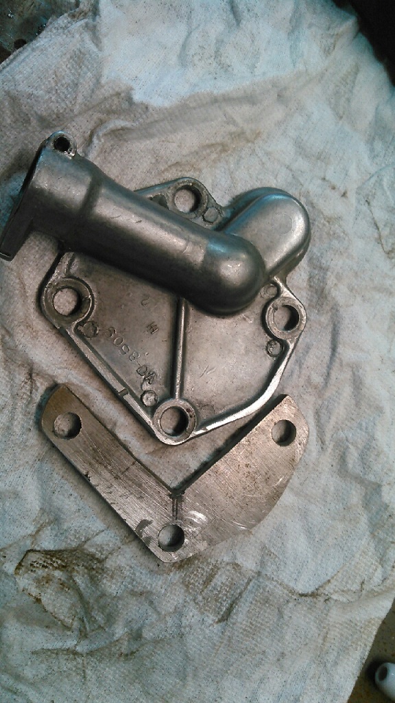

The next shows my pump

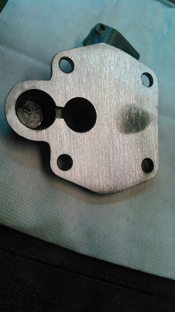

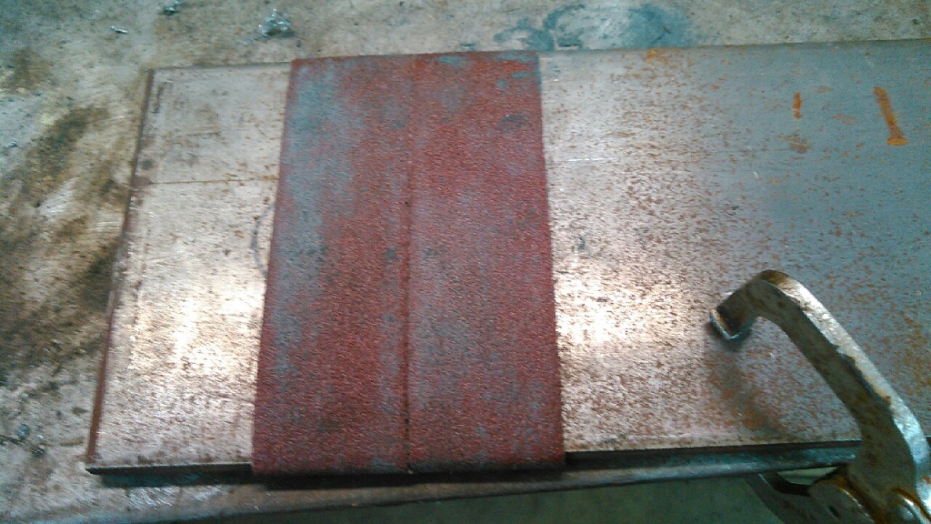

So I put emery cloth on a flat surface and ran the end plate across it to show where the bent area was. next was to get it straight as I could without breaking it.

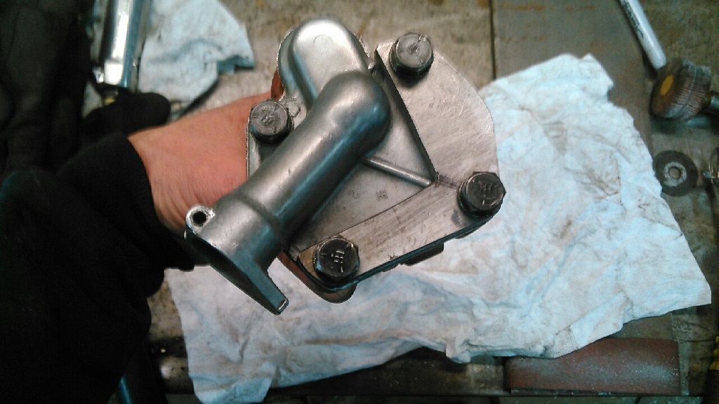

After straightening it was just a matter of using the emery cloth until it was as flat as I could get it. I went more after the pic was taken to get rid of the last low spot. then made a support out of 1/4" steel. I had to grind a small groove for the web that runs on an angle from the middle bolt, that doesnt show in the picture.
/ IH 444 oil pump problem

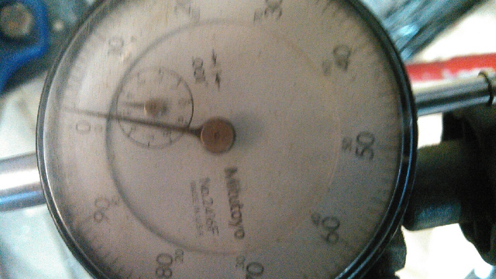

The next was to cut a gasket, I used 1/64" and bolted it back together. I checked the end play and got lucky it was .002 (hope I wrote that right) with the dial indicator. reinstalled and was happy with the results-- idling/ cold and hot.

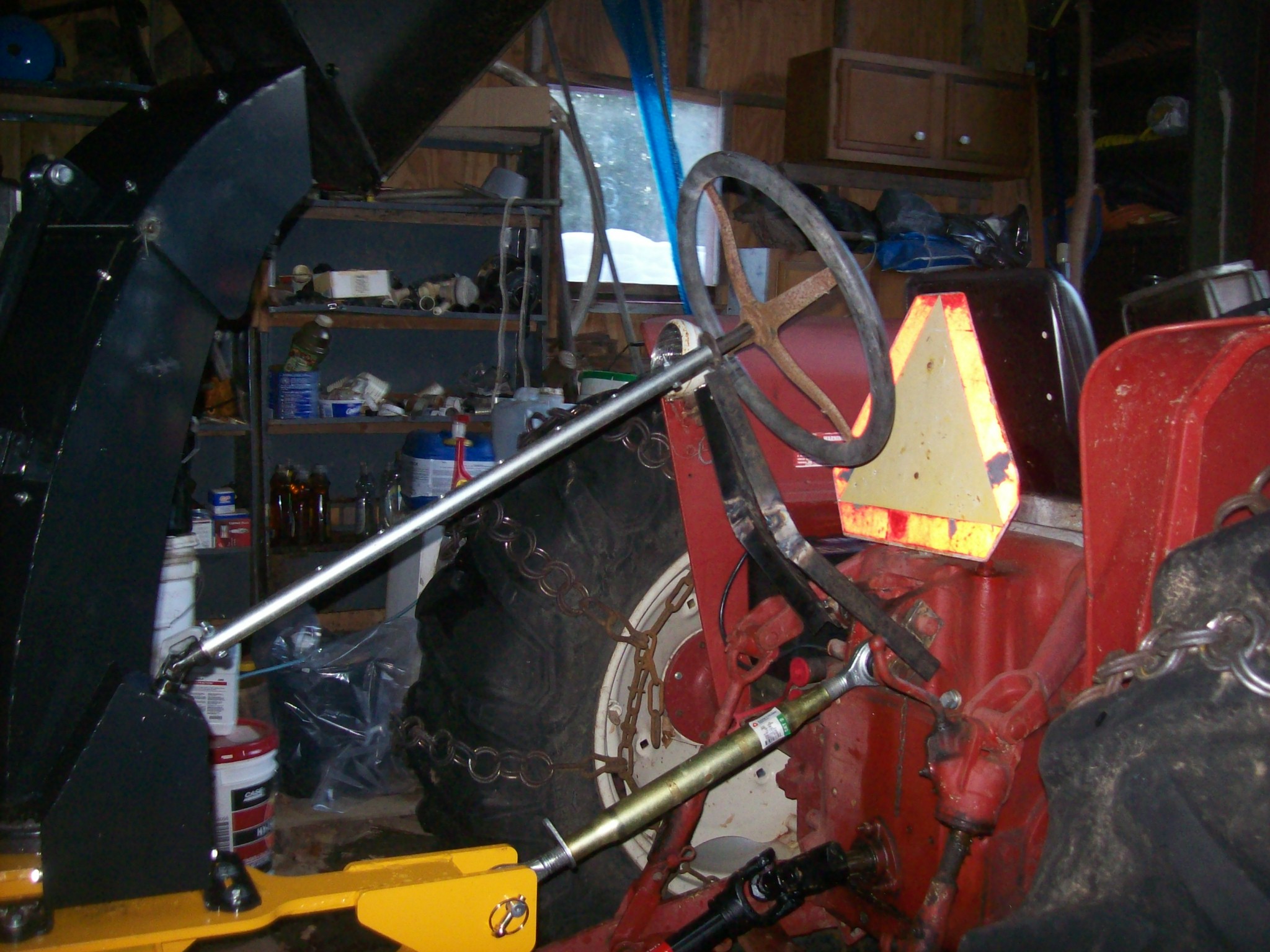

I am the same way. Everything is raw materials and you never know what you will use something for. I've even threw something away and before the day is out
i needed it and retrieved it from the trash. Prime example is the crank for the snowblower I put on the 444 was hard to use and I had an old steering wheel I've had for 20 years and knew exactly where it was came into use.wheel.jpg Thanks again for your efforts on your post.
