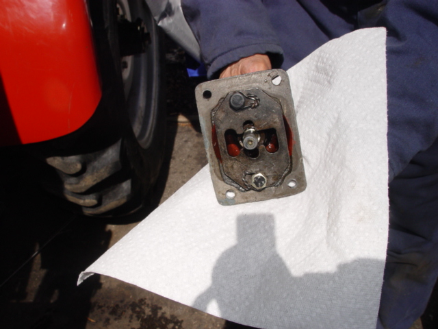

I don' know that transmission but I had that problem. I took off the trans tower. The slector plate had two bolts in it and one had fallen out. I drilled the plate and the bolt heads and laced them and the problem was solved. If I can find a picture I'll post it. I did post the fix in Chinese tractor the thread was called "gear confusion". Richard found one here it is:

Thanks for the info. I reviewed your previous post and especially appreciate the pictures of your solution. I will let you know what I find.
