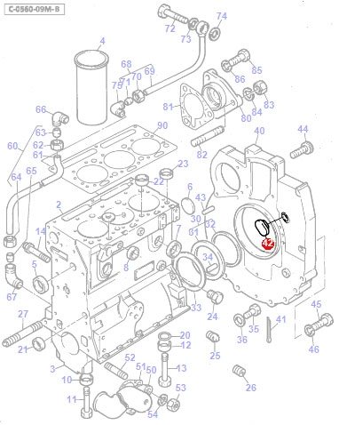

UPDATE: I bought a timing light, Innova 5568 Pro-Timing Light with Tool Case. Can someone please tell me where I am supposed to point the light on the perkins gas?

Maybe the front crankshaft pulley/damper or on the flywheel.

#9
I found it in the Service Manual.
" To check ignition timing, use a timing light attached to No. 1 cylinder and an electric tachometer. Start the engine and direct the light to the timing hole in the flywheel housing. Carefully move the throttle lever to WOT position (2225-2275 rpm) and observe the timing readings. With the engine properly timed and the distributor advance mechanism operating properly, the timing should gradually increase to a reading of 26* BTDC at 2000 rpm without any further advance above this speed. Advance, or ******, timing if necessary by loosening the distributor clamp and turning the distributor body. Turing in the direction of rotation of the rotor to ******, and against the direction of rotation to advance. Clamp distributor when correct setting is found."
So there it is. Looks like my light should be good since it also includes tach features. Now I just need to locate the hole in the flywheel housing.
   / Ignition timing adjustment after EI install.
Found it. A rubber plug.
