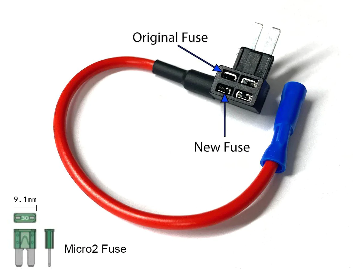

I got a back-up camera for my JD 2032r and I would like to power it from the accesory pin on the ignition switch so it comes on when I start the tractor. The part # of the switch is LVA21501. Anybody know where I can get a pin-out diagram for the switch?
   / Ignitinon switch pin-out #2
The best source for that would be the service manual for your tractor.
Another easy way to do it, is to get one of those fuse splitter things and use a switched circuit from the fuse panel to grab a switched source for the camera. However this solution may or may not fit inside the fuse box with the lid on. Just keep that in mind.
   / Ignitinon switch pin-out #3
use a multi meter and see what is hot only with the key on....easy peezy
