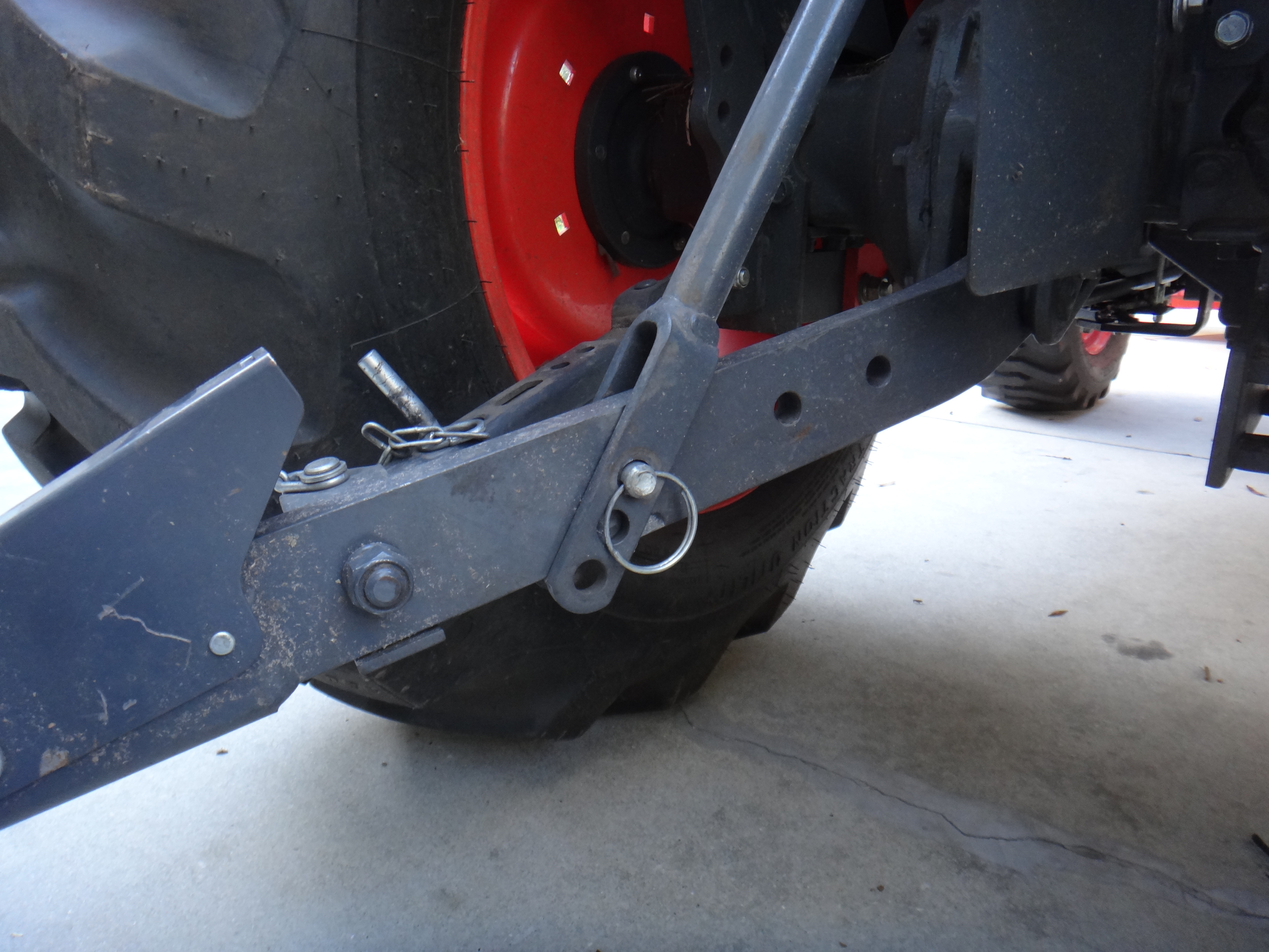

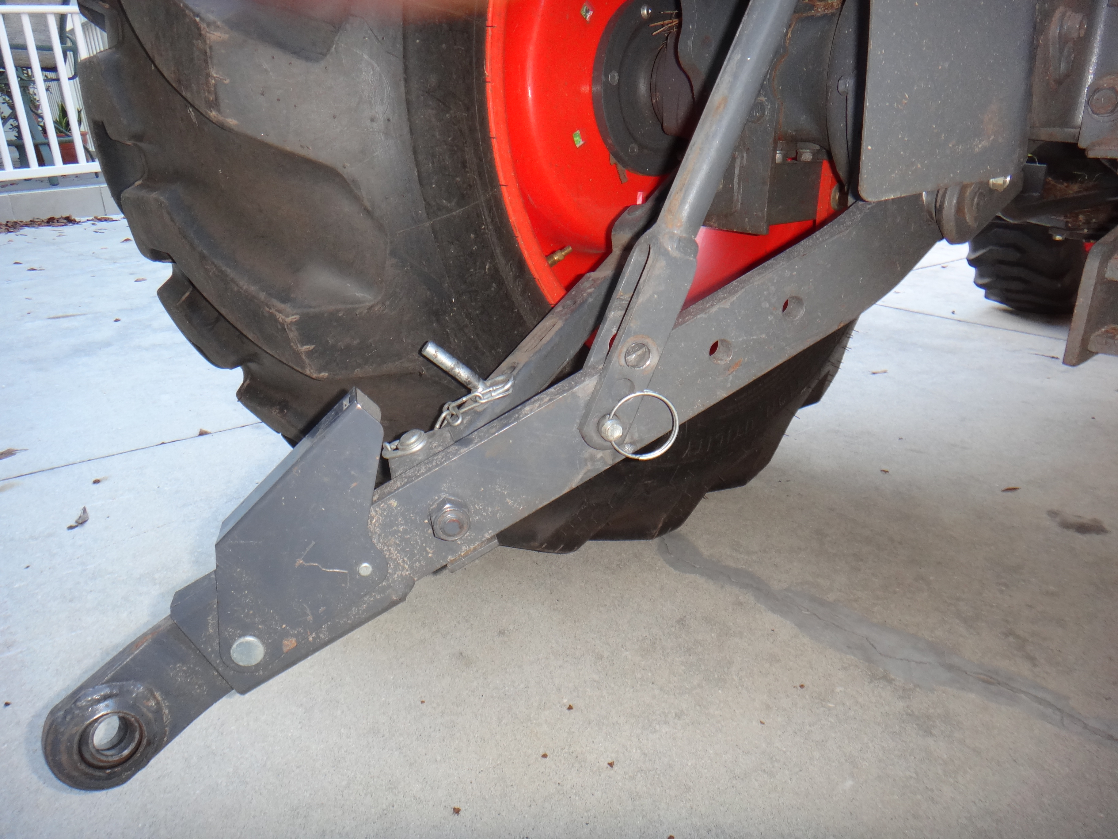

I cannot speak to the B2650, but on my B3300SU and current L3560 further adjustment down is available by moving pins which hold left and right Lifting Road stirrups to the Lower Links, from the default upper hole, to the lower hole. This allows implements to drop a further 3" to 5".
Especially useful when using a Box Blade, Angle Blade or Landscape Rake to tear down mounds, where the front of the tractor is lower than the rear of the tractor, raising the implement. This additional adjustment is also needed when using lawn dethatchers, in order to get dethatcher tines well into the surface.
Stirrup pins and holes are standard Three Point Hitch adjustments designed and patented by the Three Point Hitch inventor, Harry Ferguson, in the mid-1930's.
The BX series Three Point Hitch does not have these adjustments due to its small size.
Photo #1 standard/default Left stirrup pin position in UPPER hole. (L3560)
Photo #2 optional Left stirrup pin position in LOWER hole; lowers implement 3" to 5". (L3560)

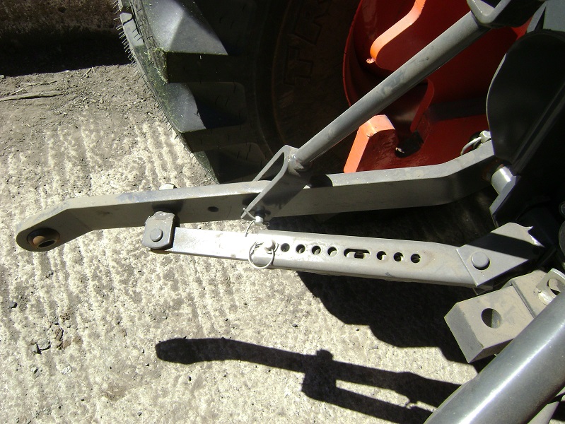

My B2650 does not have upper and lower holes, but it has two holes, one set closer to the axle and one set closer to the attachment eyes. Default is the pair closer to the attachment eyes, but I had to move them to the pair closer to the axle for the mower. This would only be an issue if I were lifting heavy weight implements

It doesn't have multiple holes on the lower yoke end of the side links? I thought that was common/standard on all Kubotas? The holes won't be on the lift arms, they would be on the side link lower yoke.

Here's the new B2650 links just for comparison.
