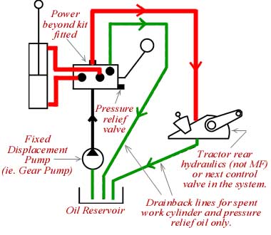

Let me give you a few things that will help you get a basic understaning of the way that our tractor hydraulics work. Basically you cannot "T" into anything (except the return line to the sump). Our systems work in a "series" rather than "parallel." You run the pressure line to one valve assembly, then through a PB (Power Beyond) to the next valve in the series (maybe rear ports), then through the PB on to the 3pt lift. At each valve assembly there also should be a return line to the sump, these can be "T'd" together.

There are two types of hydraulic systems, series and parallel. MJ is correct that the most common system is a series system. In a parallel system you would use a variable displacement pump. On the series system all valves are open center and on a parallel system they use a closed center. Price wise the series is the lowest cost system to build.
Good luck on your build.
