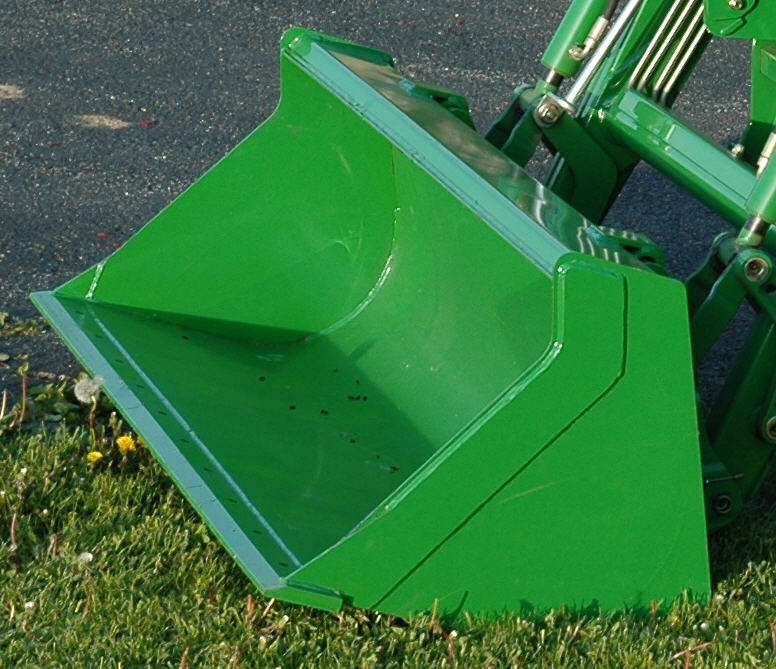

Here is the best pic I have of the bucket ... back when it was brand new and shiney.

Looks like the HD to me.
Go to the options on buckets at the JD site, and I believe the HD shows as a narrower width than the light duty materials bucket (snow, and such). Bigger size, less steel.
Look close at the top edge and see if it is single layer of steel or double. The HD (mine anyway) has double, and the other clue is the extra layer on the end, front edge shown in the pic. I don't believe the light duty has that extra reinforcement.

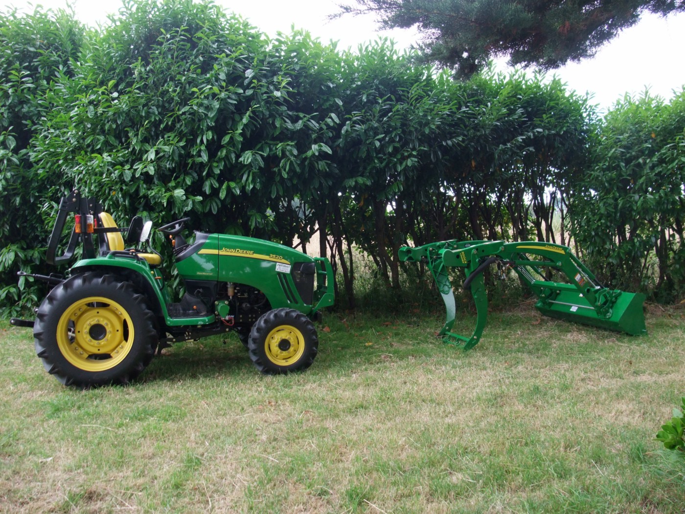

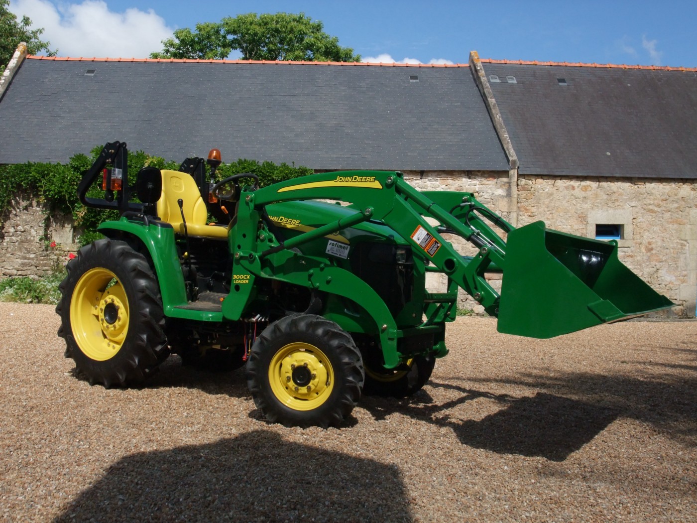

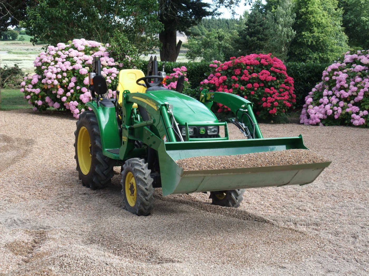

You have the heavy duty bucket, here is what the standard bucket looks like (no reinforcement on the sides, no holes for edge or toothbar ...).
