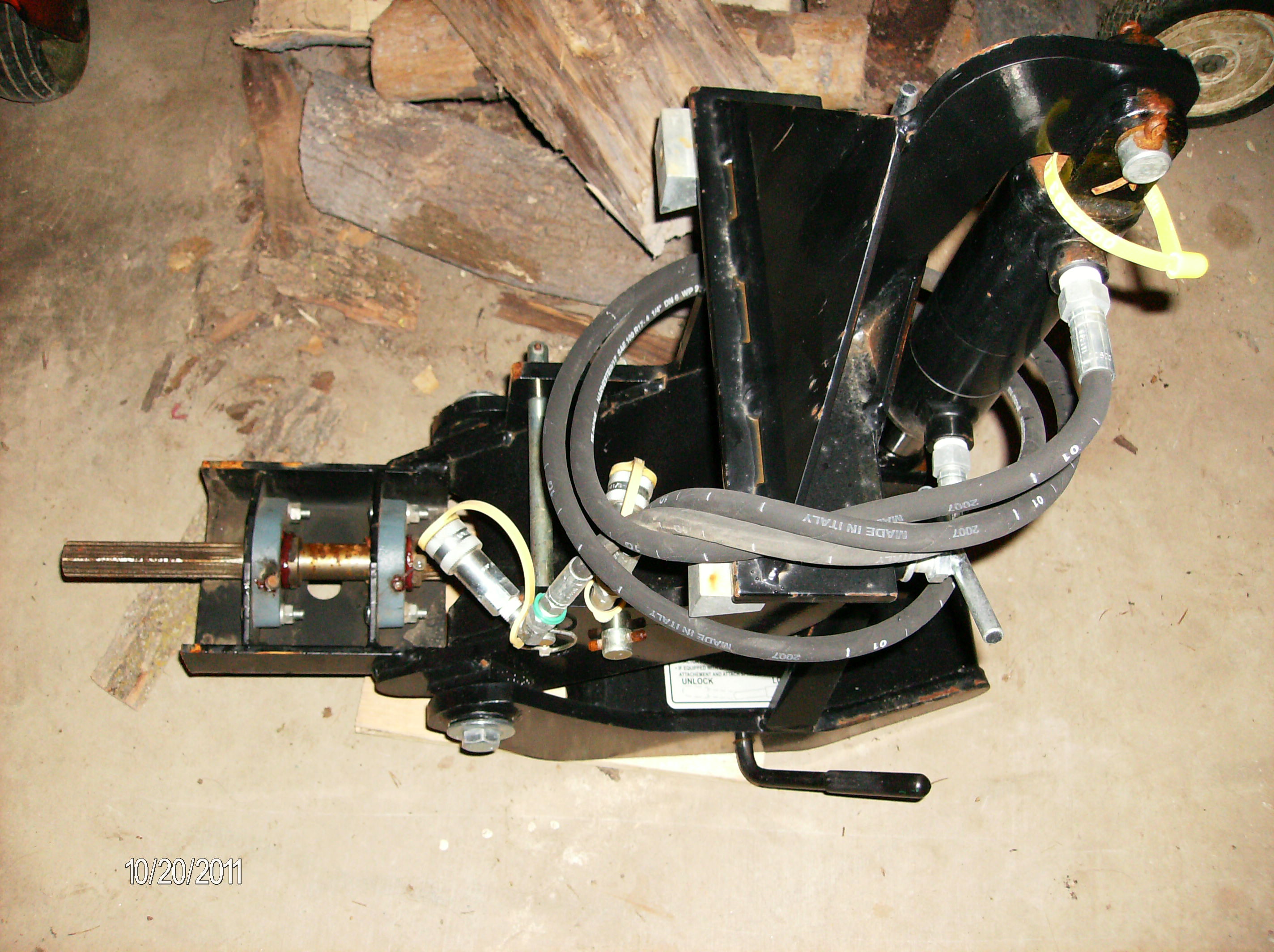

Hi. I've been shopping for a new BX tractor, and stumbled on a used BX2751 quick hitch and mid PTO kit at a dealer. The price was good (500) as the unit looks like new. Can anyone tell me if the mid pto kit is a BX2752 or a BX2753. I've got my sights set on a BX1860.
Thanks

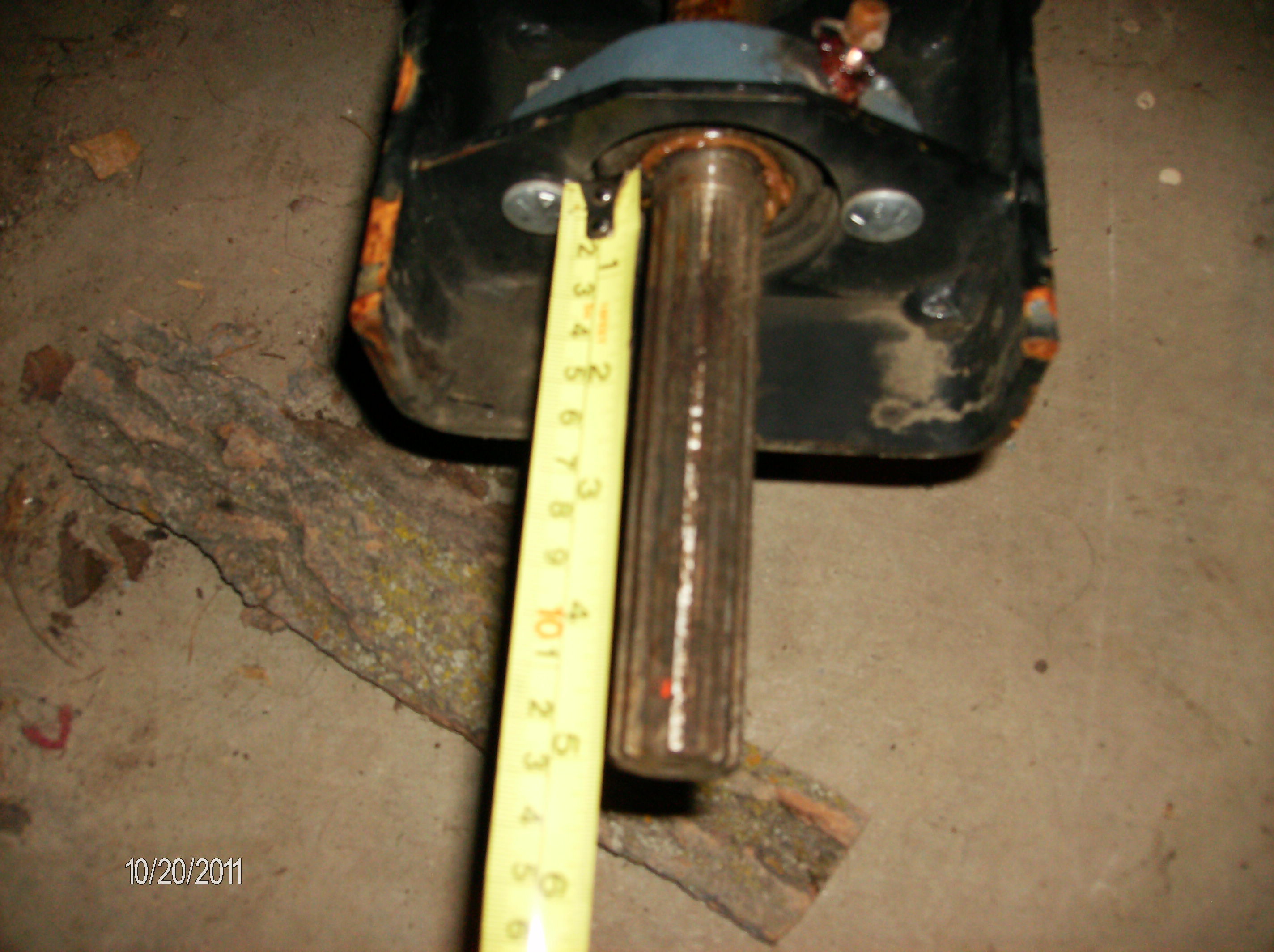

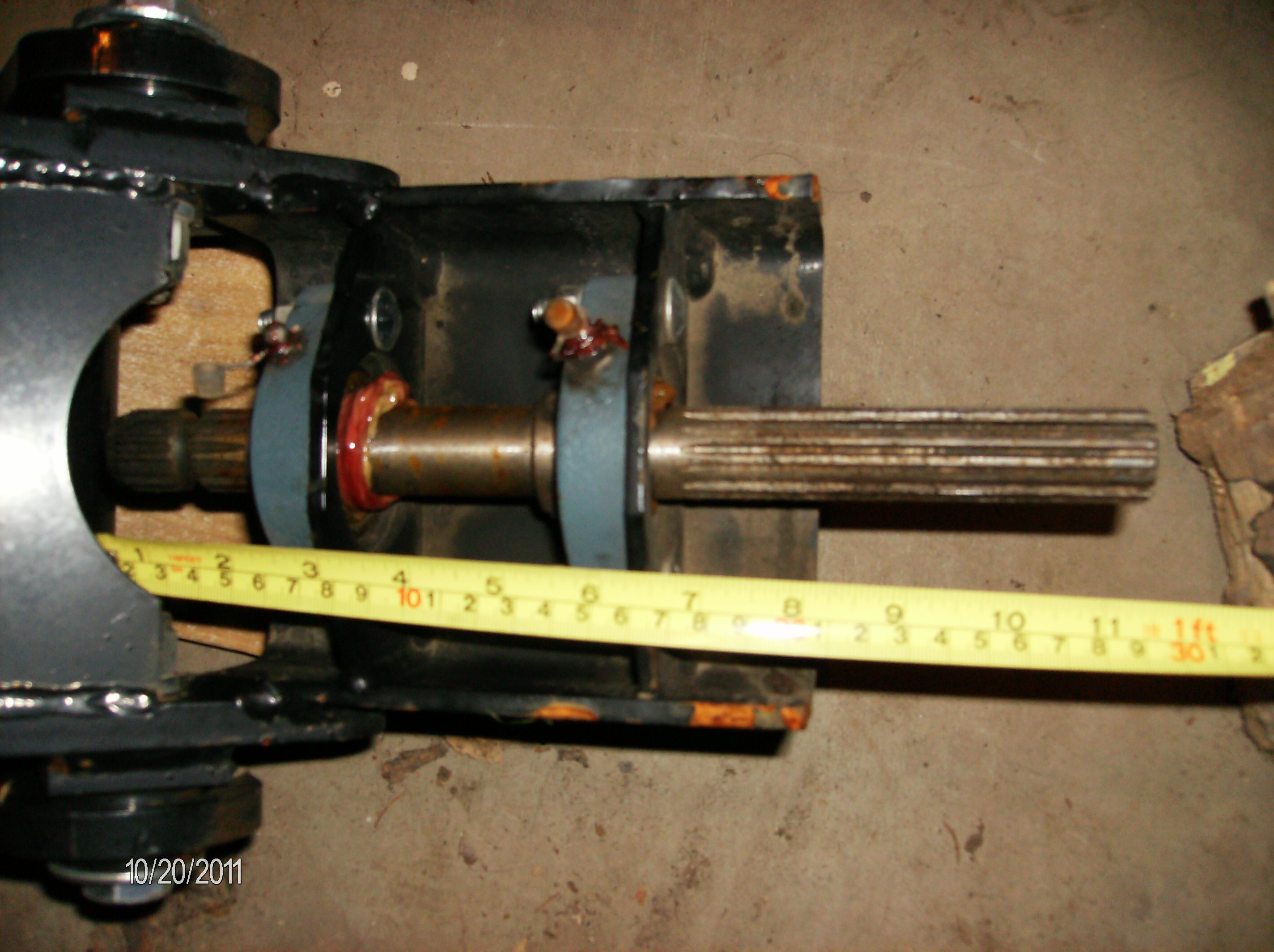

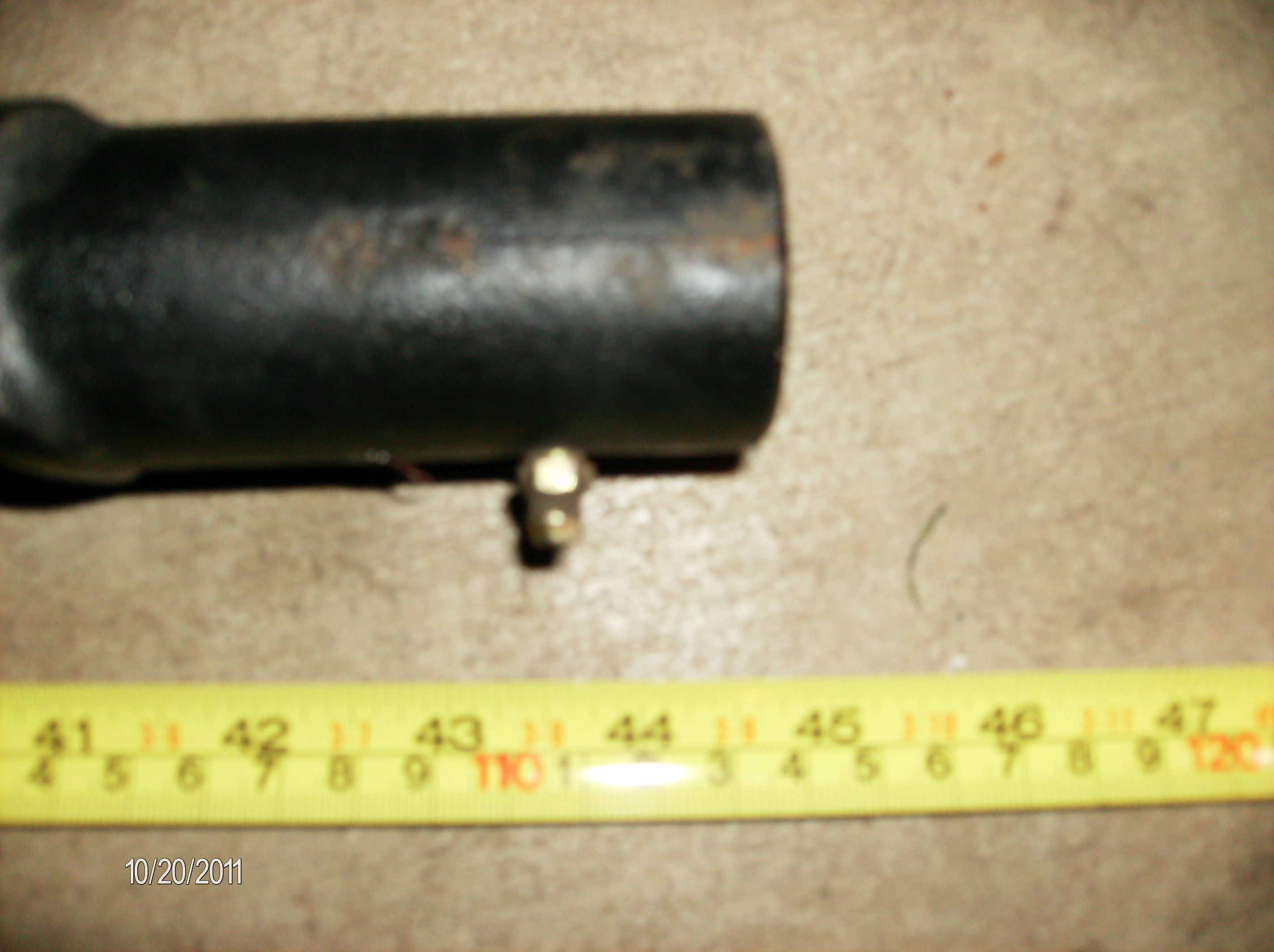

I've attached a couple more pictures. I'm not sure if the difference in the two pto kits is the length of the splined shaft in the support bearings, or is it the length of the driveshaft? Anyone have an installation manual?

The BX2752 kit will fit the BX1860, the BX2753 kit will fit the BX2360, BX2660, BX25. I don't know the difference between the two kits though.
   / Identifying bx pto kit #4
The bx2752 has a 11 1/2" output shaft and the bx2753 has a 14 7/8" output shaft on the quick hitch frame. The drive line going to the mid pto has the same part number for both.
Thanks for the info. Looks like I've got the correct hitch for the BX1860.
