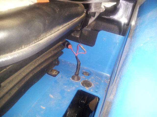

It's on the left side between the seat & fender... I'm looking for a spot to mount a 12v outlet, was going to run a wire, but figured I'd use this if was a power lead.
Thoughts?
   / Identify this wiring harness: #2
Not sure, but that could well be the seat safety switch. If so, I'd pass on that one. Might affect ability to complete ignition circuit.
I'd look for the wires going to the rear light or rear receptacle.

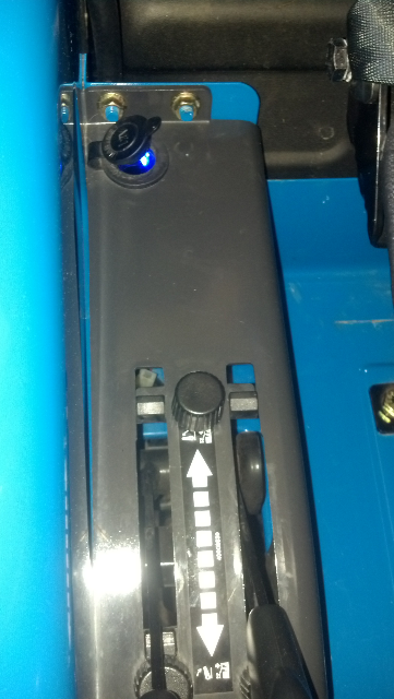

Here is where I put mine.. mostly used as phone charger. Has blue LED inside socket.. matches tractor nicely.

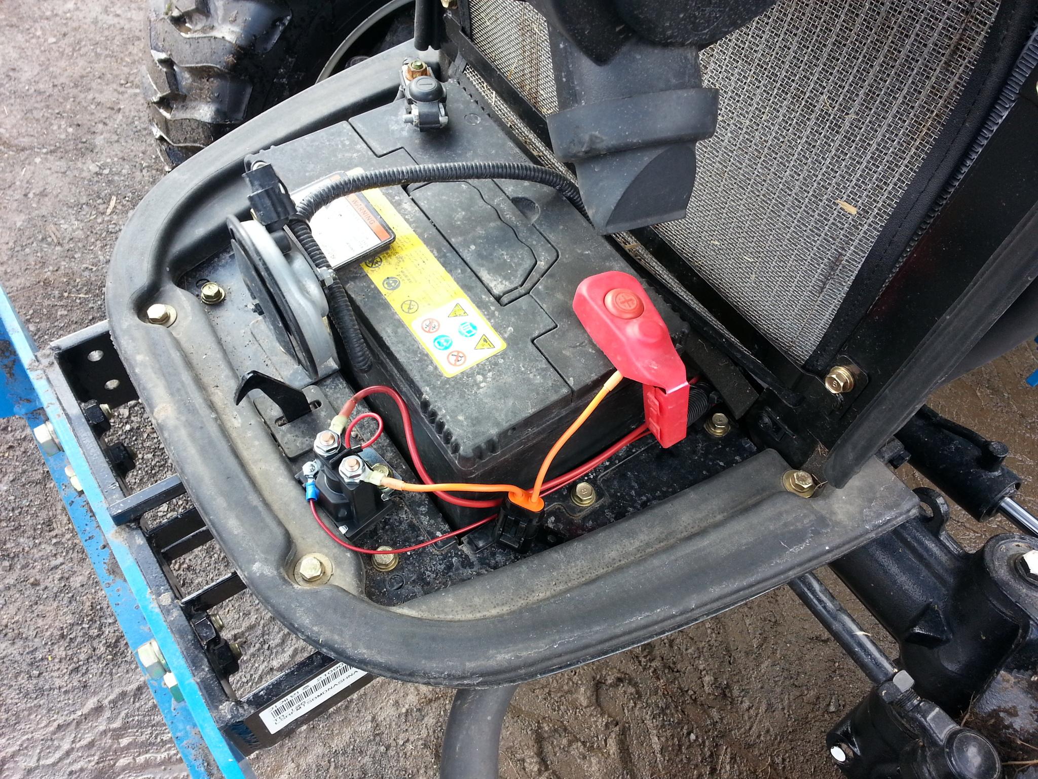

If you look in my R3039 Mods thread, you will see how I am powering aux wiring. Basically I have a snowplow type solenoid under the hood by the battery. That is controlled via a wire from the key. I have a 30 amp fuse between the battery and solenoid. I then have a 6 outlet fusebox under the dash that has power coming from the solenoid. This gives me 6 key controlled circuits to work with, using the same fuses as the tractor. (guess I only have one pic from the project...)
