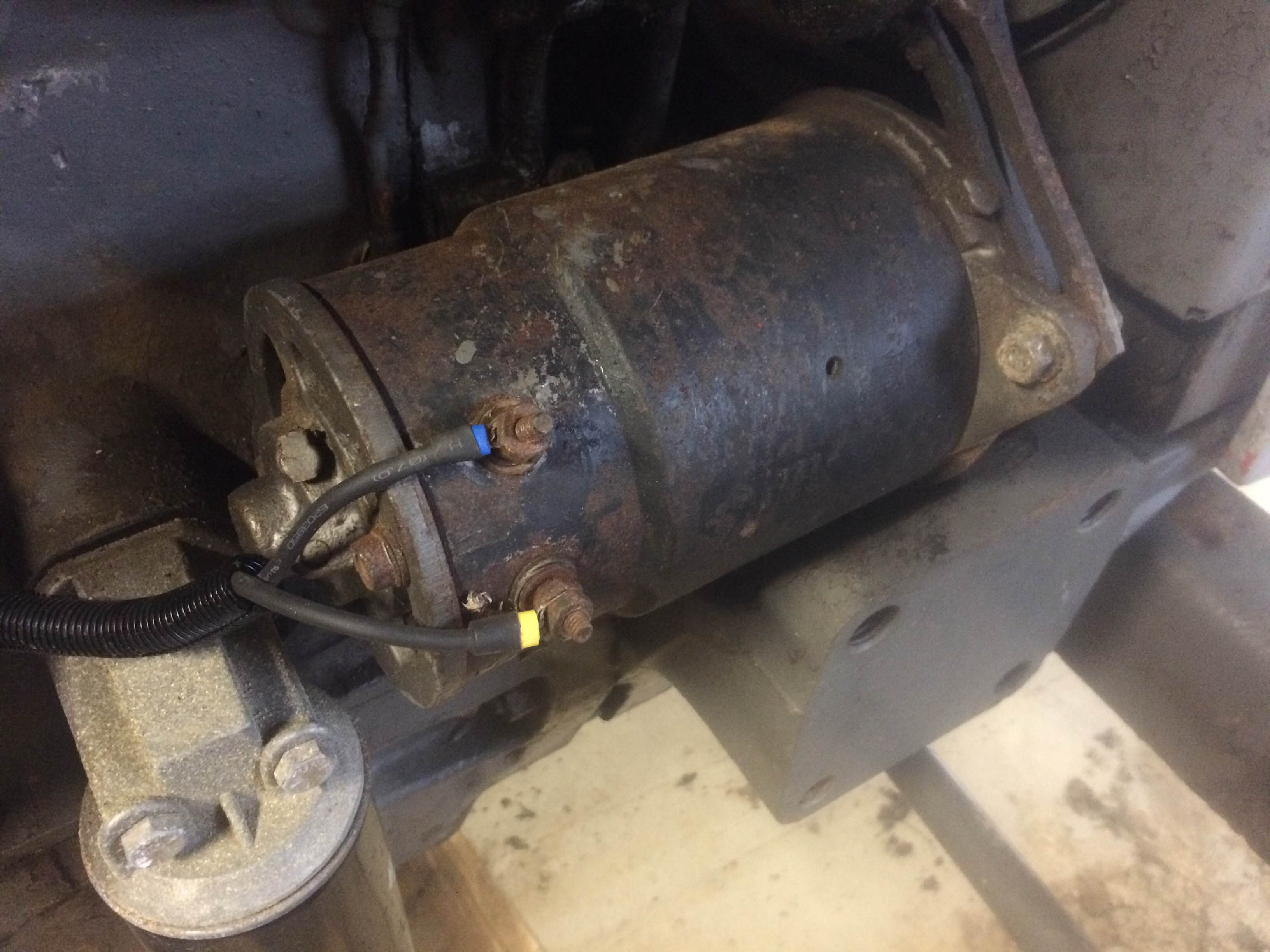

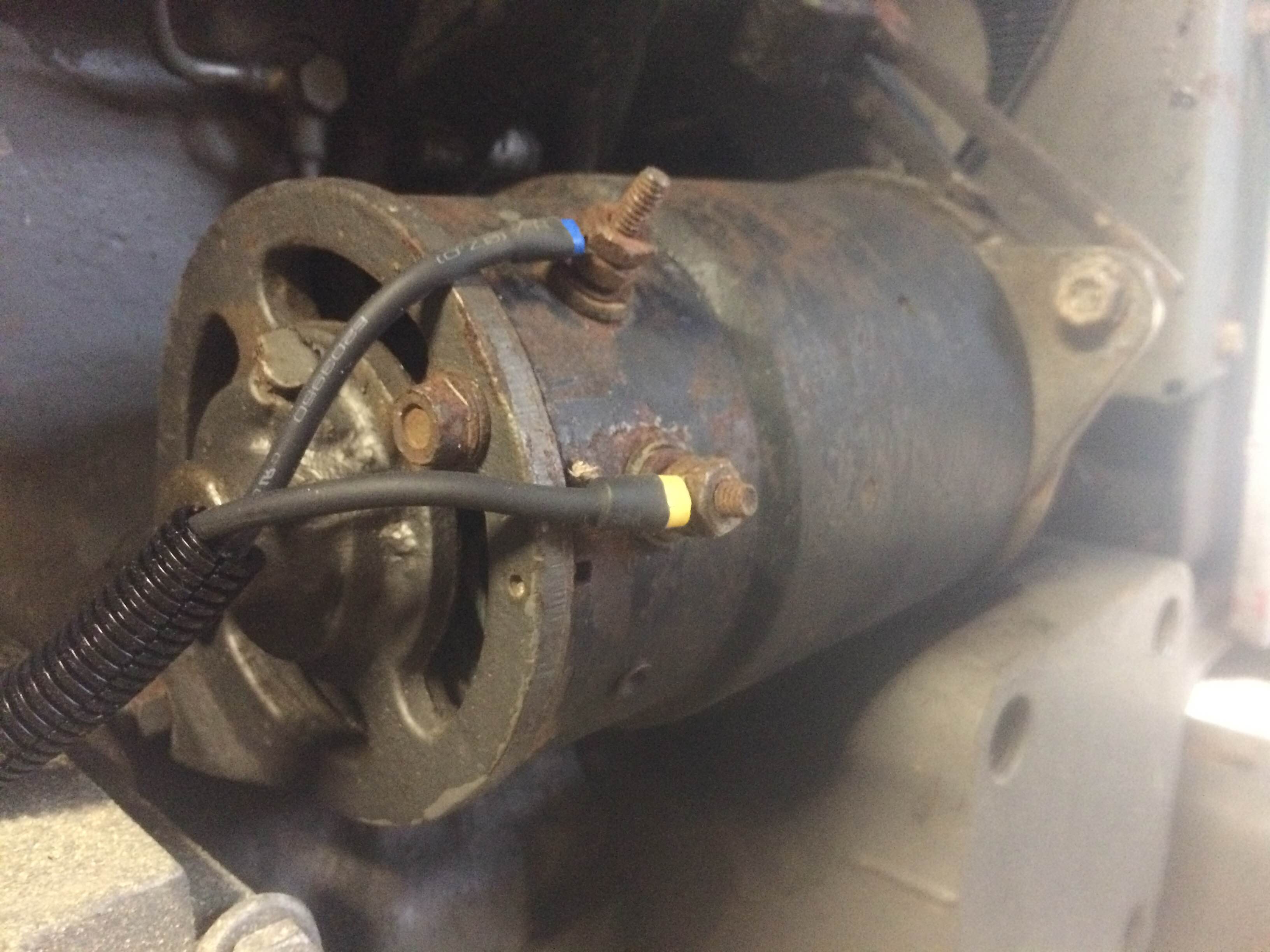

My generator on my Massey 165 Diesel quit working. I already have a new voltage regulator and I have rewired the tractor. I read that there two type of generators on the old 165's. Mine is a 1969 with the Perkins Diesel.
I am attaching two pics of the generator. Can anyone tell me if it's a Delco or a Lucas?
Thanks,

Its been a long time but I'd say its a Delco . The Lucas had casting fins on inside of mounting brackets.
1 st pic Delco / 2 nd pic Lucas Hope it helps Ya ! Not 100% sure .

I was thinking it was a delco also based on where the wiring connects.

Thanks for the Pittsburgh info. I just bought a 1 wire 63 amp alternator and a universal mounting bracket kit.
