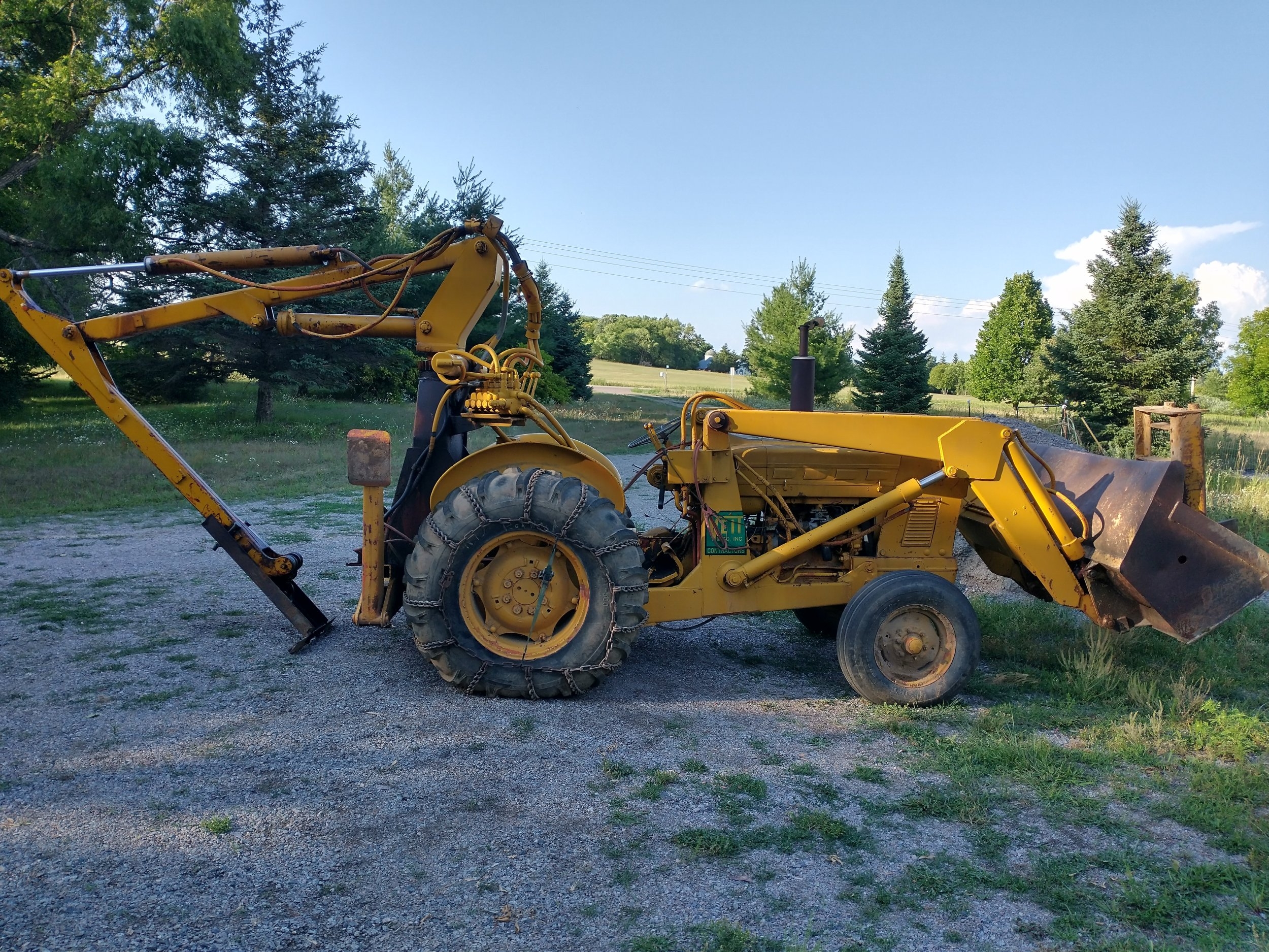

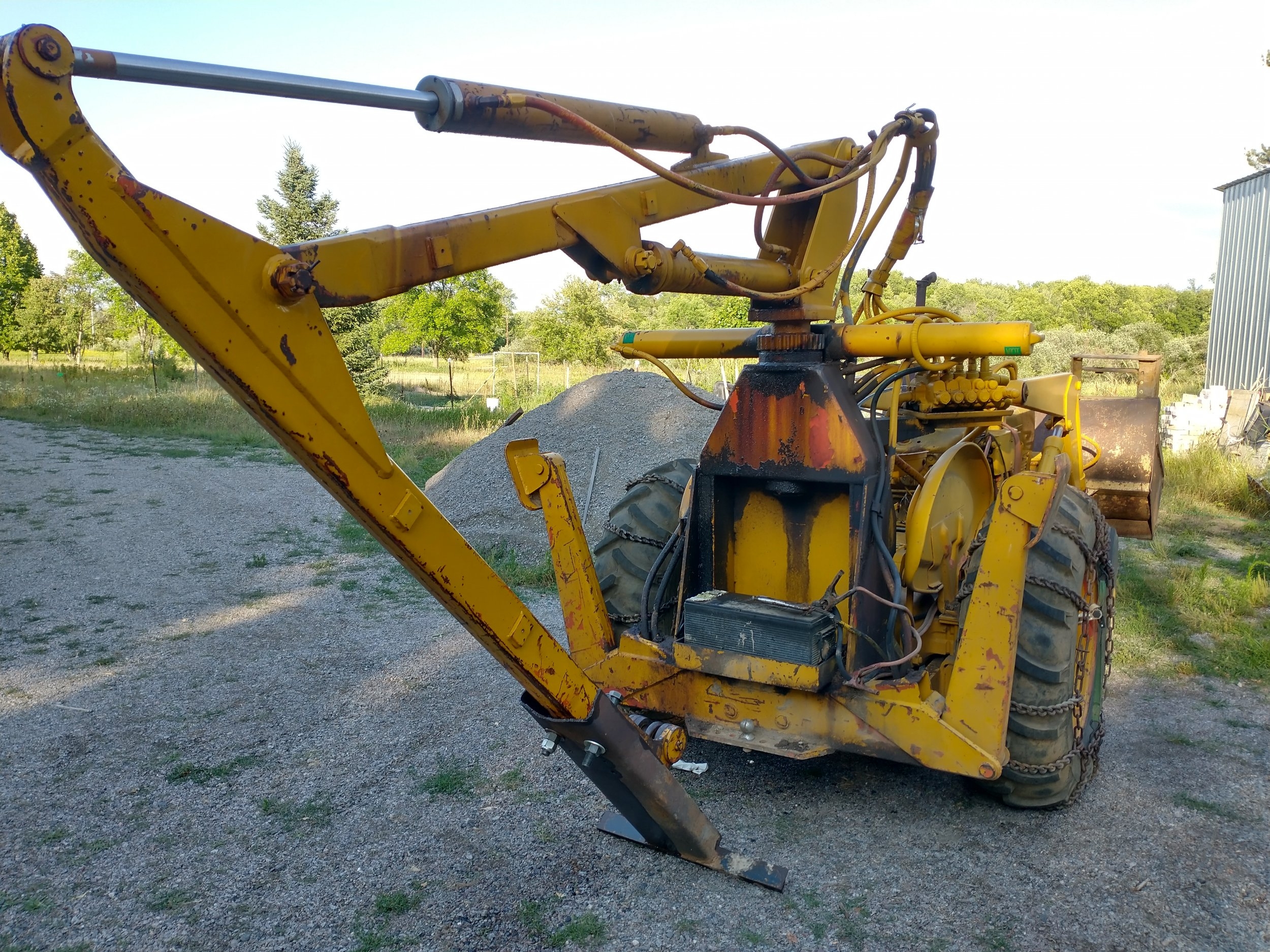

I will need a manual for this Ford industrial. It is possibly a 1960's series. Possibly a 4500. it has a Ford T9420 loader on the front, and a strange rear attachment. What I read under the starter are - 45021E, and underneath that # 61187603L1 (I think) Images attached.
   / Identify Industrial Ford, and attachment #2
   / Identify Industrial Ford, and attachment #3
45021E: 1965-1968, 4=4000 series, 50=Industrial, 2=Gas, 1=No PTO, E=Select-O-Speed.
I have not seen that unit on the back before.
