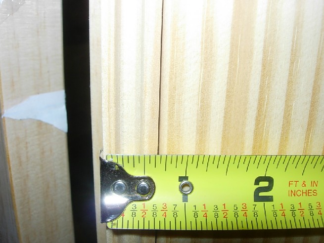

When house was built, we moved in and left basement unfinished. We've started working down there.
This is the back bathroom. All framing was done when house was first built. Doorway is 38 3/8" wide. Went to buy some doors and gave them dimensions. On the package of door itself, it says rough in opening is 38"
All of this however, is BEFORE anyone thought about the T-astricle thing (sp?) The piece mounted between the doors to help them close. Seems this adds some width that is NOT accounted for on the rough in paperwork.
The door itself is 38 1/2" wide so my door opening is a fraction too narrow. This is a load bearing wall by the way.
Can I take a plane and shave part of the 2x4's? As for load bearing, I don't think a single 2x4 is going to affect what's above, it is only holding the floor above and nothing above that. There is enough support under here that if I took a single 2x4 out I'd not feel too nervous (since I know there are SEVERAL at this junction)
Regardless of any of that...had the T-astricle thingy NOT been installed, we'd have plenty of room (and I've no idea why it's there nor since it IS there, why their rough in numbers didn't account for it)
Seems I gotta do something and would love to have some ideas.

Update: I've taken one of the studs (jackpost?? I thought those were metal?) out.
So far, I've planed it down to about 1" thick and just now tried it. Although the door DOES now fit inside the opening, it's a very snug fit and frankly, it's still a bit tight. Back down to plane some more!
Came up to nab camera for later use :rolleyes: and update.
Going to shave more off and go at it again. Since the door now fits, I'm getting CLOSE, just a matter now if fine tuning.
This thing has created a freaking TON of shavings!!
:eek:
PS: on the attached picture, we just slapped the base/sink in place to get a visual. No tile on floor yet, shower (wall on right in this pic) is not done... it's coming together though.

RonMar: It is prehung however, they did not account for the addition of the middle part. The door was specifically chosen by the wife so as you might imagine…it’s up to me to make it work and not return it.
I removed about 1/2” from a single stud. Wall has drywall on both sides so I had to be careful removing it but I got it out. I currently have the door temporarily screwed in pending the wife coming home from work and wanting it hung like I have it. If all is ok by her (mainly do I need to raise it a fraction or two to gain room under it for pending floor tile)
Anyways, if it is ok, then I’ll remove it again and nail that side stud and reinstall everything.
I WOULD have replaced it with a 1x4 but I don’t have one, I’m 18 miles outside of town and a 1x4 would have meant more shims. As it is… I’ll only need a touch of shims since the door is shaved down to about 1” thick.
The wall has something like three or four studs nailed together right at this junction so although I don’t really WANT to reduce any of the support, I’m more at ease replacing it with a solid 1” stud than a ¾ thick ‘stud’ (1x4).
RonMar: I would have NEVER thought of shaving the stud with a skilsaw!! I’ll have to stick that one in the memory banks for (probable) future use.
