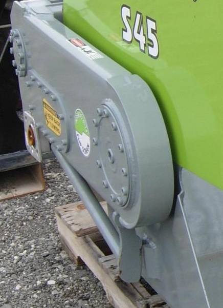

Those stop rods on sides of the rotating screen buckets appear to be pivoted out of the way by a cam on the back edge of the stop when rotating in one direction. In the reverse direction, the stop hits the end of the rod to hold it in the digging position.

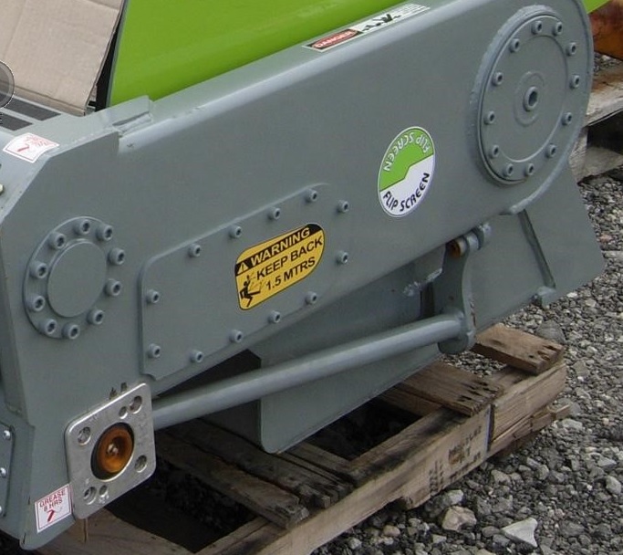

Take a look at the pictures below I took from one listed on line for sale. The first shot shows the stop rod from the side. There is a pivot up front and I suspect a spring loaded ball pivot in the back (left side of picture). The stop rod is not fully engaged in the stop. The second picture show the ramp side of the stop that will cam the stop bar out of the way when rotating in the sifting direction. You can see the stop rod is sitting up on top of the stop which is welded to the side of the bucket. When the bucket rotation is reversed, the stop rod will spring into the side of the bucket and catch on the flat face of the stop.

Thank you so much for that information. I don't know why they need that rod. It almost sugggests some sort of control over the ratcheting mechanism engaging or disengaging. I was wondering if this thing just ratcheted in normal one way rotation. You would think they could just do this internally on each side without that rod.???
It does seem to be a very well built item.

The rod appears to prevent the bucket from rotating backwards when loading rather than relying on the hydraulic motors. Makes sense since it removes all loading stress from the drive motors, etc which would be the big dollar items to repair/replace. The stress on the components from just rotating the unit while screening can be calculated but the force the bucket sees during loading could easily be more than the hydraulic drive components for rotating can handle.

There is a wedge actually weled onto the outside plate of the bucket that engages the pawl attached to the aforementioned rod. It is much more crude then I had expected, which is good, but leaves me still confused. It looks like that rod takes all the digging force lengthwise, and also the pawl seems to somehow move out of the way, so the bucket doesn't in fact ratchet every time is comes around.
