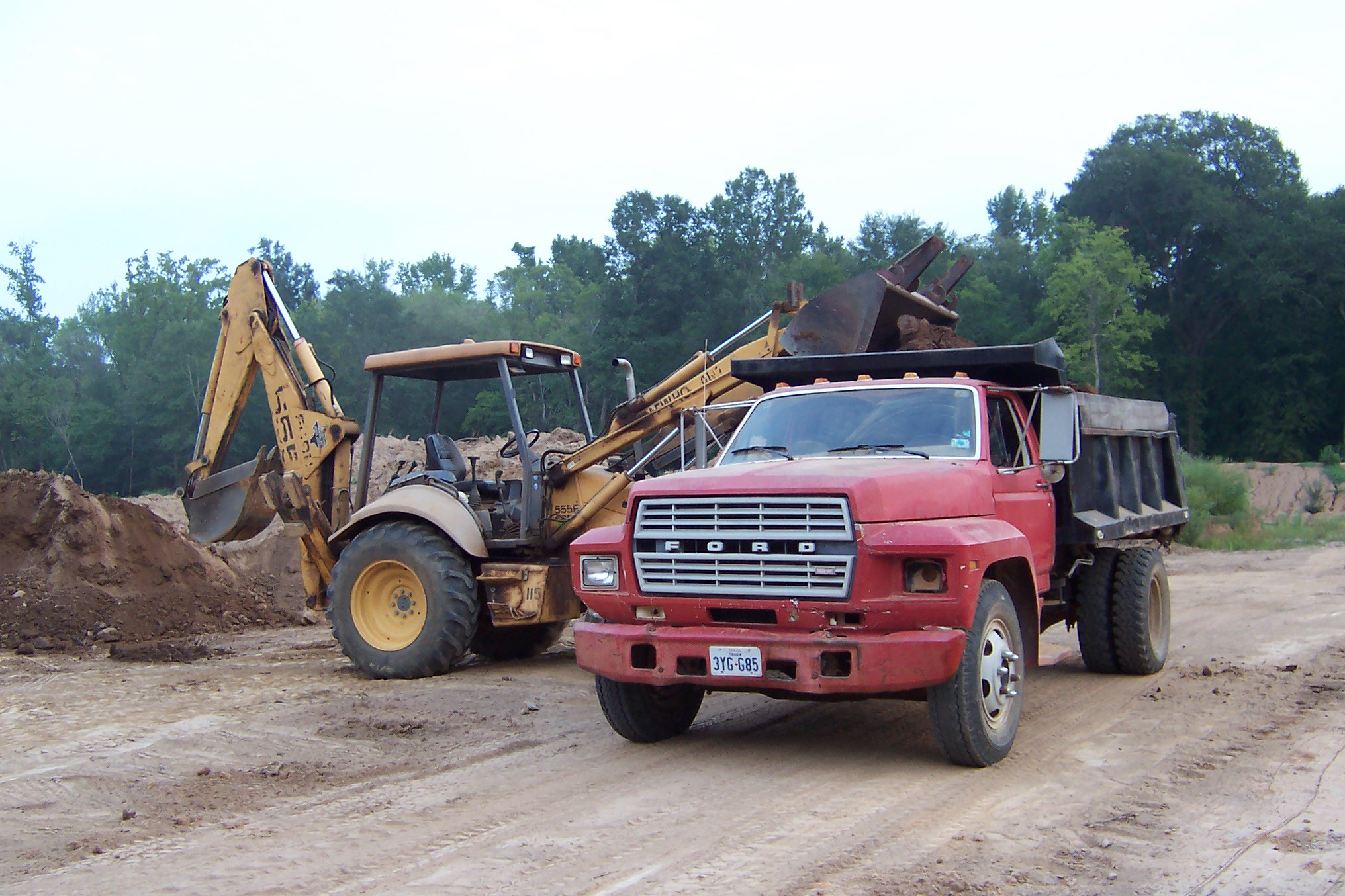

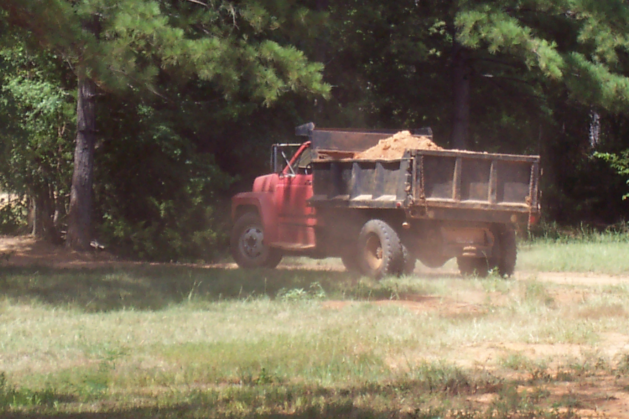

Dozer is great for spreading material. Horrible at moving material. You need tires to move material. Depending on your budget, and what you already have, a dump truck or dump trailer or pull behind scraper. All have their pros and cons, but they also will move more dirt faster and cheaper then anything on tracks. I bought a used and abused 5 yard dump truck for my place that worked great, but it was always a battle to keep it running. Bigger would of been better, but I didn't want to spend the money, and I also had concerns about getting a ten wheel dump truck in and around where I need to put the dirt. Mine is a Ford F600 gas engine that cost $3,500 My neighbor just bought a dump trailer for his place that he pulls with his 80 hp tractor and loads with his backhoe. He has moved a lot of dirt with it, but it takes two tractors to be effective. I like my dump truck better then his dump trailer, but that's just me.
