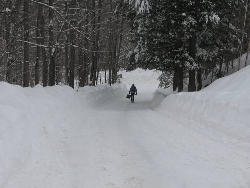

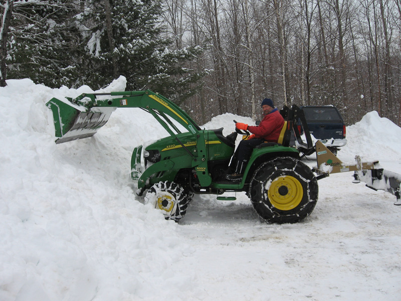

We have a 650' gravel driveway in central NH, switch back half way with the upper section steep, see 2nd photo. I have a plow truck that I use to plow from top down. The tractor with FEL and backblade is used for clean-up and moving the piles back.
If I had to I could do the whole job with the tractor but the plow truck is much faster. However if we had been away and there was 2+ feet of snow to deal with, the plow truck would probably get stuck. I would then resort to the tractor with FEL, a slow process but it would work. No blower experience but I think that a rear mount blower would also be the slow but sure solution.
Note that the tractor has chains on 4 wheels (as did my plow truck that day). Dealing with deep snow or ice on a steep driveway calls for chains. Ice is the real killer, that is why chains on all four. I keep a supply of sand mixed with salt at the top. Many 5 gal buckets are stored in the garage. Dump a few buckets in the FEL; get the wife to drive the tractor slow and I spread sand on the steep parts with a shovel.
