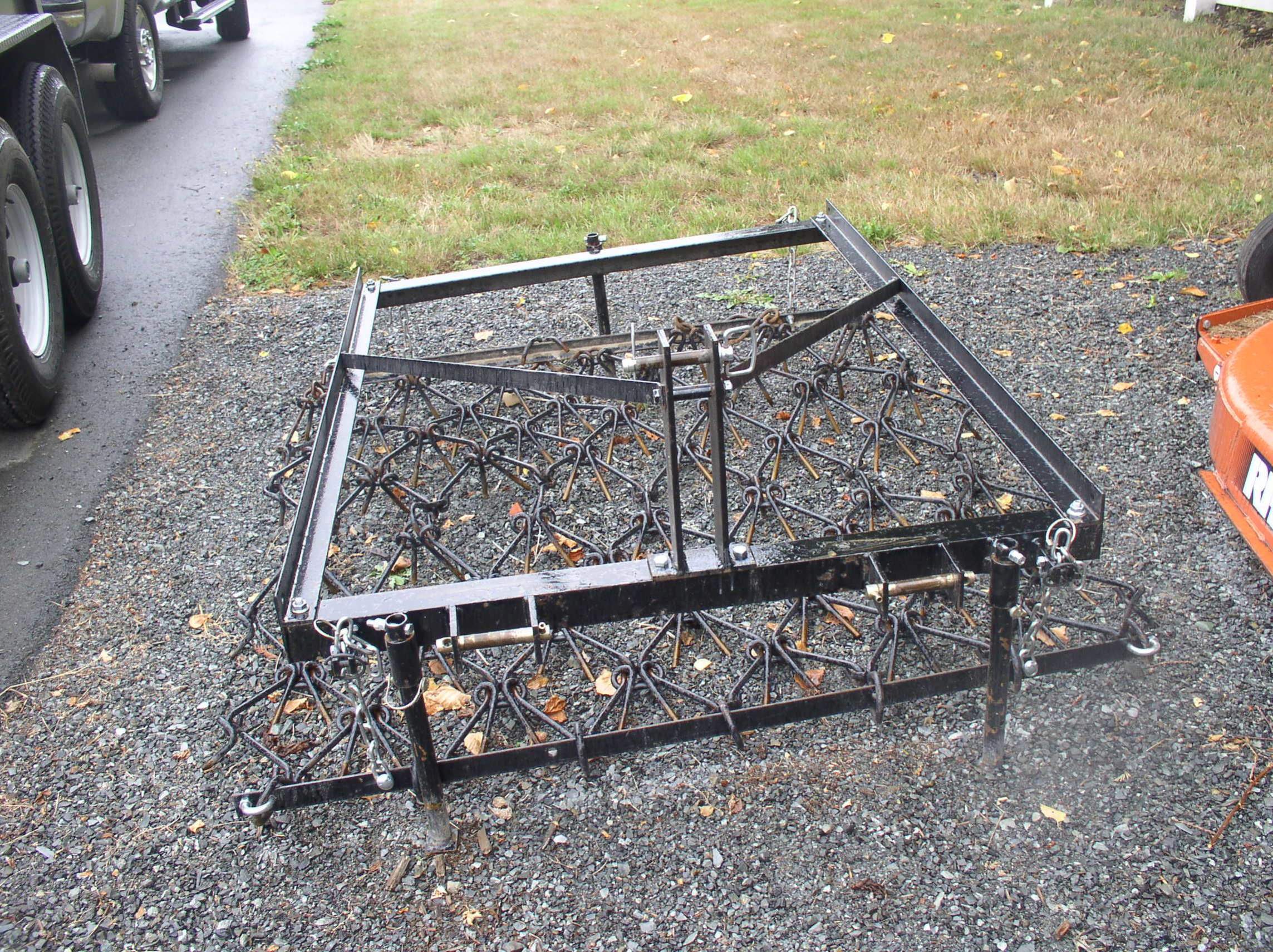

I think you are on the right track. My harrow, used primarily for arena grooming, is on a 3 pt frame. The harrow hangs below the frame on 4 chains. When in use, it rests on the ground pulled along by the chains. When raise the 3PH the chains lift the harrow off the ground.
In my opinion your frame will be stiffer than mine, which is too flexy.
The chains slide into hangers on the frame so you can adjust the height. I think you will want to do that.

Actually, I did not look at your drawing closely enough. With the green chains, yours may not be as rigid as you might want. The problem with mine is that, when suspended, the rear flexes and the support braces flex. You are starting with a stronger structure (the carryall) but your "H" will be hanging off the back quite a bit.
I still like your idea.

I don't think replacing the chains as placed will help that much. You may want to build in some triangles at the rear of the structure. And, I like the idea of vertical flex in your structure. It might avoid some damage if you back into a post for example. (It may not, too)
It is the torsional flex that I have and don't like. The rear twists along the longitudinal axis.
