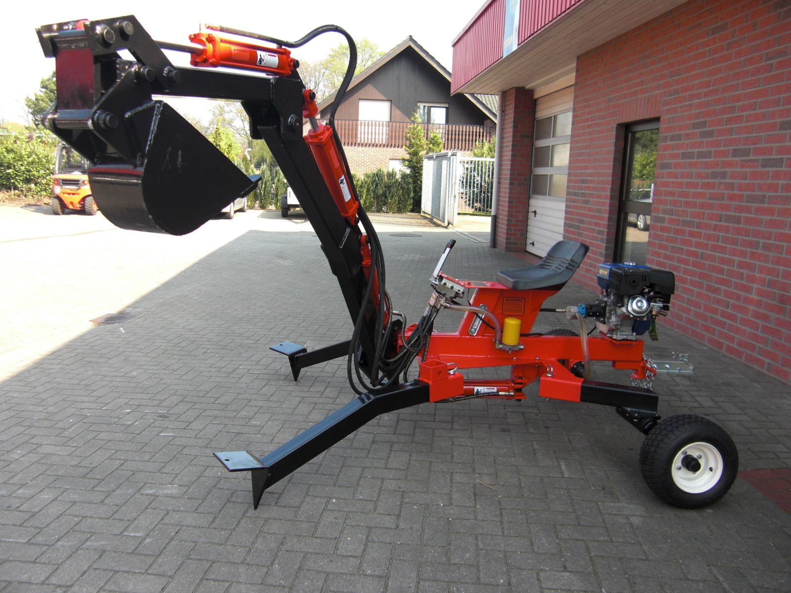

I am reading you correctly, you want to help stop the tractor rolling backwards.
on your three point frame, make a set of "spades" the when lowered and move in a reverse direction they dig in to the soil and work as an anchor, much like the towable back hoes, work that do not have out hydraulic riggers, they would not have to be spread out wide like the back hoe,
could even be a couple of heavy shafts at about 45 degree angle to the rear, so rear movement would suck them in to the earth, when one moves forward and lift up the three point they release,
Have you ever seen one of those huge wreckers pull something big out of the ditch? That's the way they work. They have these large feet that plant themselves in the ground before they start pulling.
