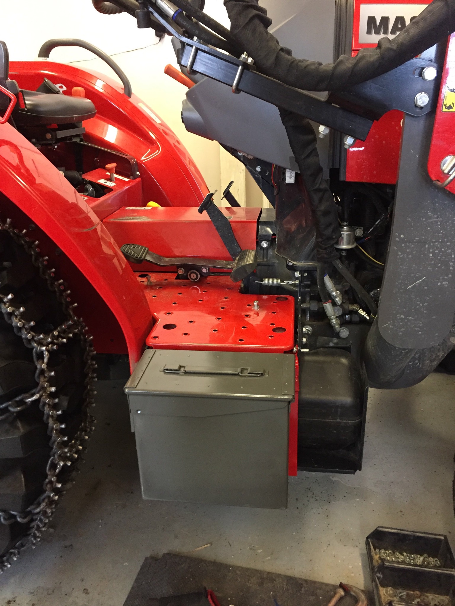

I have a Massey Ferguson 1734E (compact 34hp), it come with a small tool box near the back of the bench, but it was too small and was in conflict with the bench of my backhoe. I arrange a bigger one on a new bracket attach lower on the tractor. But now is in conflict with the snow blower. So I remove it again. I also need a place for chains and chainsaw. Is it possible to have a picture of some arrangement for toll box and chain saw holder that is original and not in conflict with different type of attachments?
Thanks for help!

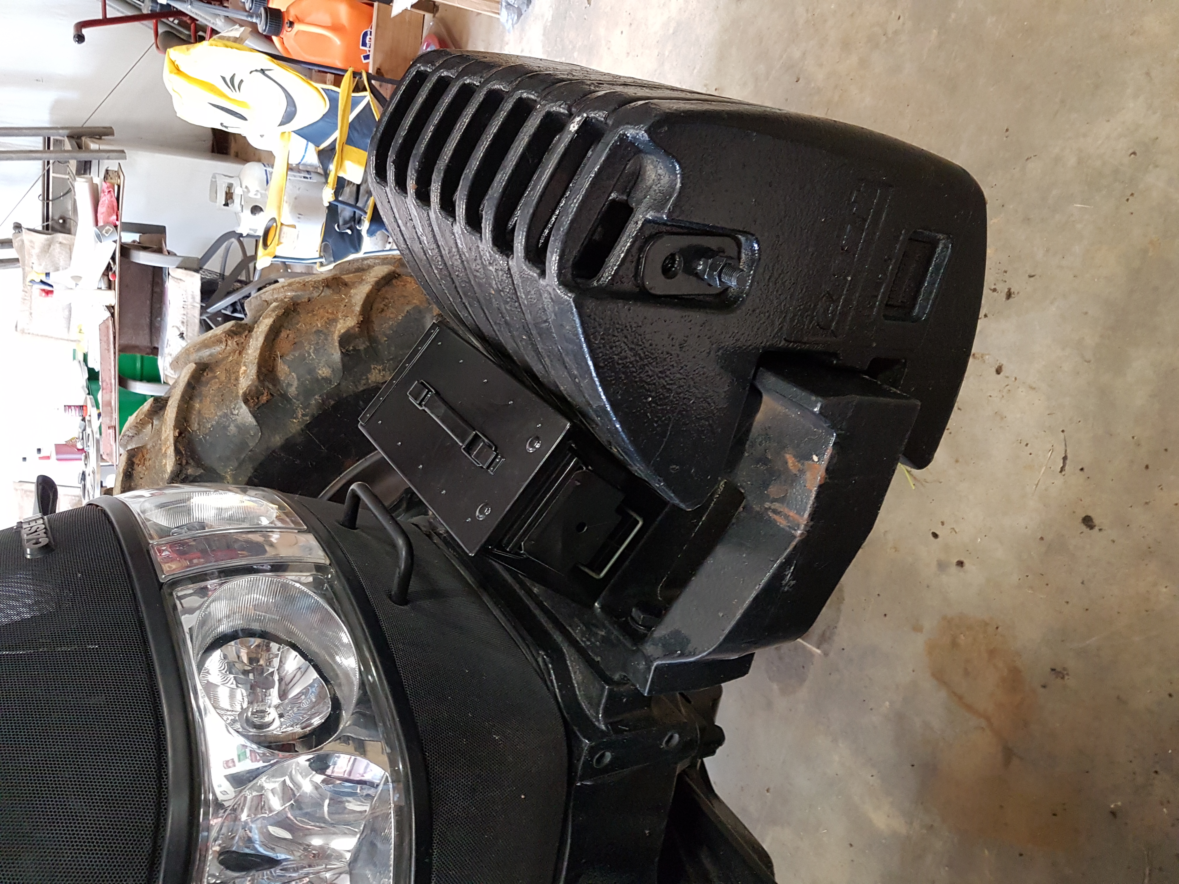

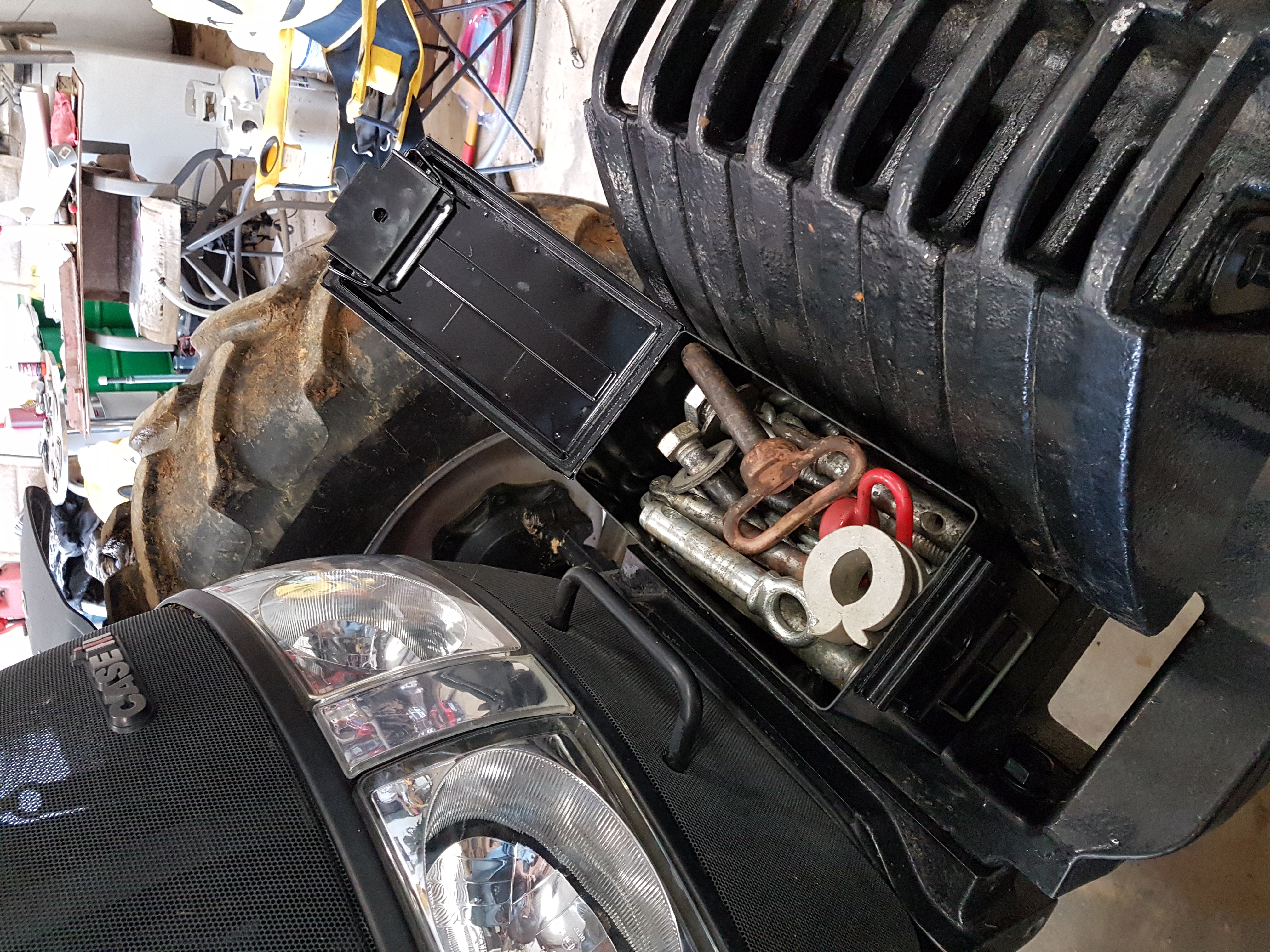

I don't have a loader, and admittedly, this is a bigger tractor, but I made a chain box out of a Harbor Freight ammo box and attached it to my front weight bracket.
Looking at pictures of your model tractor, I'd consider mounting a box on the front where the grill guard mounts.

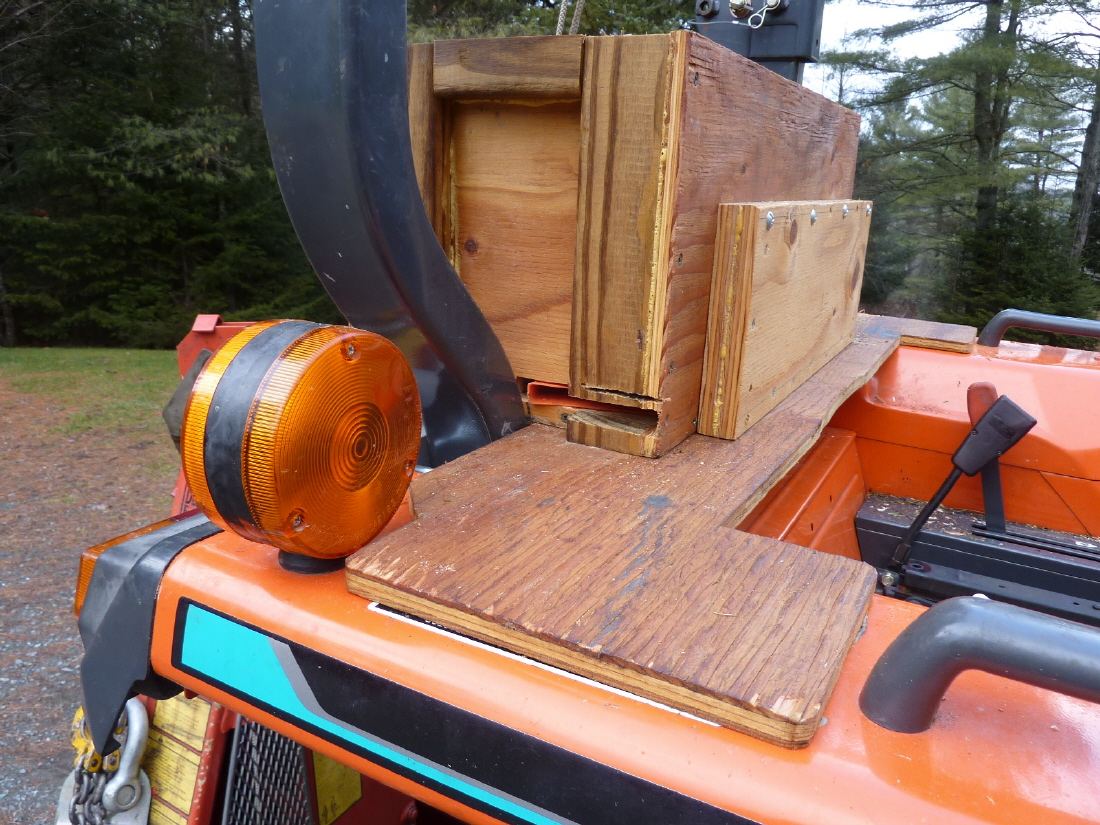

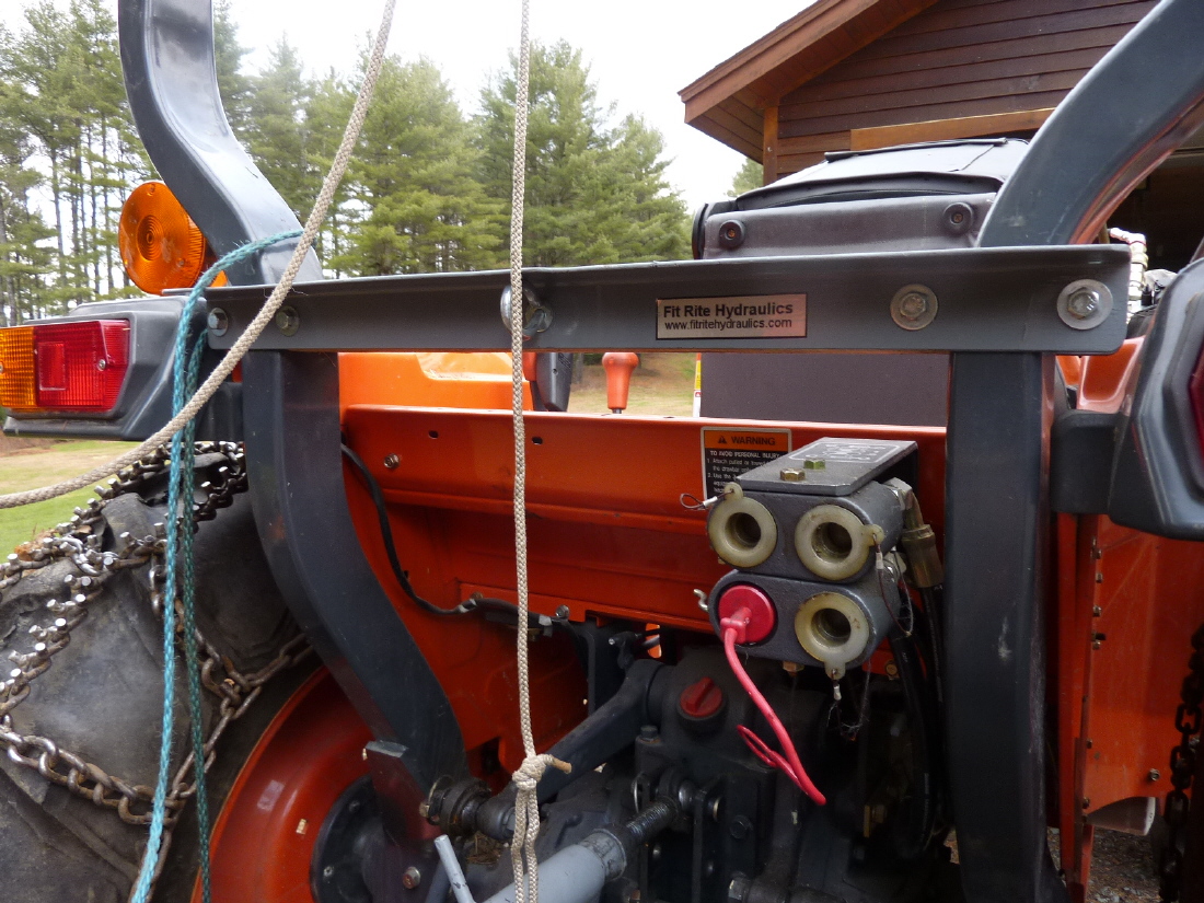

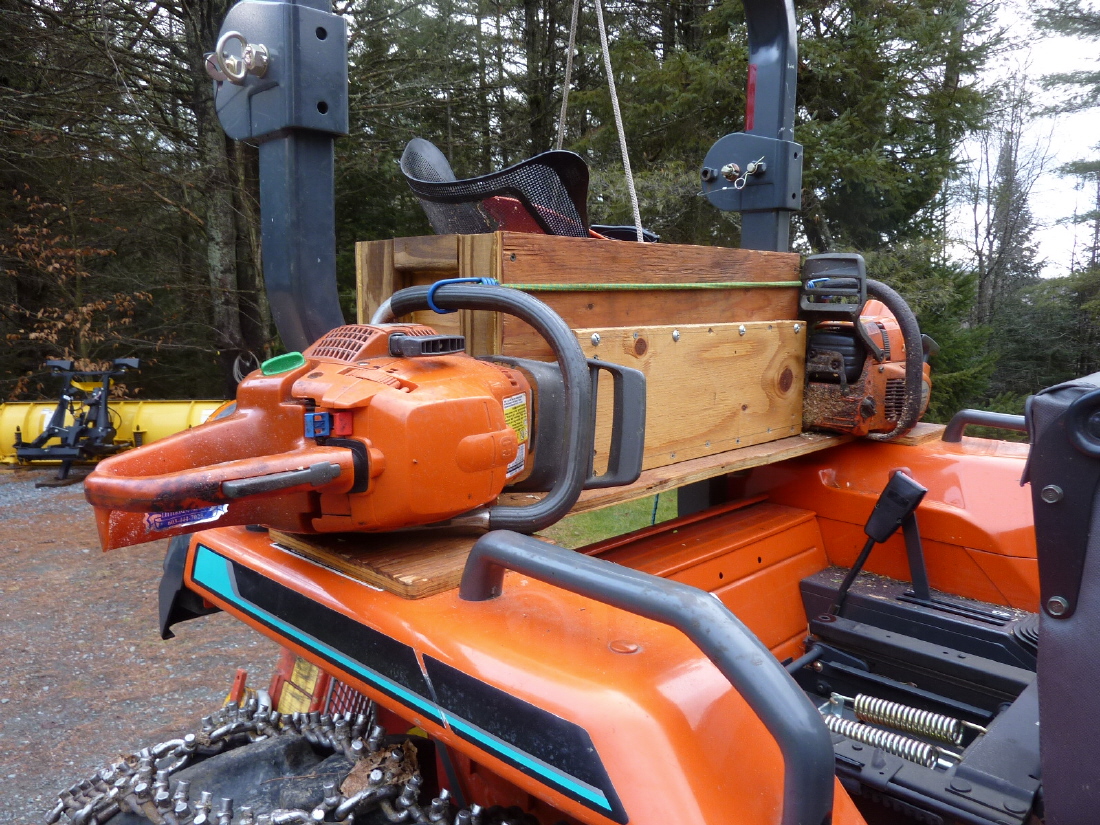

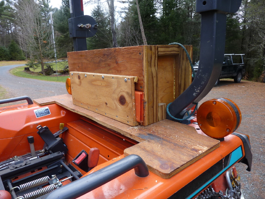

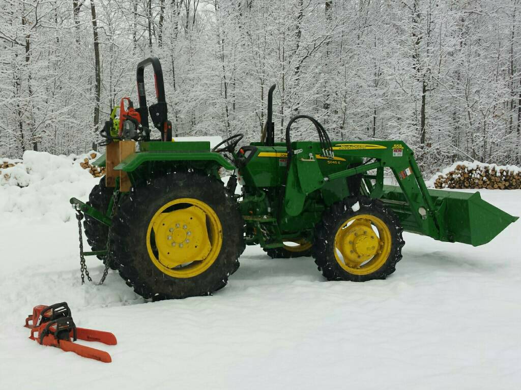

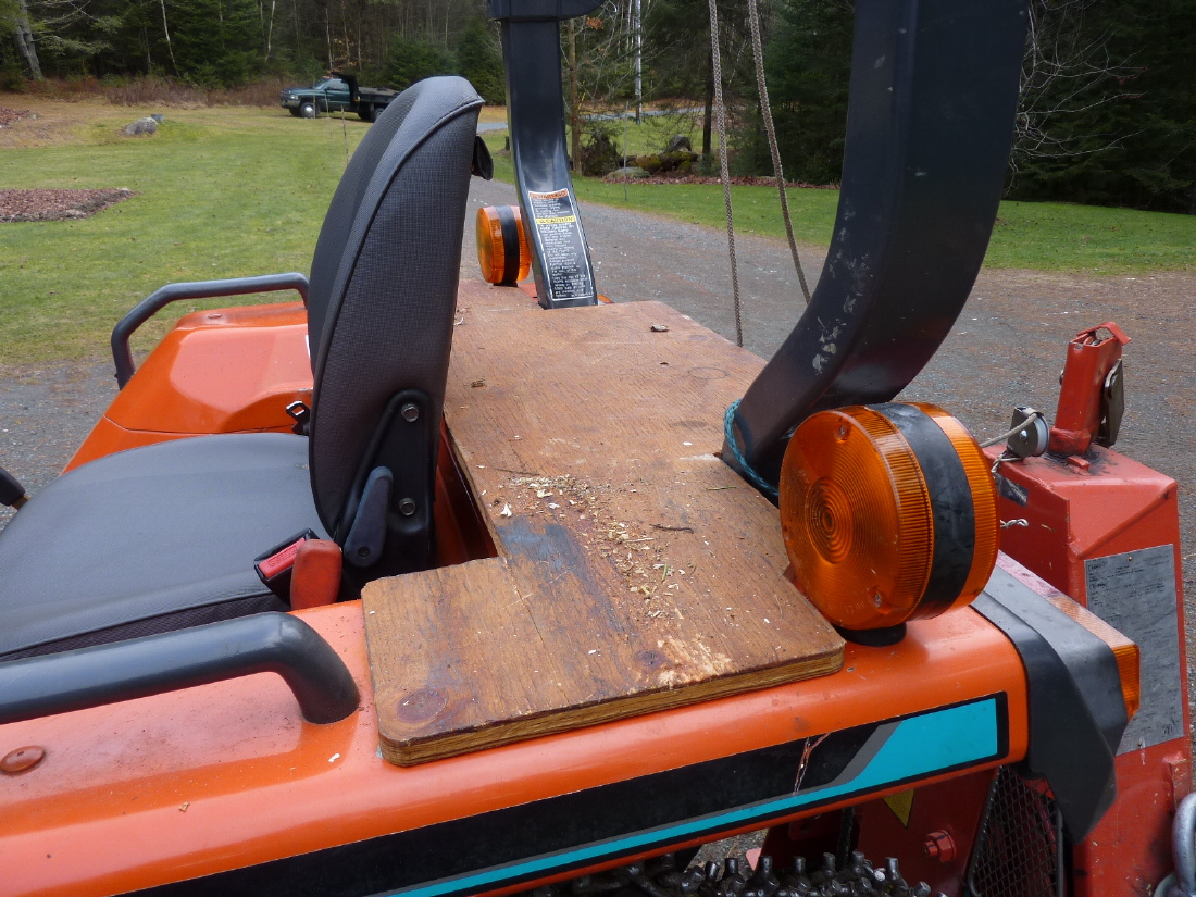

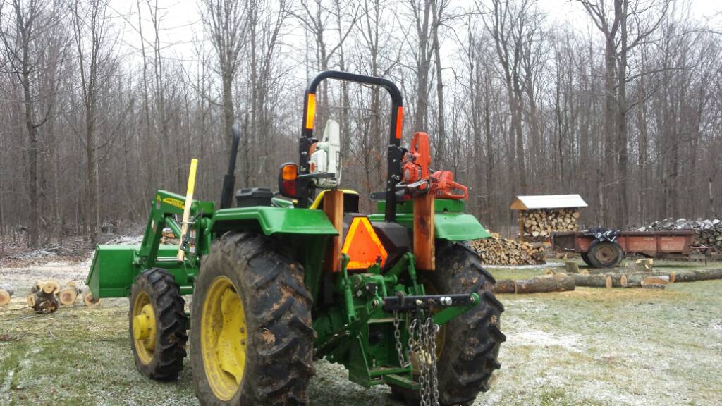

I made my saw box so I could take it off the tractor w/o the use of tools. That way I can take it off easily when it is in the way. Not the kind of box everyone wants but it may give you an idea.
Put a bracket on the rops
Added a plywood shelf shaped to lock in
Then a tool box that sets down between the rops for all my logging stuff with two saw scabbards. The seat is flipped forward to make it easier to see.
gg

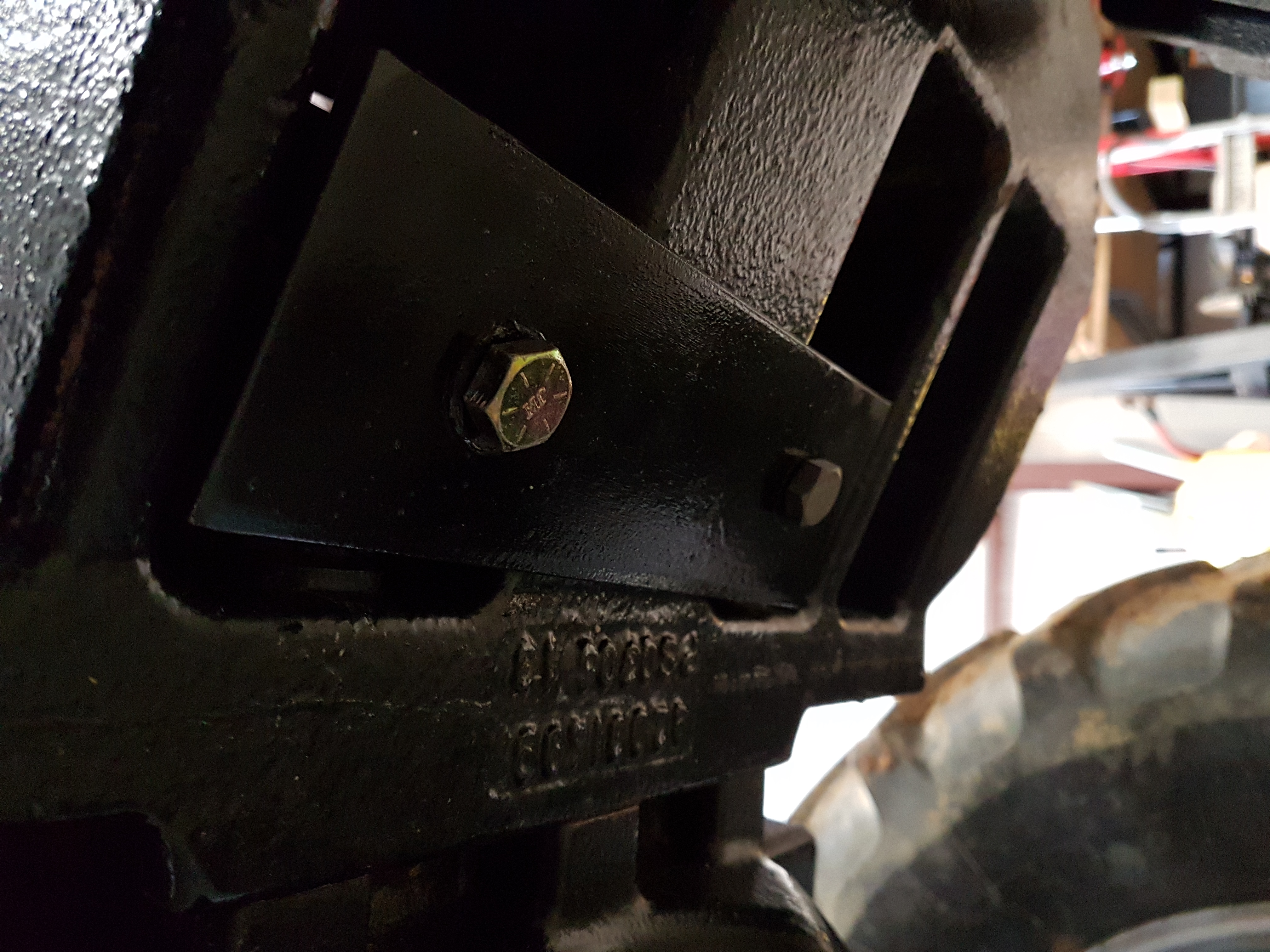

I made these quick 2 years ago for my dad, just to see how they'd work.
I still haven't redone them to make them look nice.

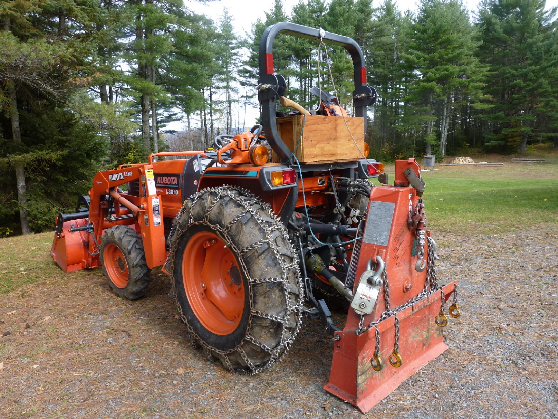

gg

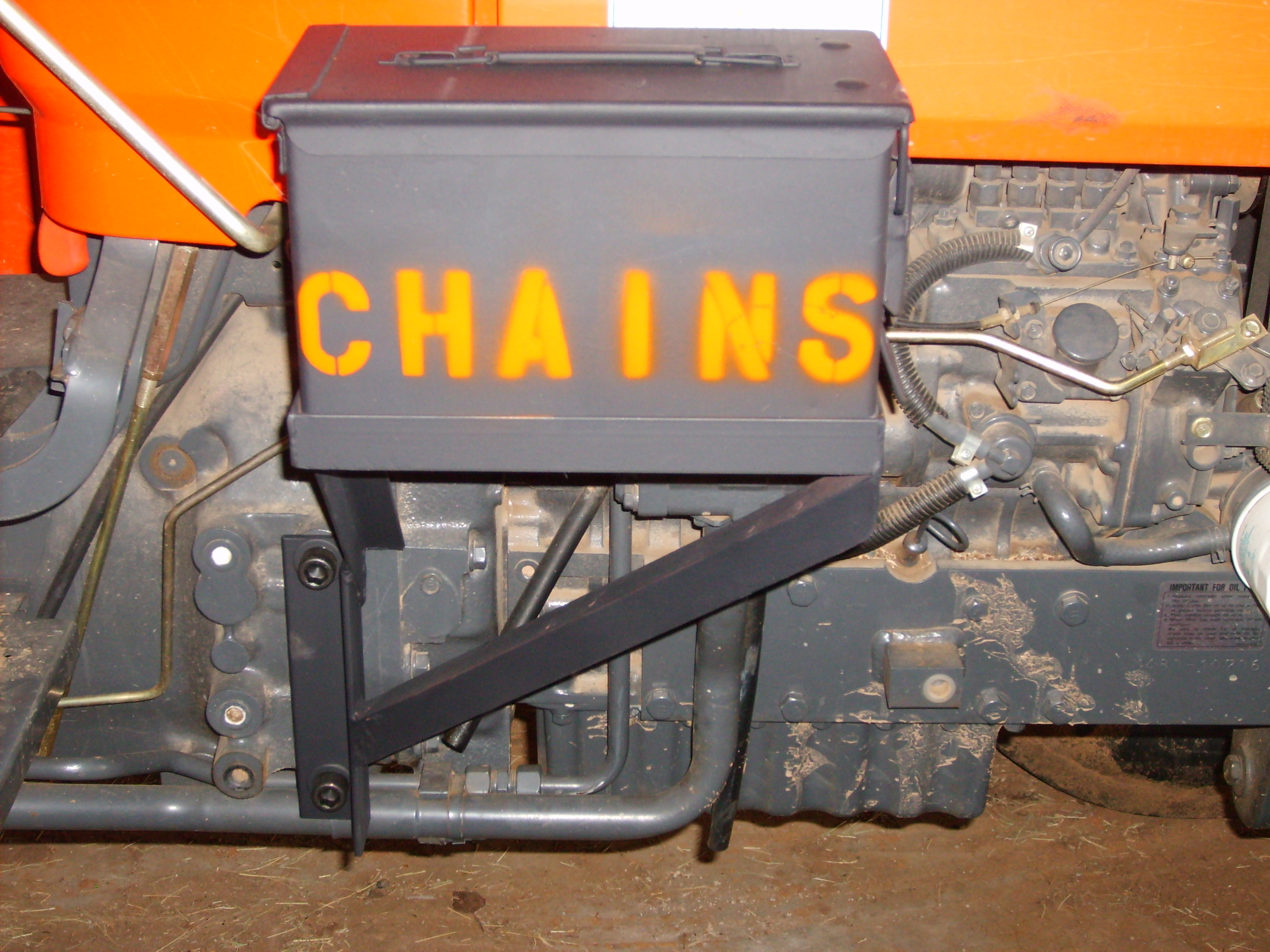

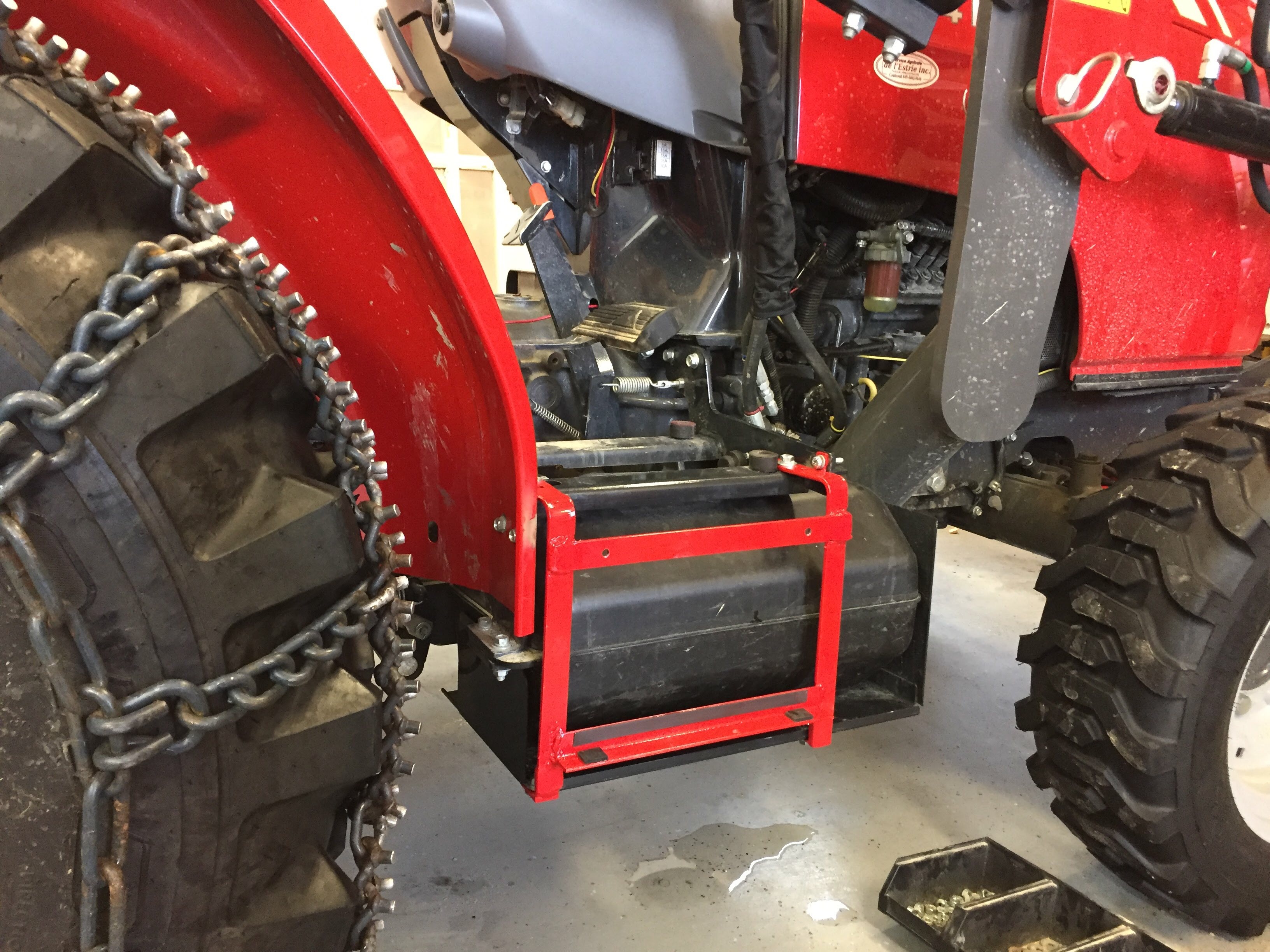

I also made a toolbox out of an ammo can. I don't have an FEL so I built a bracket to bolt up to where the FEL would usually mount on one side. You could incorporate your chainsaw holder here as well.

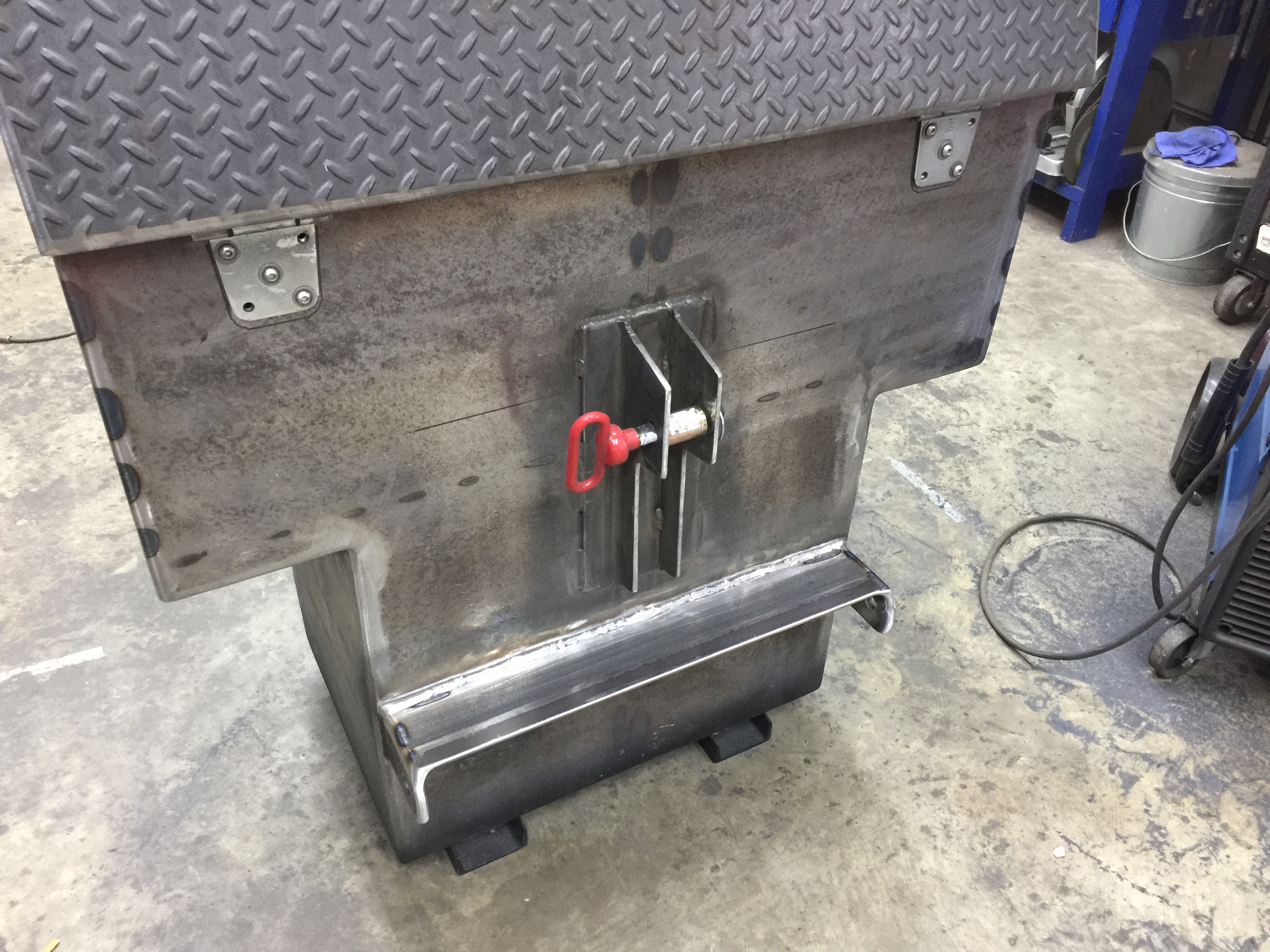

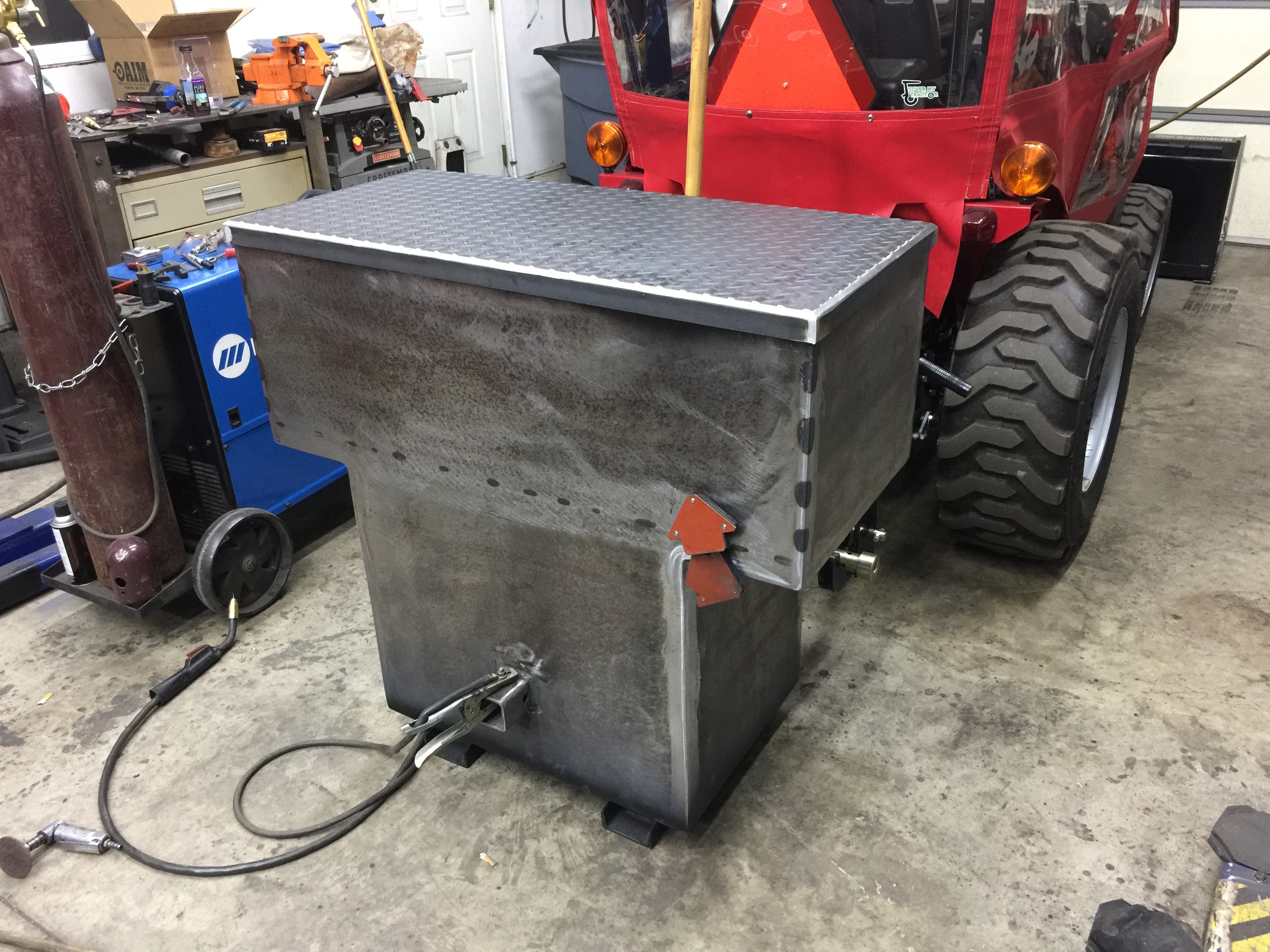

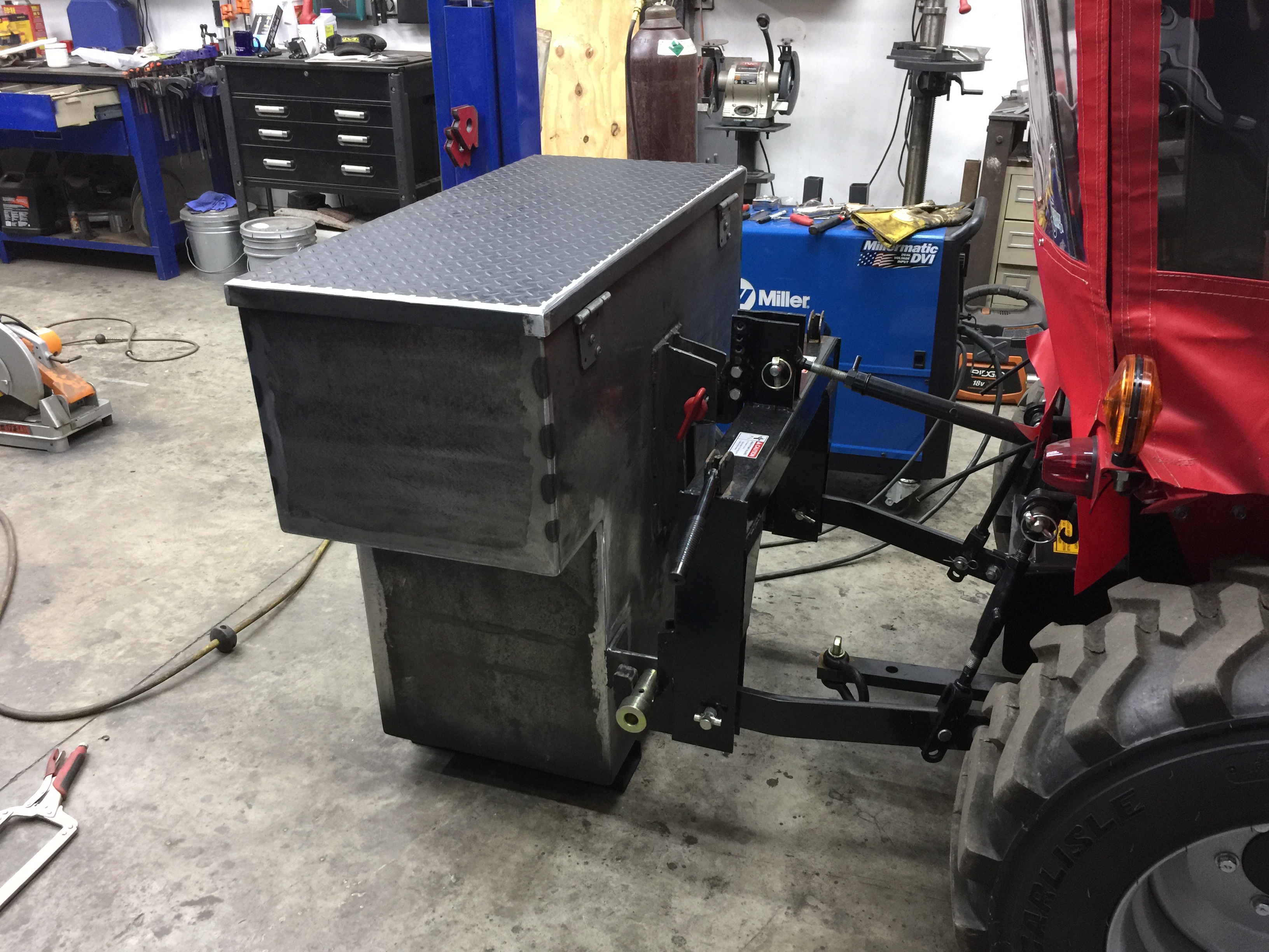

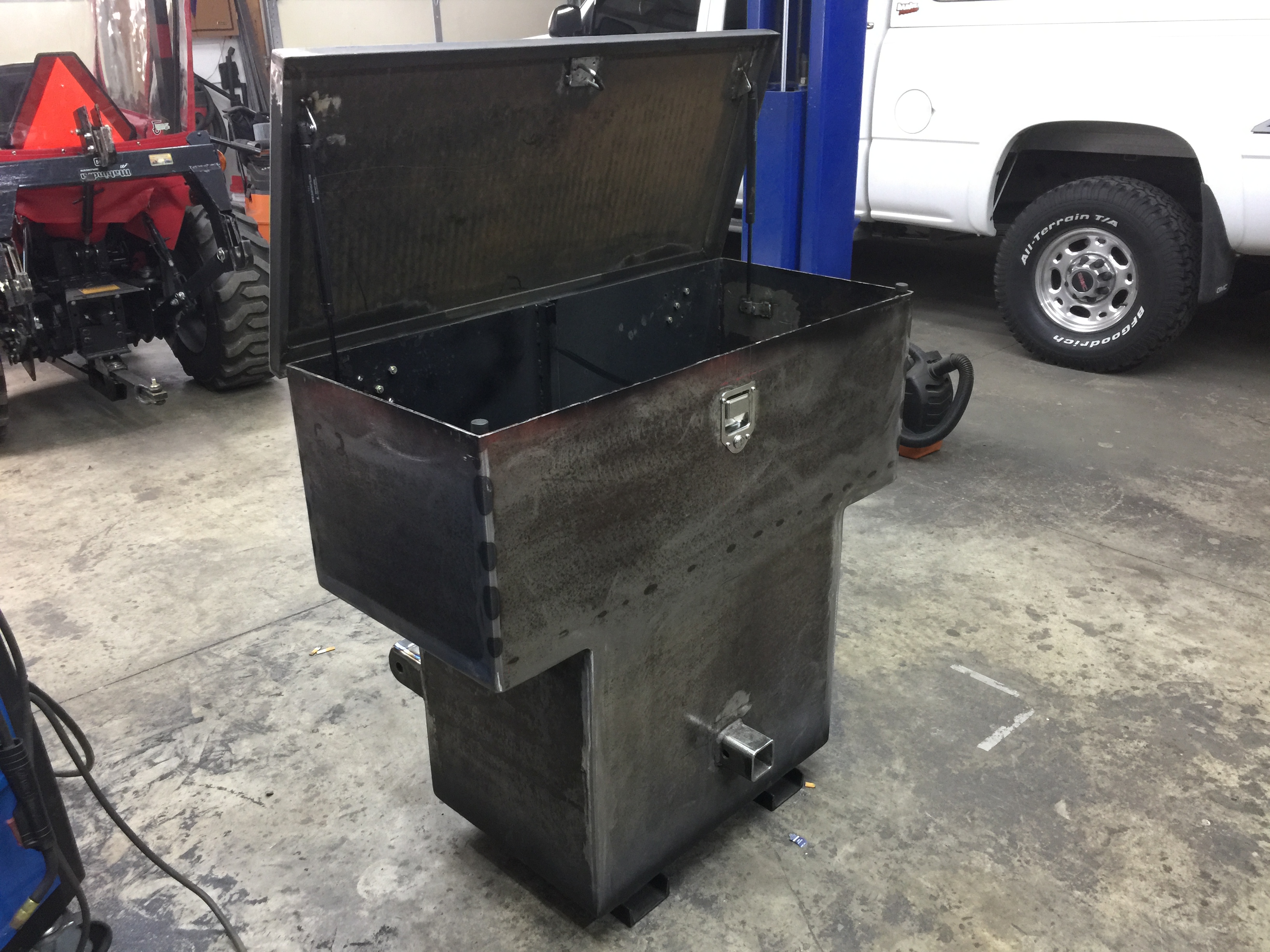

How about a tool box for a chain saw , fuel, oil, ax, and what ever else, plus a weight box for the skid loader forks. IMG_0619.JPGIMG_0620.JPGIMG_0628.JPGIMG_0630.JPG

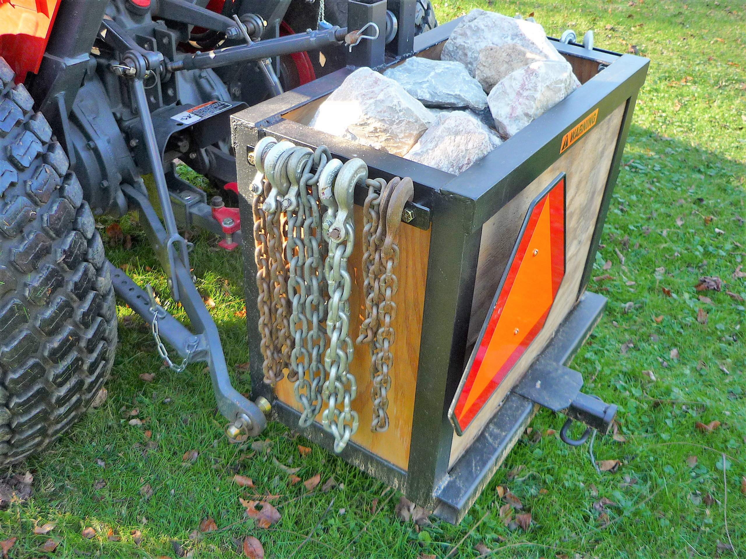

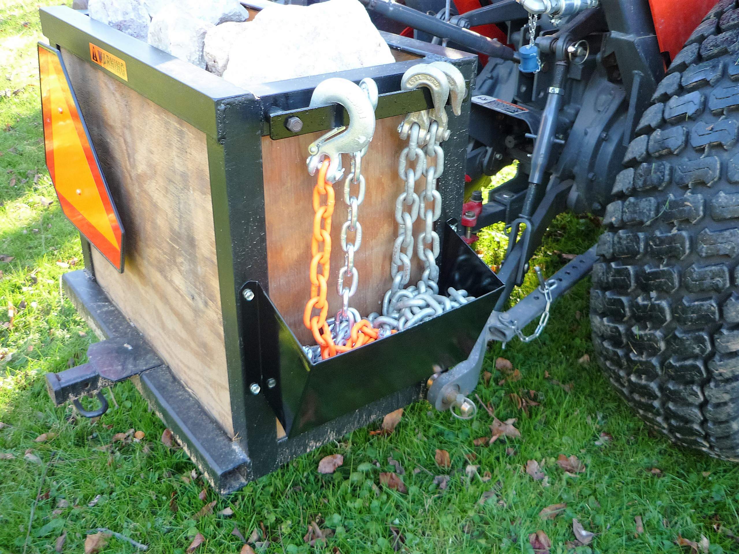

I needed a weight box and a place to carry chains where they were easy to get to... not nearly as elegant as Bigtyme's box, but then, I am not elegant, either. I can add or remove rock as needed, which I think is good, and carry stuff when it's not full of rock.
