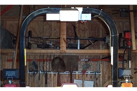

Bob,
Here is a photo of my rear facing light. I mounted it on a bracket just under the top of the ROPS. It is a 50w flood and puts out tons of light.
The front facing lights are 50w trapazodal lights.
My friend and myself just finished the wiring this past weekend. Excuse the 200mph tape. It's holding the switches in place until my friend spot welds the brackets.

Hi ya
i don't know bout the law in the US but in Kiwi ya can't have a "white"light faceing /working backwards on roads it must be red or orange some spotlight makers (night shooting spotlights)make covers that can take the heat a switch may be ya best bet or someone who can back track ya wires and wire it to full beam so on dip ya just have front work lights and diped mains

My 4300 has wires that are hooked to the swich. It's only on in position "D" . It's on page 61 in my manual. If you don't need it on you use position "B" or "C". The extra wires for the back light are already there not attached to anything.
DPR

Maybe a revisit to your dealer, as he needs to educate whoever he has hooking up lights. As mentioned, there is a wire already there for the rear work light to be connected to the correct switch position. I found mine, and it wasn't too hard to hook up. Good luck.
In this area, it is also illegal to have such a light on the rear of a tractor, as well as it is illegal to be plowing snow on the county or state roads (this includes pushing snow across the road to the opposite side with truck or tractor). Maybe it has to do with liability, or safety, or something like that.

As I recall (3 year recall is not easy!), the wire connector is under the seat (looking from the rear, it is just right of center), folded and taped with some other wires. Your 4300 is newer, so maybe there has been a factory change. Hope you can find it. I will also look for mine tomorrow in the daylight (and supposed to get up close to 20 degrees) and feed some more exact information to you. I may even get by my JD dealer and ask about it there too. Even then, I don't expect but one or two there would know about it. Doubtfully the dealer, but likely one of the mechanics. We'll give it a shot.
