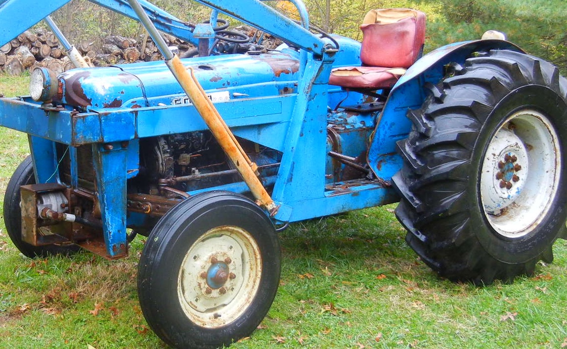

What does this tractor look like to you? The grill and the gauges tell me that it is not what the owner claims it is. He says Ford 2000, but I have not seen one like this before. The 62-65 had the rib down the center of the hood, but it did not extend onto the nose/grill like this. Someone more experienced please comment.
   / ID This Tractor #2
Looks like a modified Fordson Major, but something does not quite look right......
   / ID This Tractor
Additional info is that it is a diesel and it is a 3 speed with hi/low range. He says it runs strong, but I am going to look at it tomorrow. Just want to be prepared.
   / ID This Tractor #4
I think it may be a Dexta.
   / ID This Tractor #5
yup looks like a dexta to me.
due to some dubious naming conventions dexta/2000 and super dexta / 3000 and the smajor/5000 you see some pretty confused people..
   / ID This Tractor #6
The early '64/'65- Fords were 2000 Dexta, 3000 Super Dexta, etc. This one has a 6X2 Trans which makes it a UK tractor and the front axle sez 2000/3000 which would then be Dexta/Super Dexta, but can't tell which.
