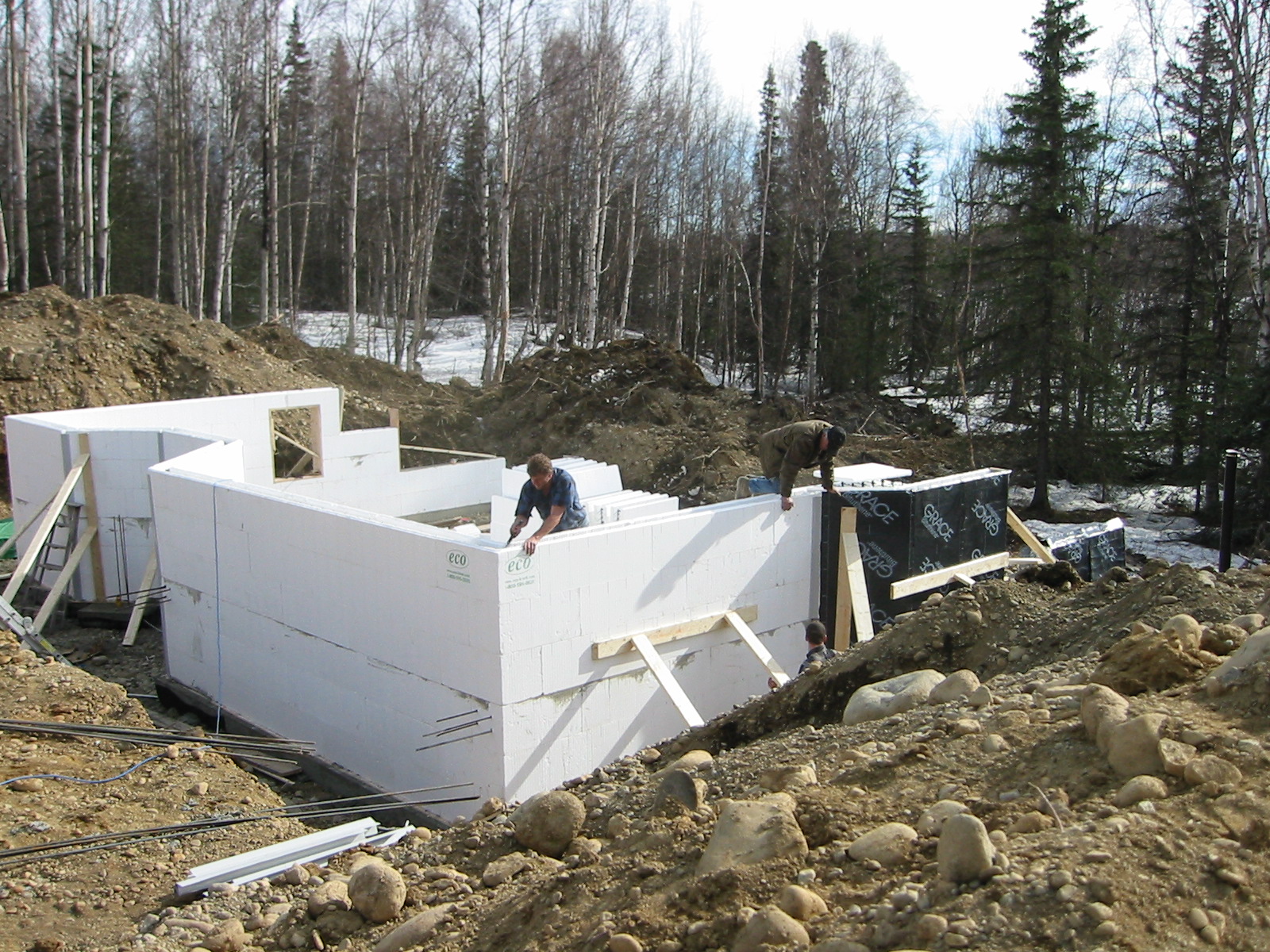

   / ICF forms, any one used them? #4
We used them for our entire basement, they worked very well I added a pic to give you an idea. There are lots of manufactures, but that I know of, only two basic styles. probably several variations. 1) plastic lattice between foam panels 2) one piece foam blocks with foam lattice. I think, for your application you would want to go with #1 because it makes a solid concrete wall between the foam. The kind we used (I can't remember the name) were #1, we were quoted an R-30 insulation factor.
Above all take the time to Brace the walls as (Eric_in_Hoyt) said, it's time well spent, and DON"T use a vibrator they can cause a blow out!
