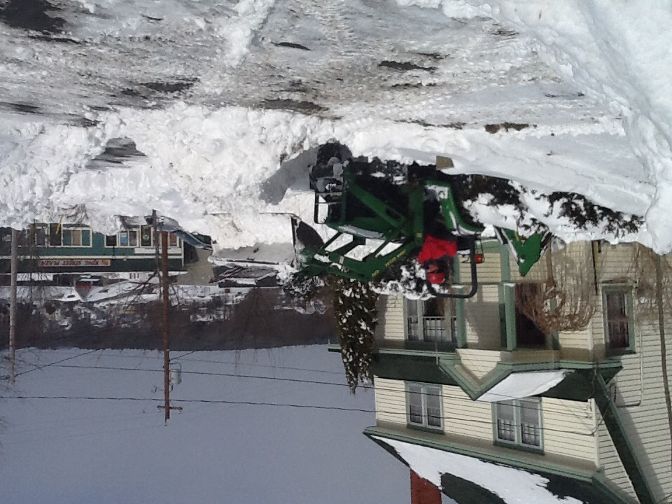

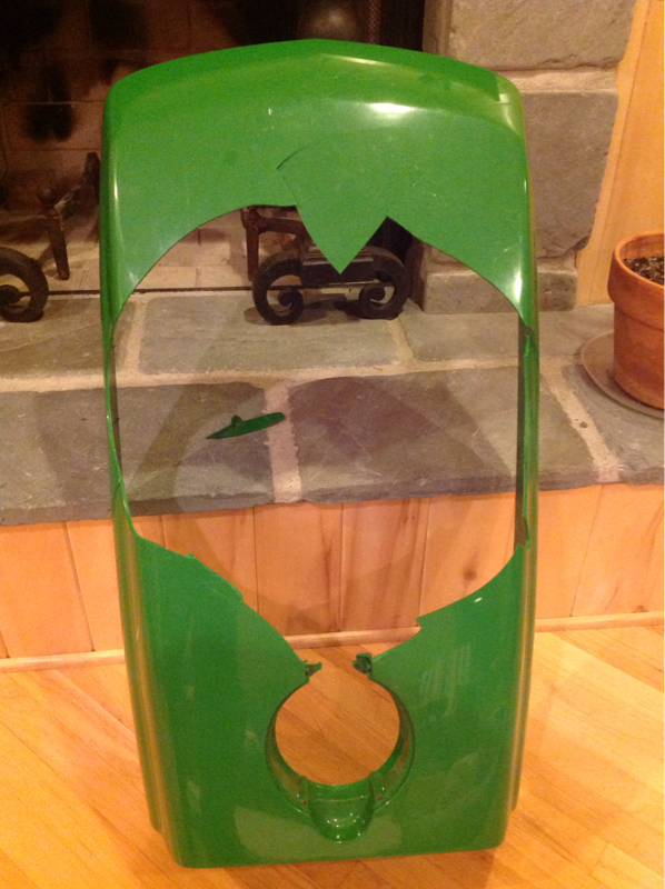

After 180 inches of snow in NW MI, there's not much room to pile the snow. An errant ice chunk did in my hood. Got the new one and am working to put it together and install on the JD 4410. A couple of tips. First, the hood was outrageously priced. The replacement foam, gasket and decals were worse. I opted to carefully peel them off and reuse. It can be done! Go slow and the adhesive stays with the foam. On the stencil, use double sided carpet tape.

Well be thankful you didn't get a piece of plastic in your face. Nice fireplace:)

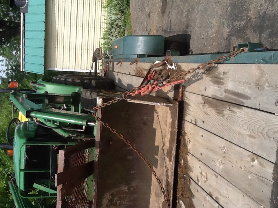

A quard added to the top of the bucket may be advisable.
Metal frame with expanded metal for the fill . Don't know how the pictures will be oriented.
Not painted and looks ugly but does work.

I just carried on with the same angle as the top of the bucket....Welded the 1/4" checker plate and then welded 2 grab hooks to either side of the top and a big slip hook in the middle. Radiused the corners, too.
