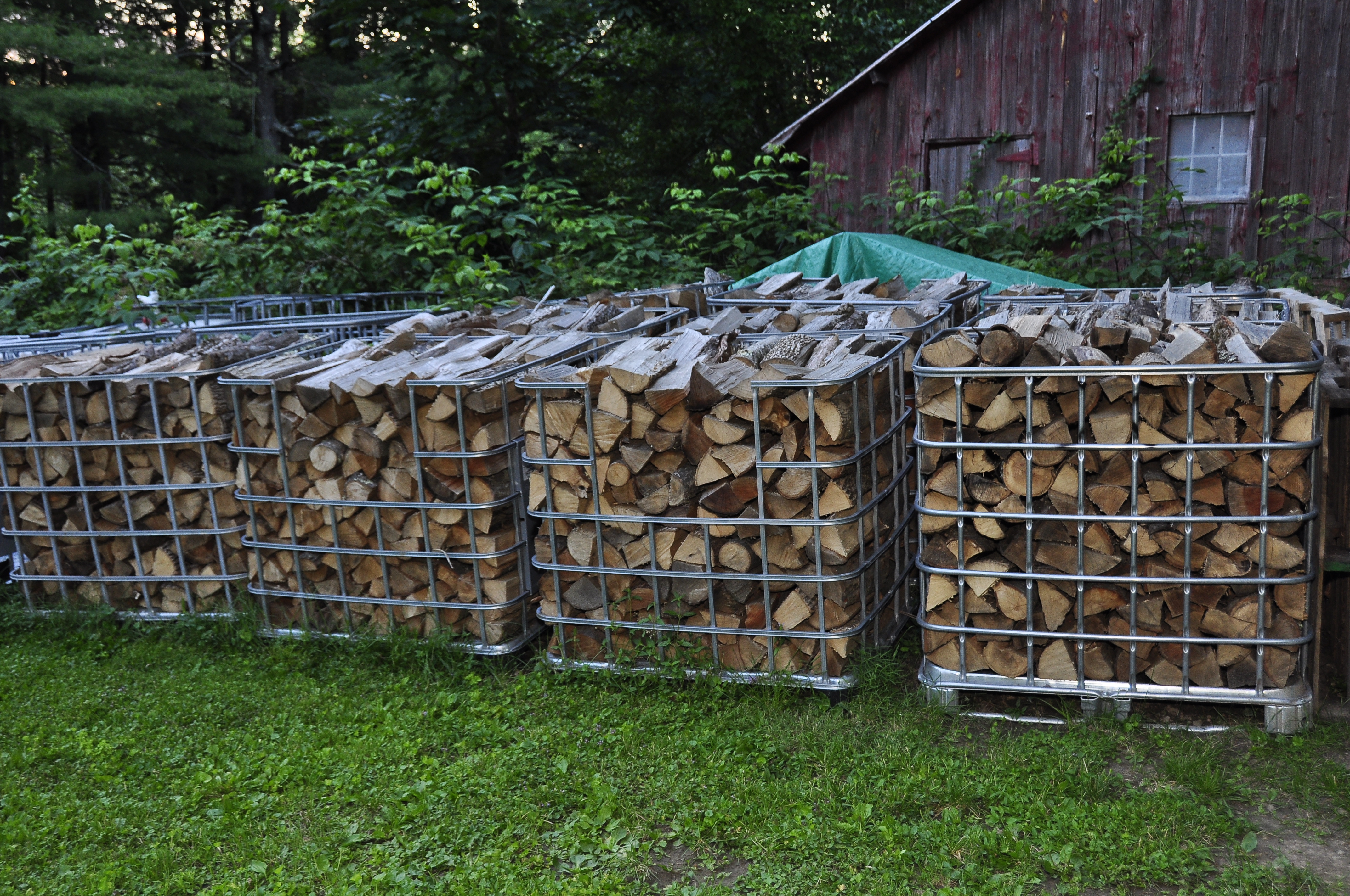

Anyone use them? How about capacity? Will they hold a rick randomly tossed in?
   / IBC metal totes for storing/transporting firewood #2

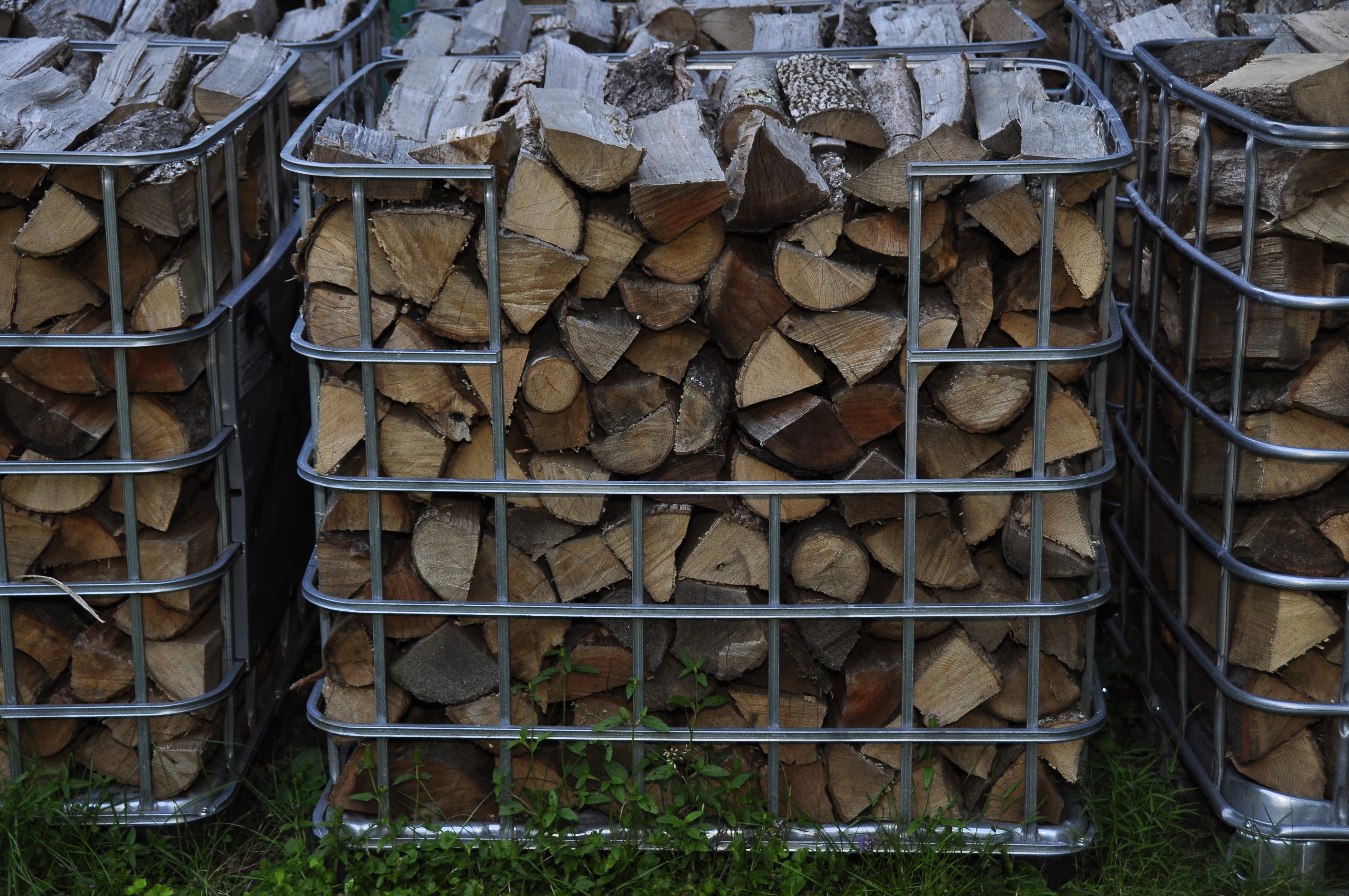

They're about 1/3 cord of useable volume. The space inside the cage calculates to .37 cord but the cage walls are not exactly flat and the corners are rounded so it's more like .33 cord. They're probably not the best for random piling as the space between the bars would let some pieces fall out unless you split your firewood really big. They'll hold stacks though.

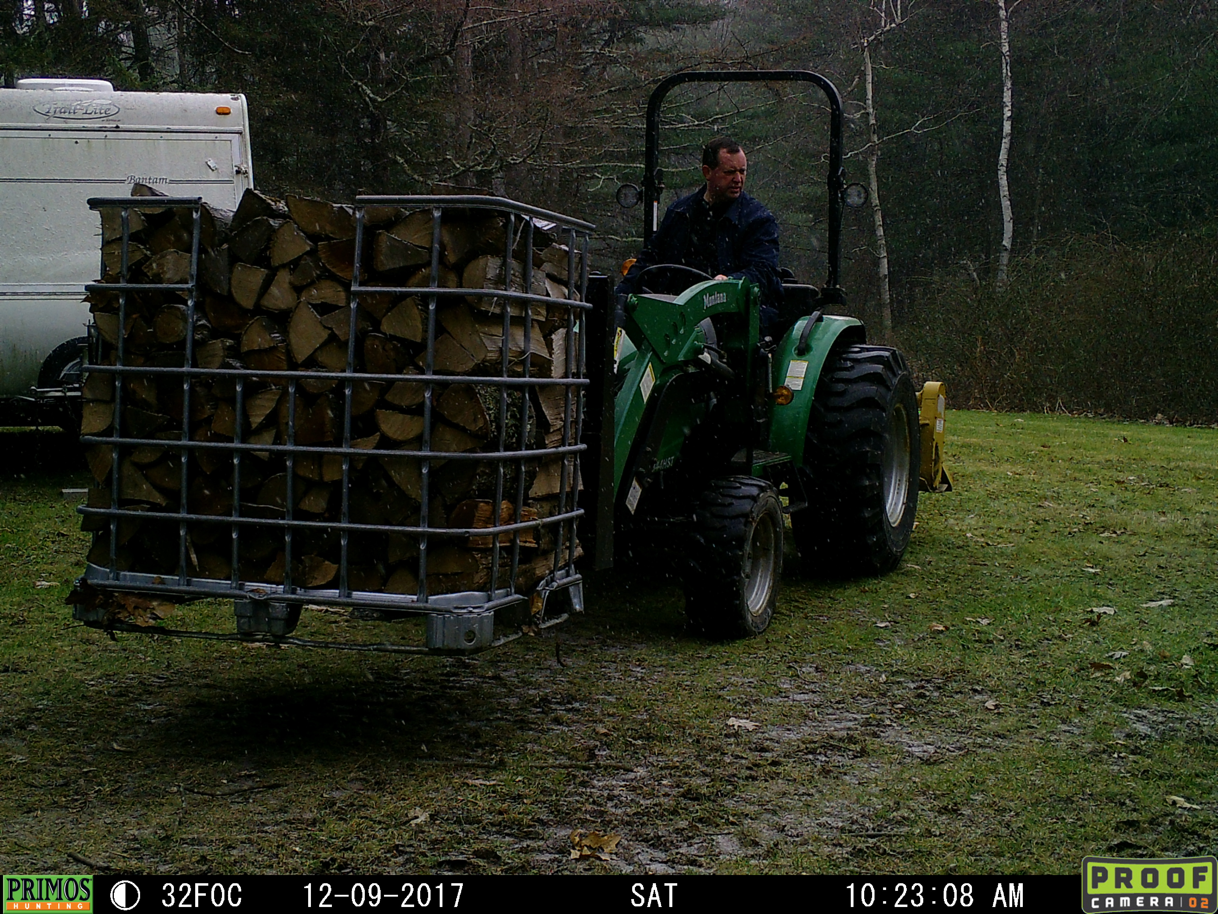

My FEL will lift 1500 or so lbs. Will it handle a tote full of wood?

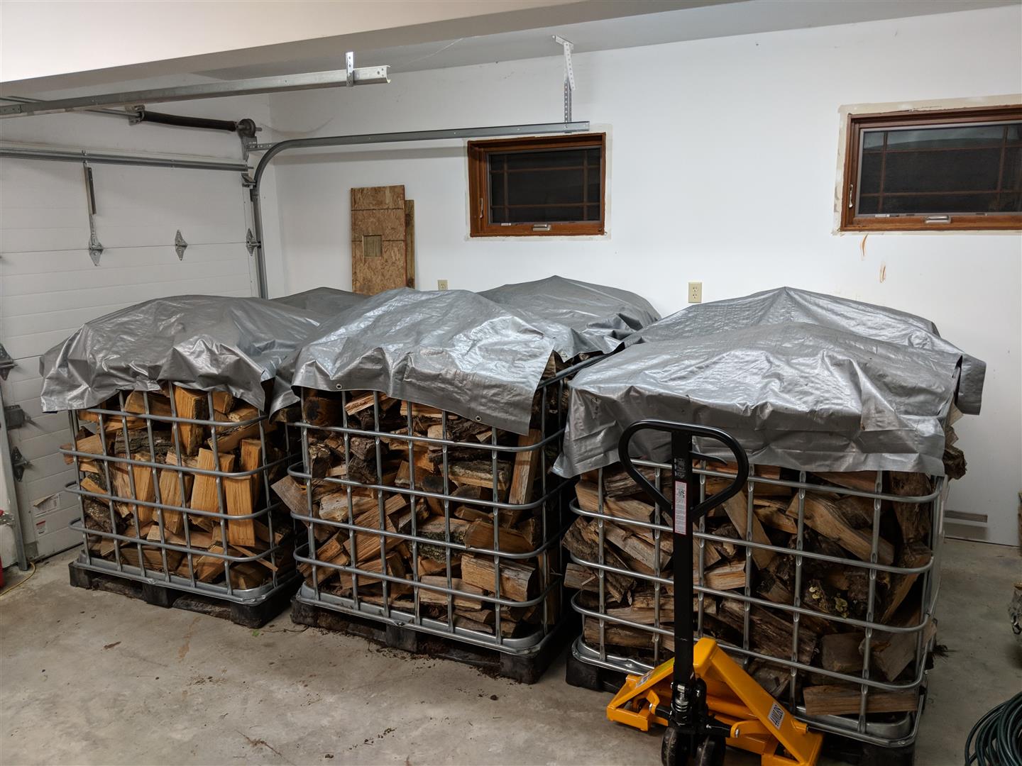

I bought 16 of them and still need to get rid of the tanks... I did this because my wood stove is a Tulikivi (Finnish design) and they left out one key detail - the firebox can only take 12" wood. Impossible to stack, so I split and throw into these bins. Works great. I think I get somewhere between 1/3 and 1/2 cord in one bin, based on some crude measurements/estimates.

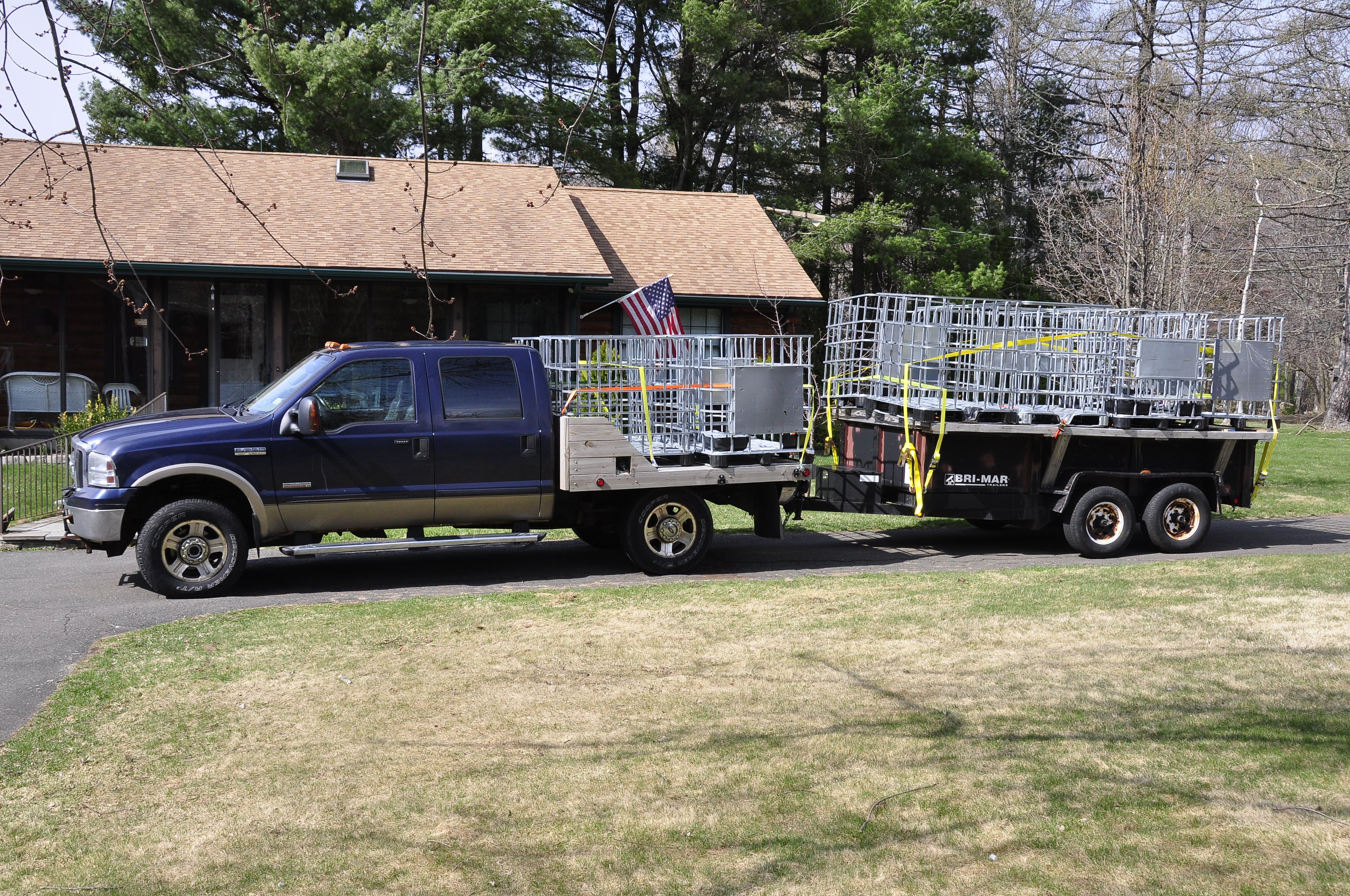

$40 is a good price. I see them between $75 and $100. I found a guy selling them for $35 so I bought 18 so I would store 6 cords. I cut a 2x2 opening in one side so you can reach in to load and unload the wood.
3 full bins is a cord. Oak weighs 4,000lbs a cord, so each bin can weigh 1,350 lbs or so if green wood is stacked. Make sure you have as much weight on the back of the tractor as possible. I use a 650lb rototiller, and could use more if I had it. Without the counter weight I cannot lift the loaded bins.
