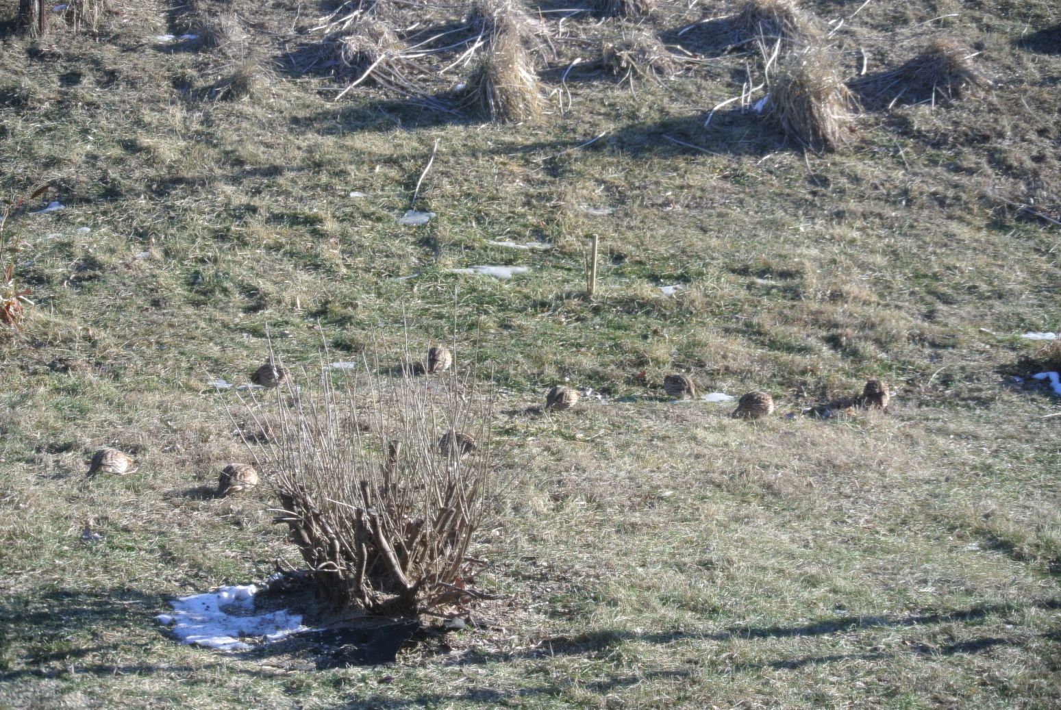

We have three flocks of quail on our property I know of. Each has more than 10 birds. So our focus would be pheasants. I hear them every evening when they fly on trees to roost but there are only few.
Quail pictures from two days ago.
