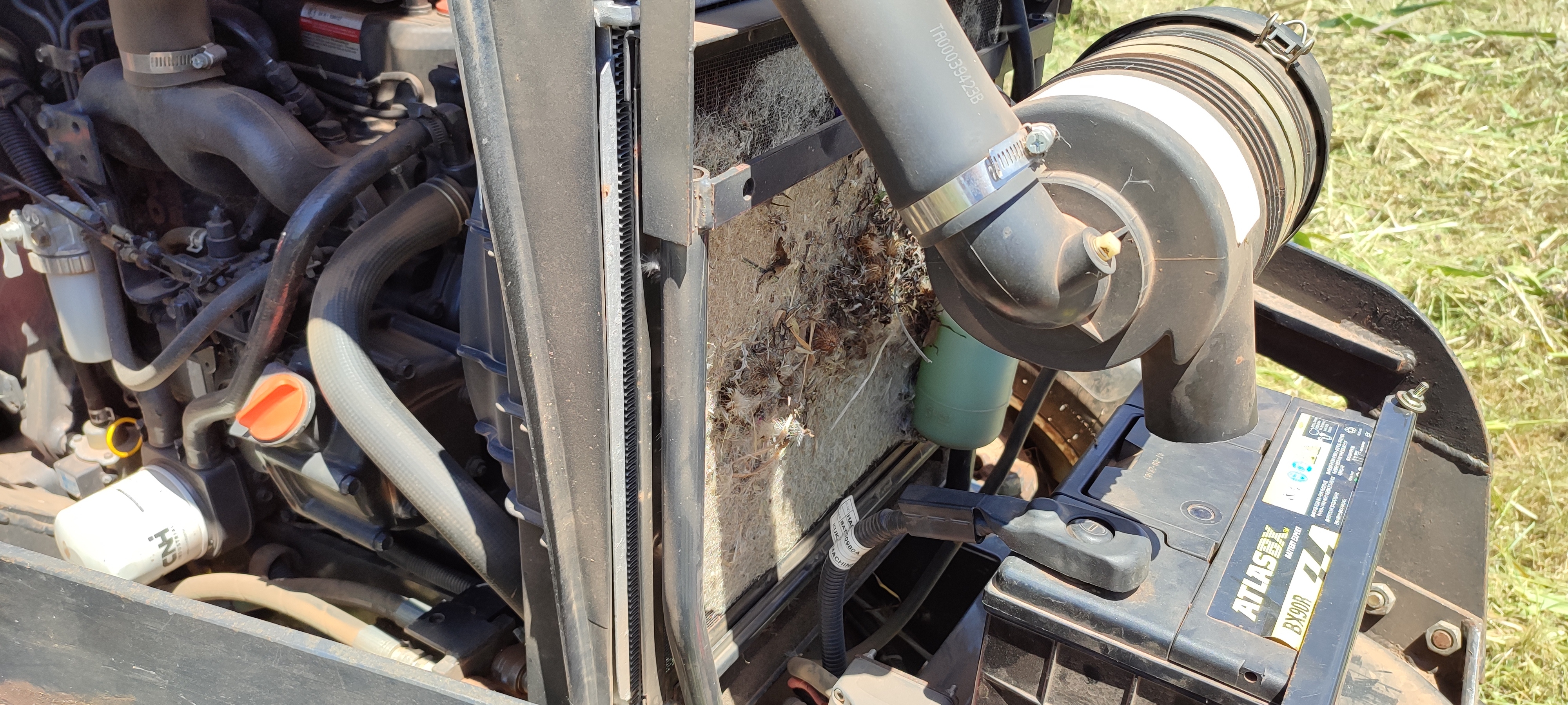

I mean, this picture was only about 30 min worth of brush cutting to get to that point. In this case, it wasn't getting hot. I just knew with the stuff I was mowing, it was prone to happen very fast. It was just a matter of cleaning the screen too and it was good to go again.
A lot of people don't even realize that depending on what they're cutting, they may need to cleaning those radiators multiple times during the job. Then, they found the expensive way that they really should pay more attention to cleaning the radiator. I've seen others blame the manufacturers for using small radiators or some nonsense like that.
This is all part of owning and operating a tractor.

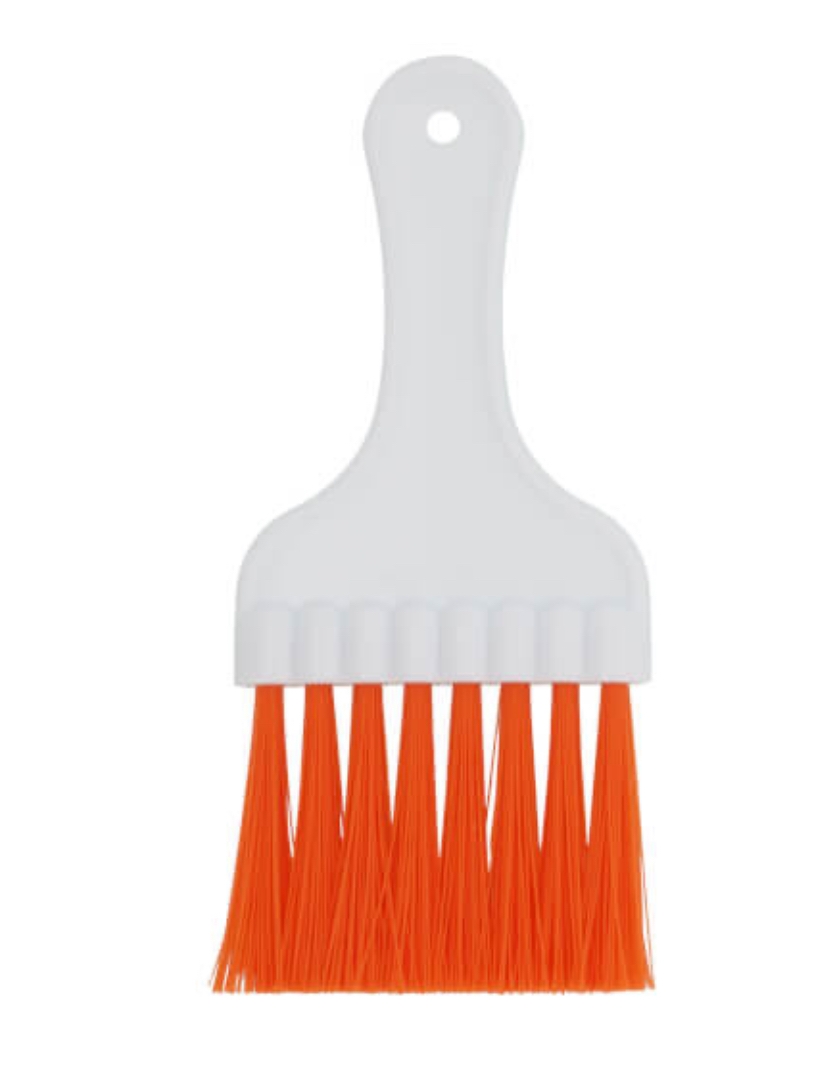

I had a mid 70s IH2500b tractor loader that the radiator and hydro coolers would get seriously plugged when I drove through weeds and grass. As you mentioned, the temp gauge would go up, and, a warning light would come on and a buzzer would sound. Carried a fine fin brush for air conditioner coils with me for just that reason. Similar to this, but only about 3" wide.
