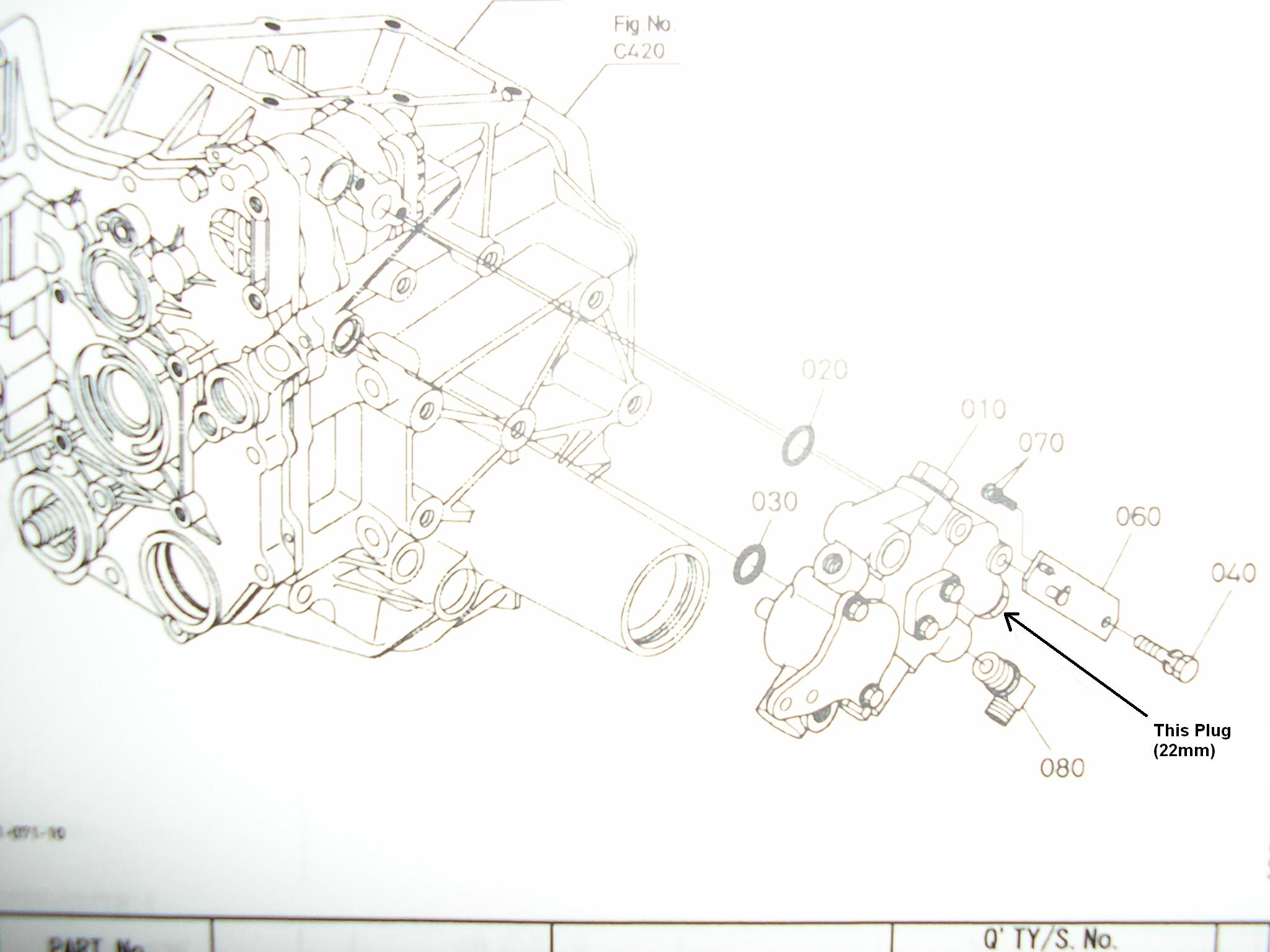

/ I was shim less ! #14
For anyone interested in the shim part no's.
31351-3795-0 = 0.4 mm
31351-3796-0 = 0.2 mm
31351-3797-0 = 0.1 mm
/ I was shim less ! #15
here's the location. Sorry I did not take pics when I did it. I don't normally keep a camera in my tool box.

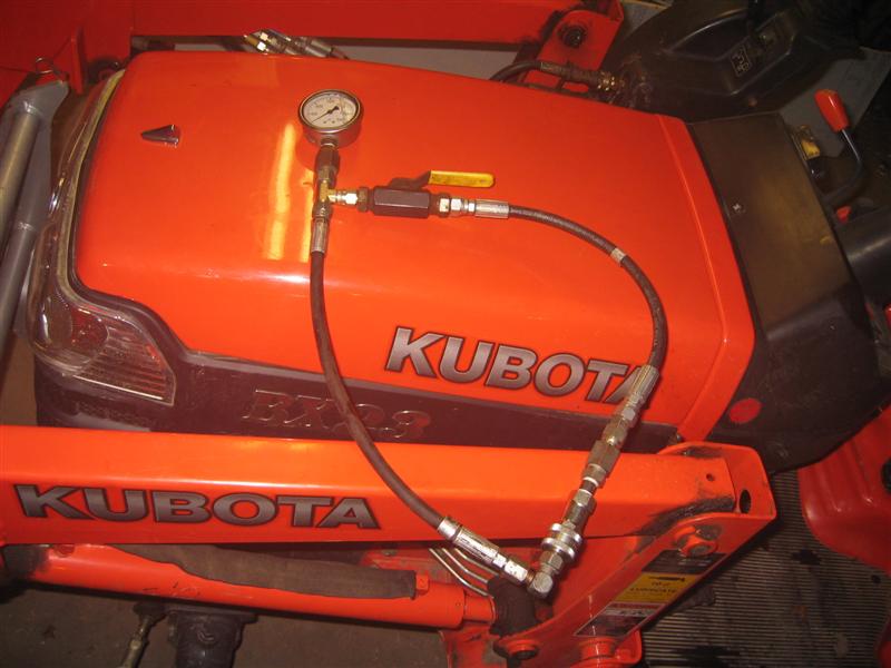

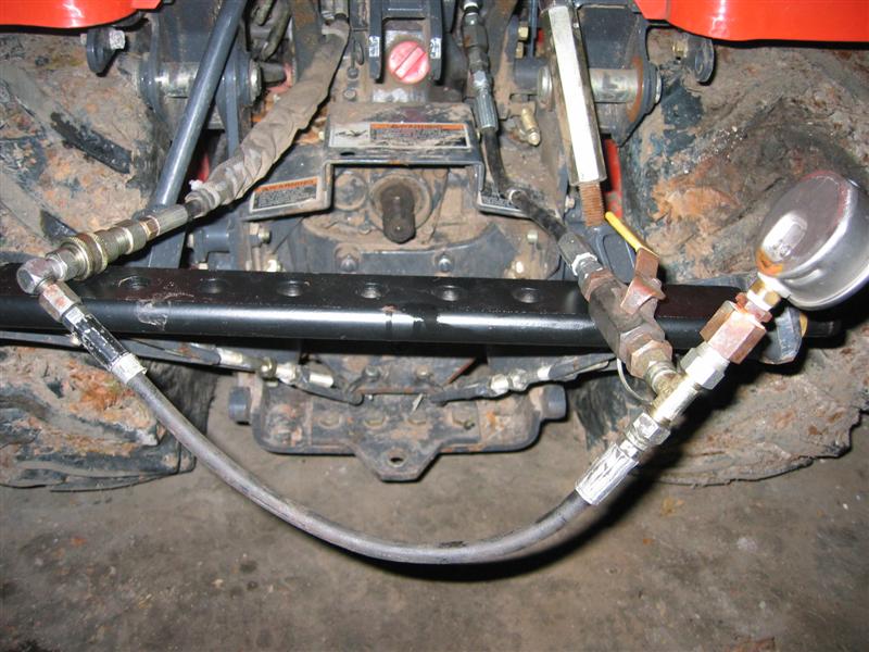

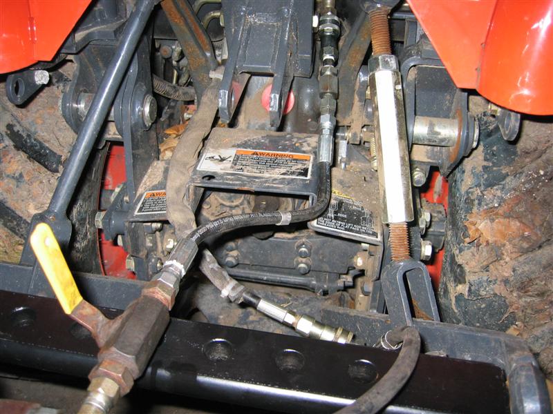

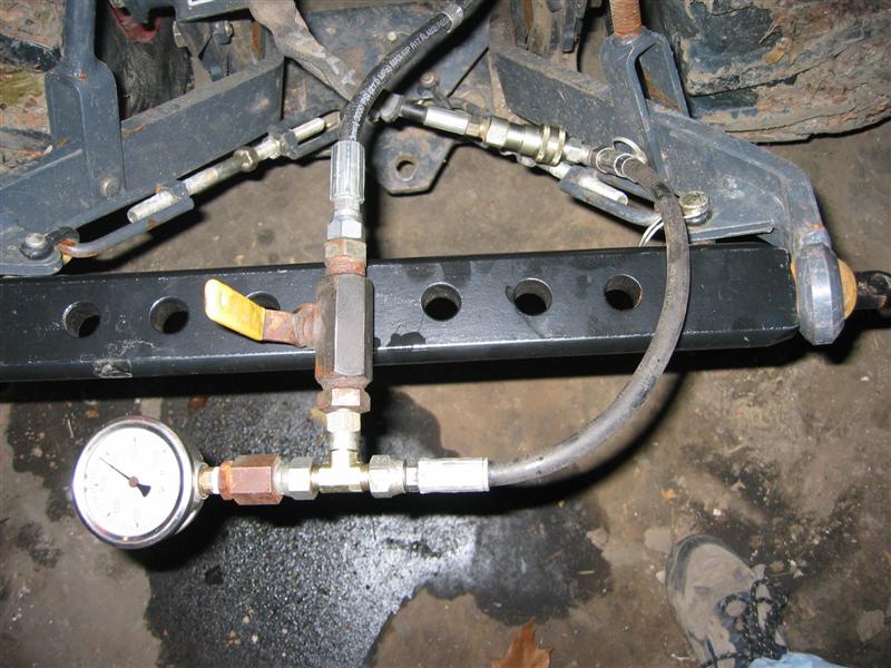

/ I was shim less !
#16
I didn't get any pics with the left wheel off but drtydeed has the diagram where the shims go.
As for how the gauge is hooked up see the attachments. Since I don't have the hoe on I used that connection with an inline valve to get the load on the pump. Worked great. The valve is rated at 2000psi

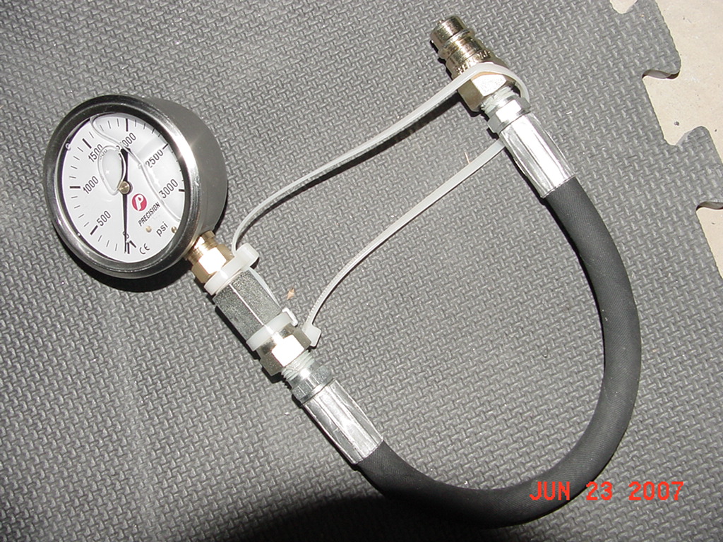

I bought my tractor to use- not to have another vehicle to wash and wax. Same goes for my trucks. All have some scratches and dings. Just look in the mirror after 50 - 60 years none of us that use our hands for work are perfect.

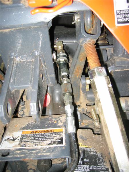

/ I was shim less ! #20
Just a note for those who want to build a gauge setup:
You do not need the valve and "T", all you need is the gauge, a short piece of hose and a QD that fits one of your loader ports. You just plug in the gauge and operate the joystick to energize the port the gauge is plugged into. DO NOT HOLD THE JOYSTICK FOR A LONG TIME THOUGH as you are deadheading the hydraulic pump.
Attached is a picture of mine...
