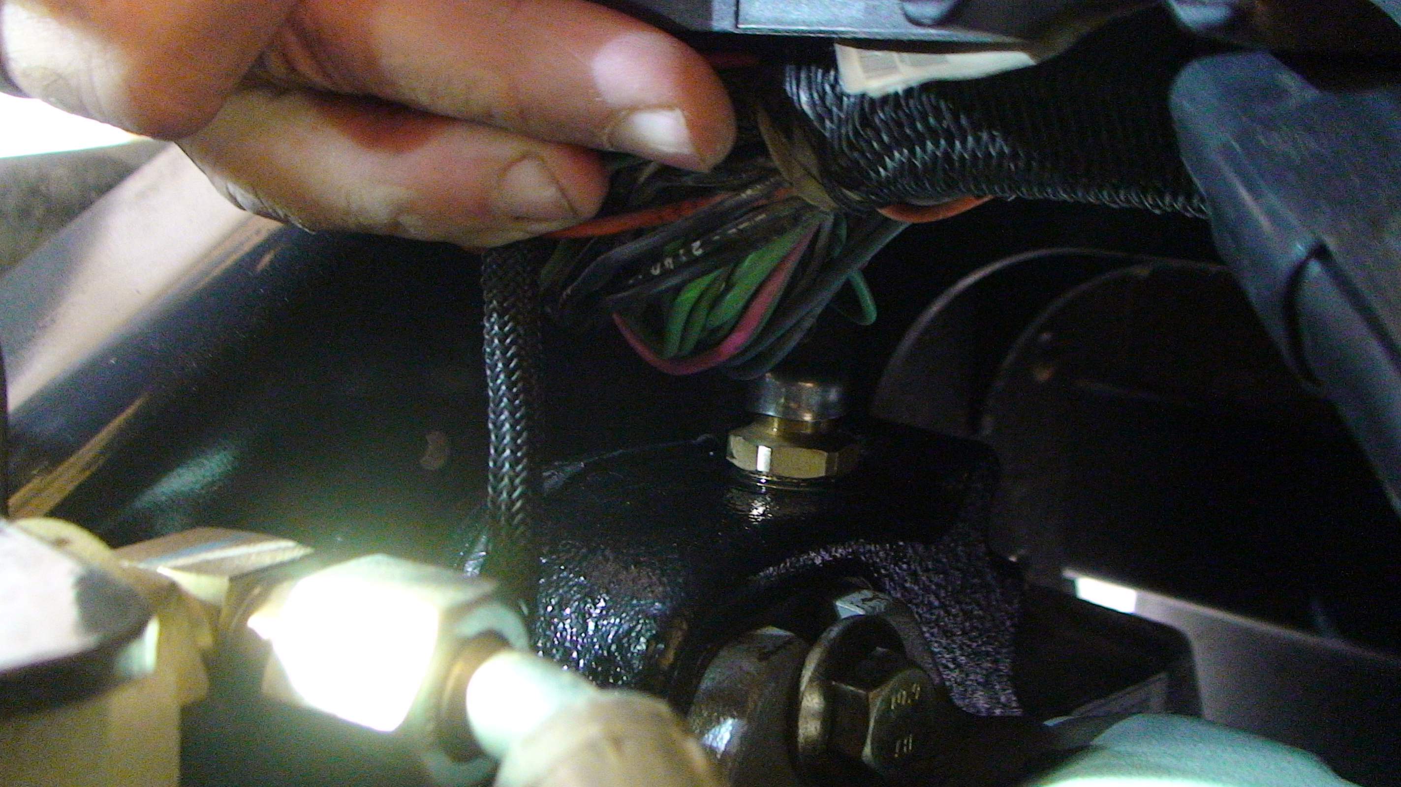

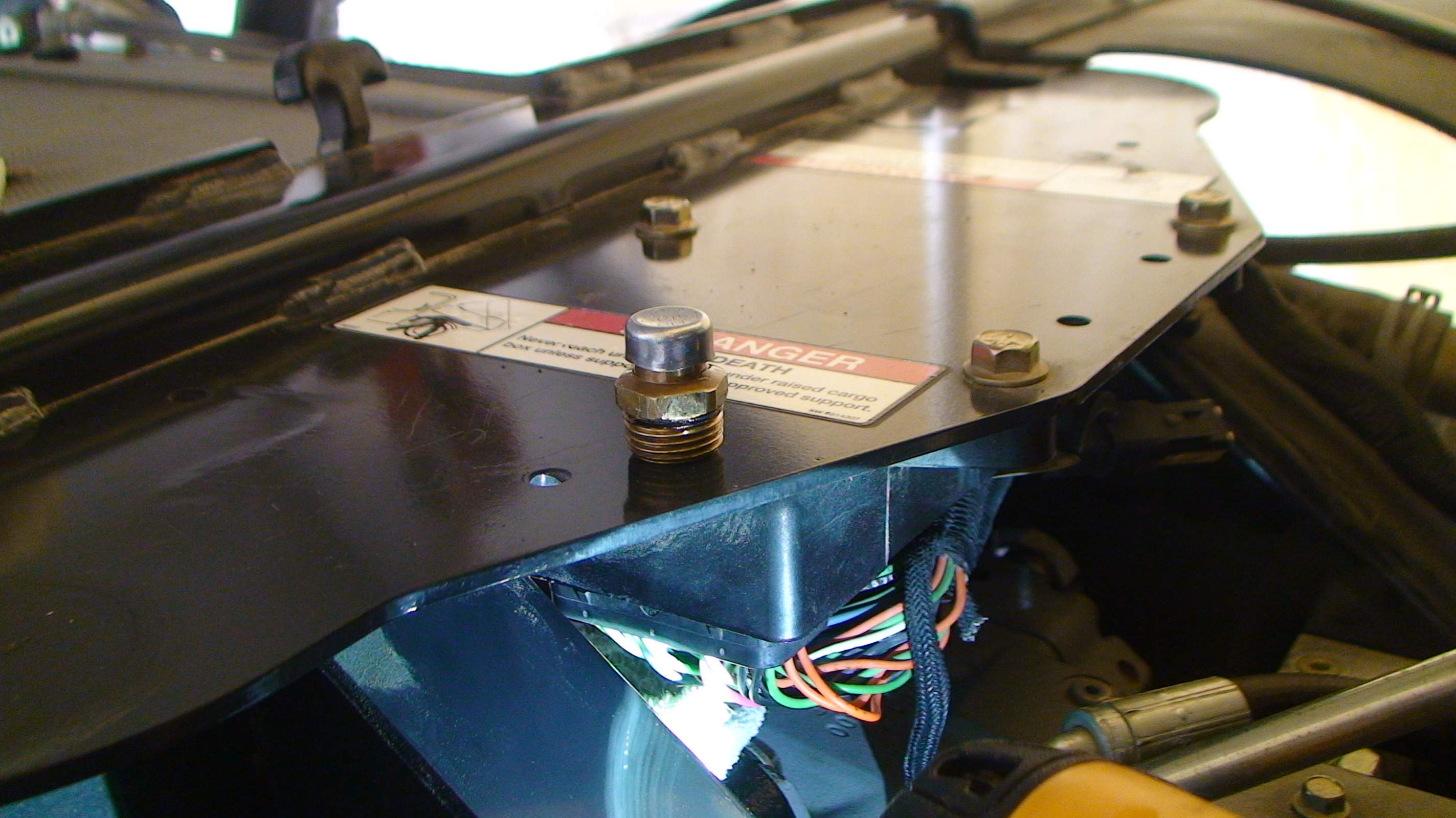

Hopefully, the leak isn't coming from the front drive/transaxle unit (if so, you're looking at big $).
I'd be interested in knowing if it is leaking from the pressure release valve on the front drive/transaxle. Attached is a picture of that valve from the rear drive/transaxle unit, so you can see what the part looks like.
My TC has recently sprung a leak through the pressure relief valve on the gear casing for the rear drive motor (just like you describe). I am thinking it is probably a leaking seal on the motor saft. What was the cause of yours?
