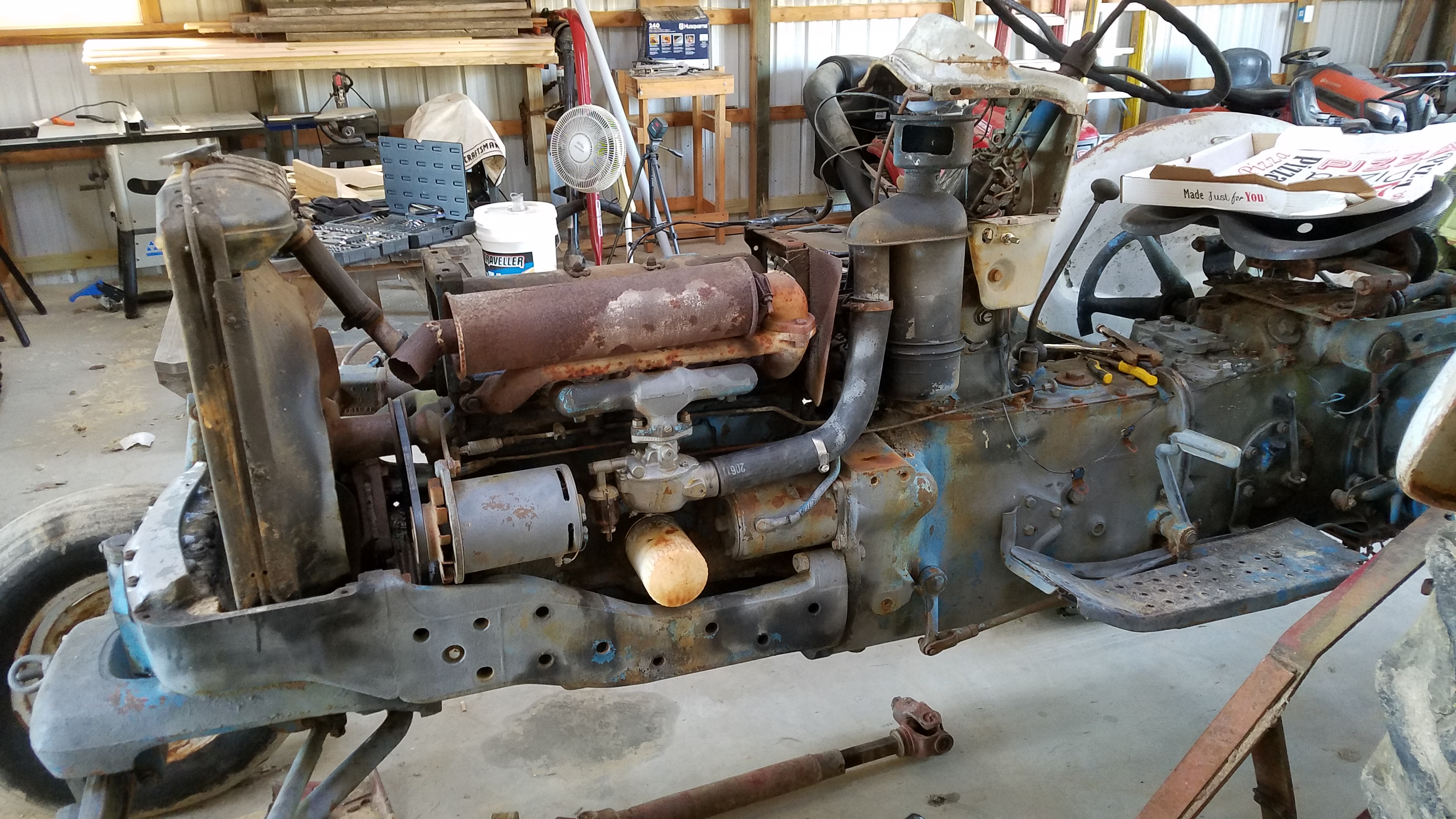

I need some help id'ing this ford tractor folks

I got this old ford tractor.The numbers behind the starter on the flat part on left side of engine are 411C1-5 and under that is <>25982 <>. The number on bottom of the engine is CONN 6015J so I know its a 172.On the hydraulic housing the numbers look like 310835.Its a pretty tall tractor. Thanks alot in advance.

Those are probably just the casting numbers on the block.
A good picture is worth a thousand words. ;)

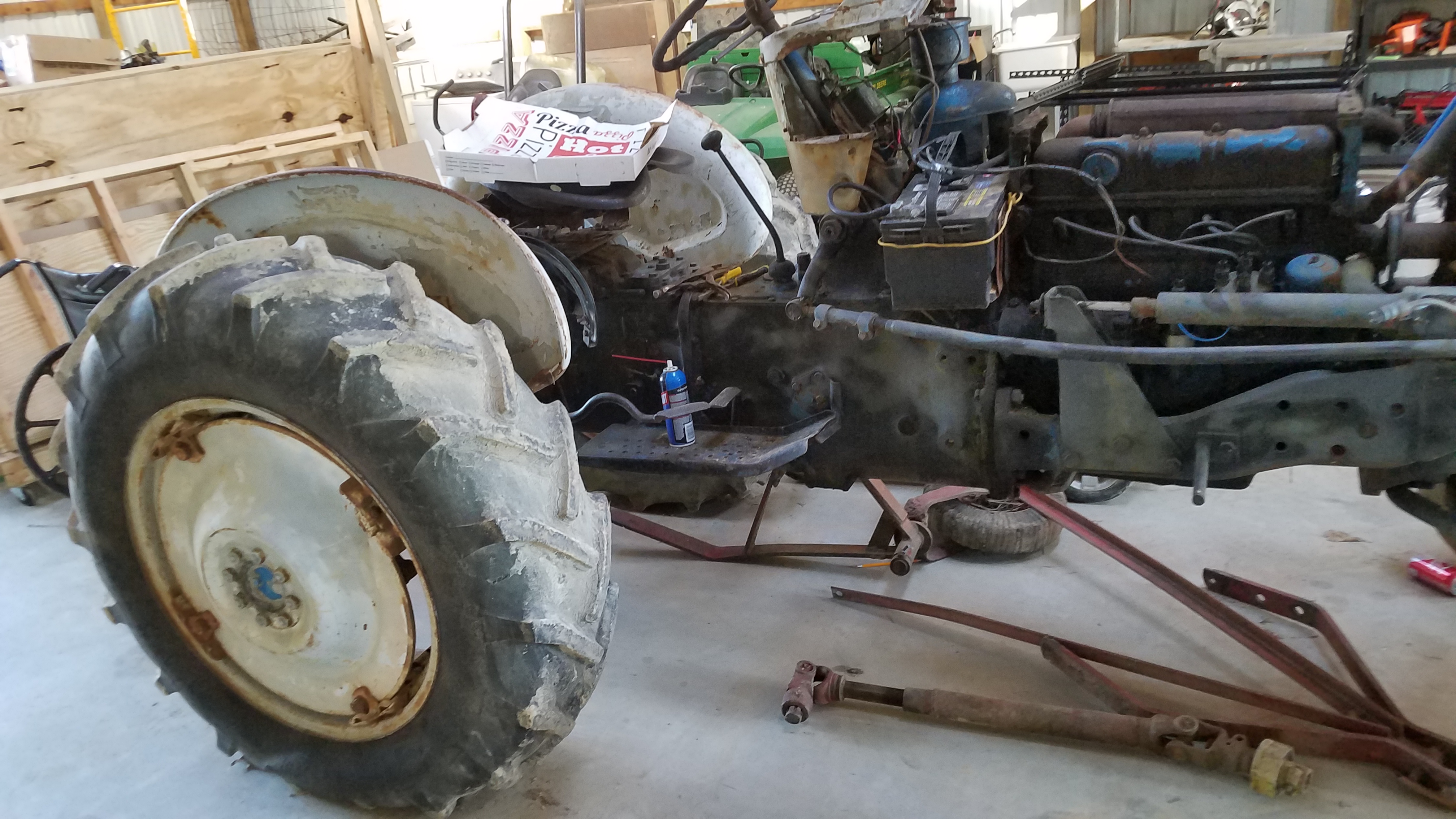

Pics helped some. Still need more with the sheet metal attached.
But, from what I see so far, my guess would be a 2000. Look here and see what you think.
Here's another website that may help: Smith's Old Ford Tractors

The "N" models were grey, the 600 series were red and it was after them Ford used Blue but the updraft carb I do not think was used when they left the 600 and 800 series models were stopped and they went to the 3000, 4000 and so fort models. I believe you are working with either an 8 or 9 N but could be wrong. Look and see if you can find a serial number and if you do see it tractordata.com has serial number like yours in any of those models.
As to getting the tractor idle those updraft carbs at least one our 601 are touchy. Last I know NAPA had those carbs but that was over 20 years ago. I would get the tractor running at lowest rpm it will and slowly adjust one (of if memory is correct there are only two screws to adjust) screw slowly at the time. I would turn say 1/2 a turn and let it run for few seconds to stabilize and then do it again.
Are you sure the throttle linkage is letting the carb return to idle? If you have not remove the linkage and be sure you have full travel of the butterfly in the carb.
   / I need some help id'ing this ford tractor folks #6
looks like a 4000RC to me.
