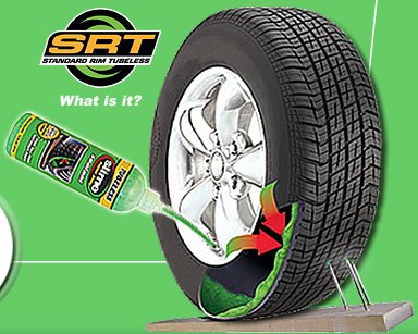

I have seen it in gallons at TSC quite reasonably priced.
It comes with a pump in the gallon size to inject it through the valve stem once the core has been removed.
You then re-insert the valve core, air the tire up and immediately drive on it to circulate the Slime within the tire or tube itself.
I had the tires on the air compressor, gas welding cart, two wheeled lawn cart, and power washer all go flat at one time or another from either a slow leak or a lack of use.
I put Slime in all of them and haven't had to mess with them since.
They make the sealant for tube or tubeless tires so if you are going to try it be sure that you get the right mixture.
You can't miss the stuff on the shelves as it's bright fluorescent green, even wilder that John Deere Green. /forums/images/graemlins/wink.gif

I've not used the foam, but am familiar with slime. We use a JD455 to cut the grass around the place and every time we started we had to air up the tires to the correct PSI. I added slime to the tires and it's been right ever since. There are several similar products available but I found mine at Wallmart in a size that worked on the 455. For your tractor you probably should check tire size and the product website to determine how much to add. I considered putting the mulltiseal? in my tractor tires but couldn't find a local source; it hasn't been a problem as I haven't had any flats. The R4 rears are pretty tough apparently!

I have some experience with Slime so I thought I would mention this, as it MIGHT relate to tractor tires...
My experience relates to...don't laugh too hard now...bicycle tires. I commuted by bicycle year round to work for about five years until the plant closed and I retired. Since it was 16 miles each way I preferred not to have to stop and fix punctures, expecially in the dark/cold/wet times...
Bicycle tires use tubes, and perhaps it had something to do with the tube moving within the tire, but I would eventually end up with a flat, because the slime only worked so long. I think it may have had something to do with the tube moving inside of the tire, and whatever it was that caused the puncture to begin with, being still in the tire, continued to reopen the hole in the tube.
I finally gave up on slime, since I learned I would eventually be getting a flat anyway, usually while on the road, and it was just as easy to change/fix the tube one time as the other.
What I am leading to is that if it were me, I would not put a tube into a tire I was planning on using slime in. I think what you might end up with is a situation similar to what I experienced with my bicycle tires. Better just to put slime in the tubless tire, and let it seal around whaterve punctures the tire, if that thing stays in the tire, or to just fill the puncture hole if only the hole remains after the puncture occurs.
Just a bit of unrelated experience that may relate, for whatever it is worth... /forums/images/graemlins/grin.gif
