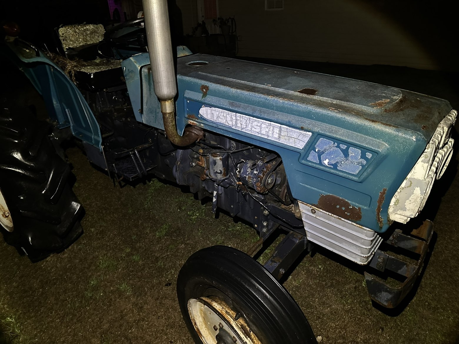

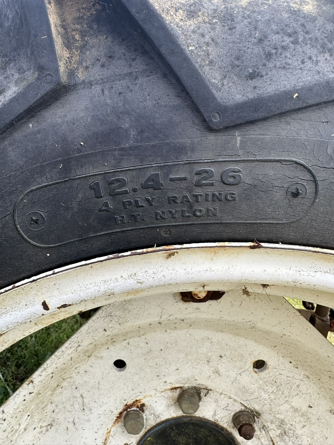

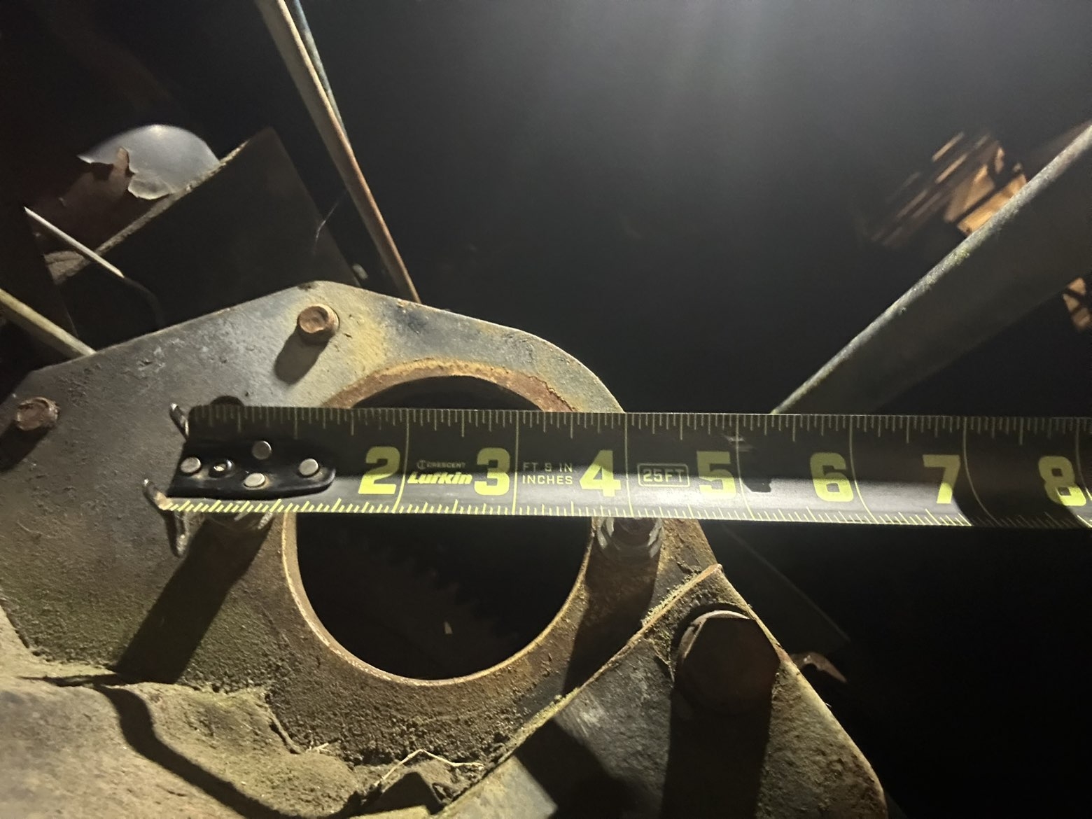

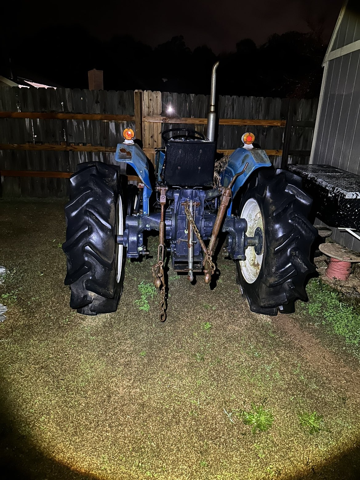

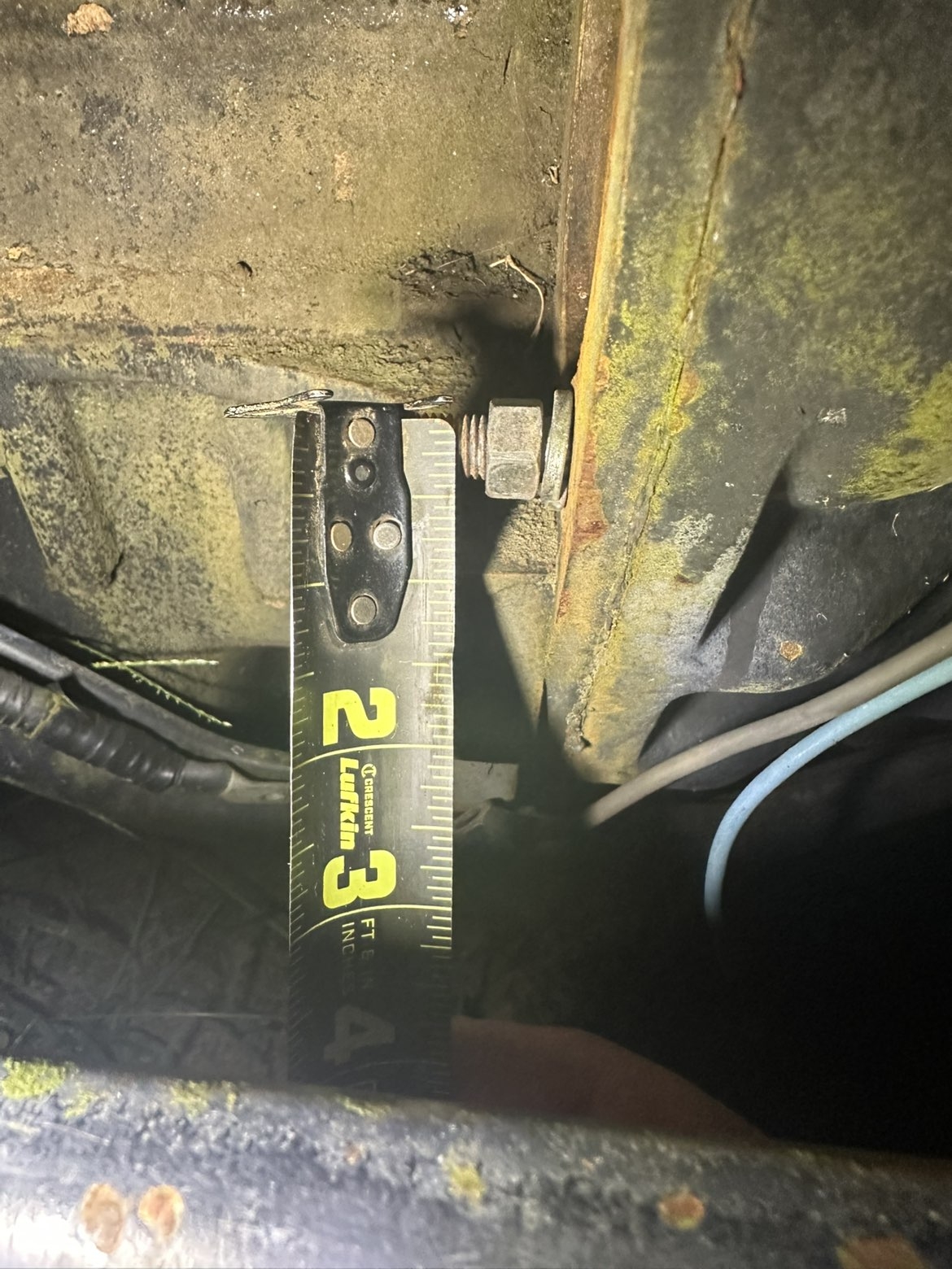

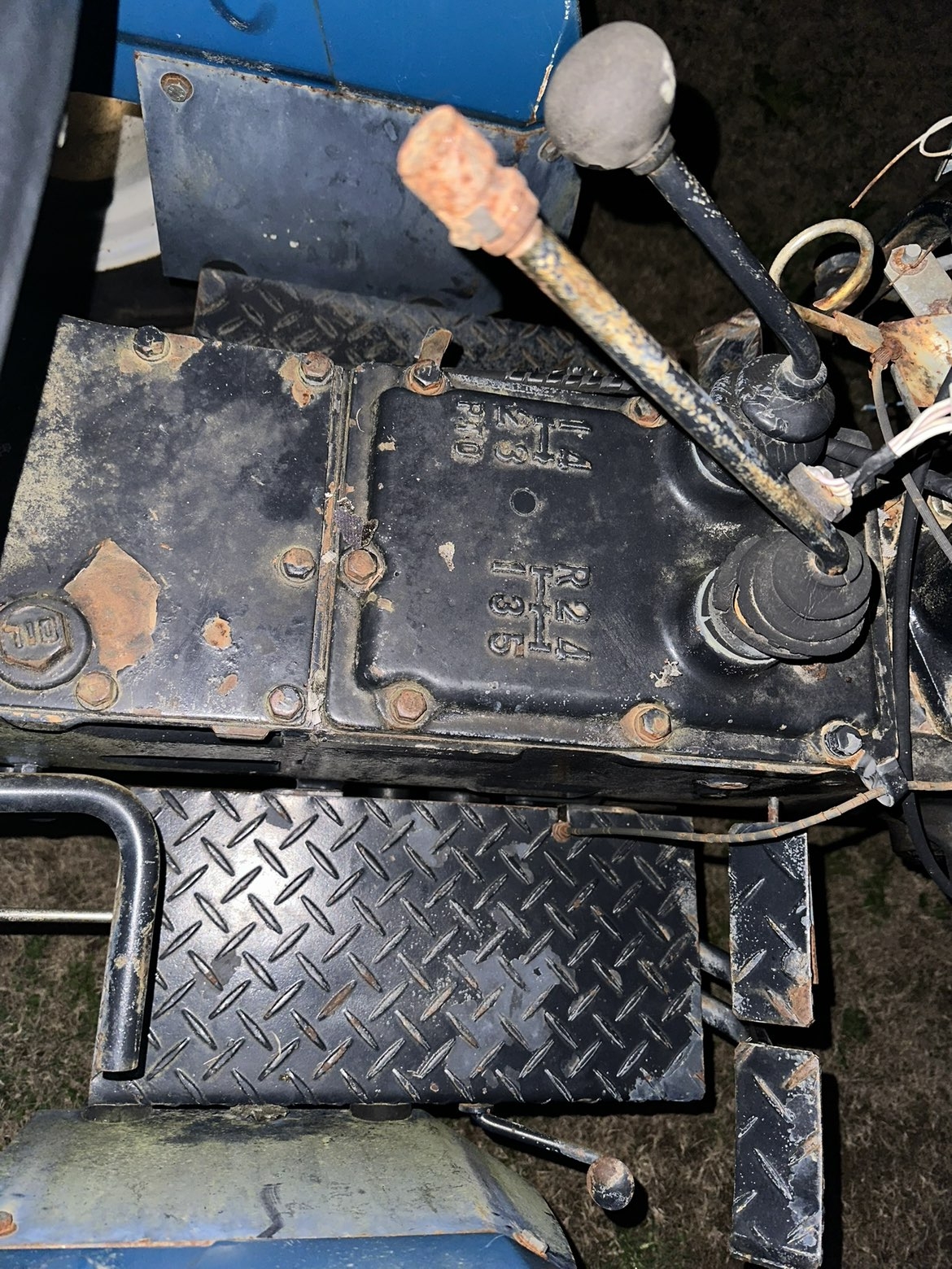

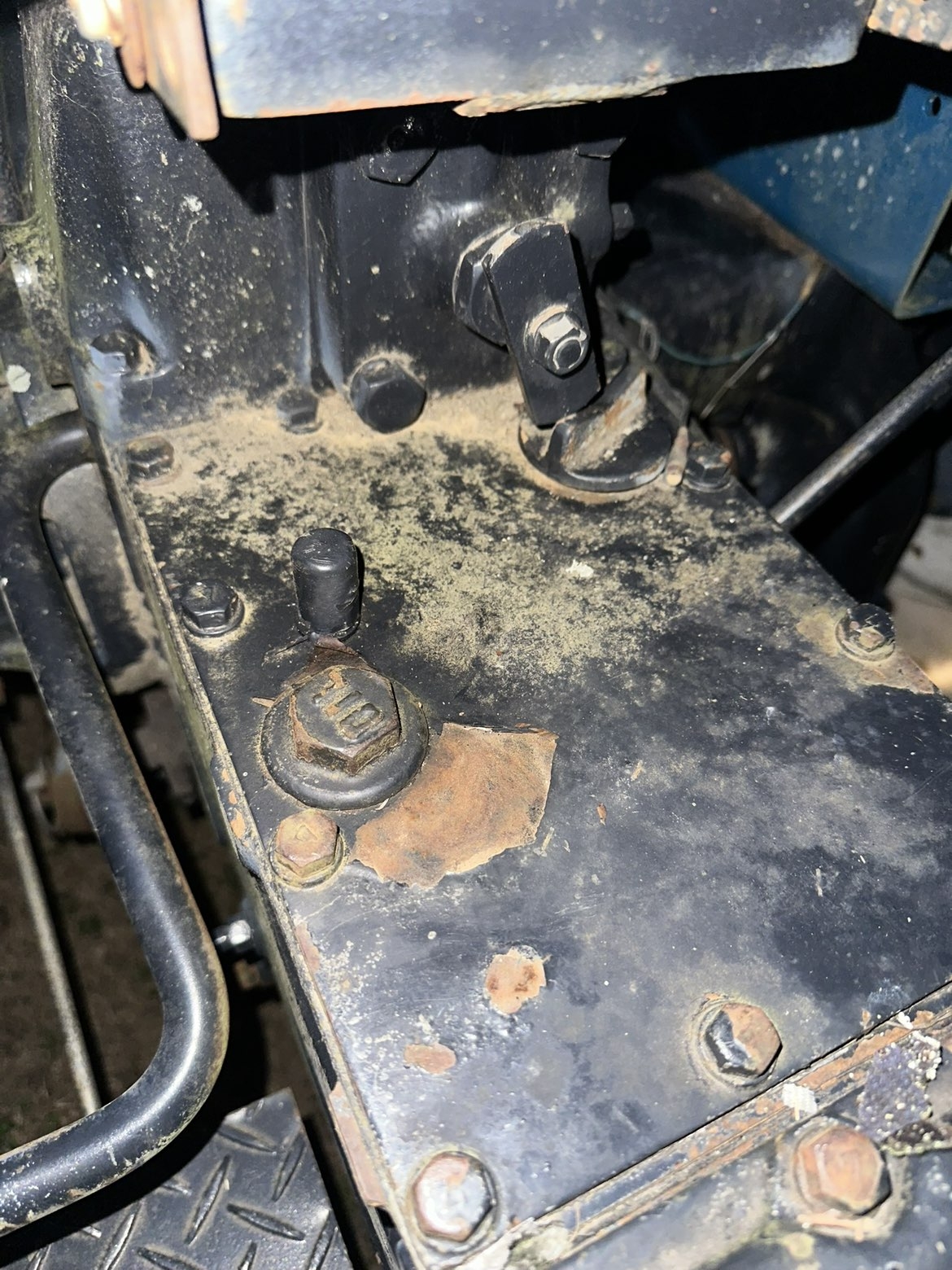

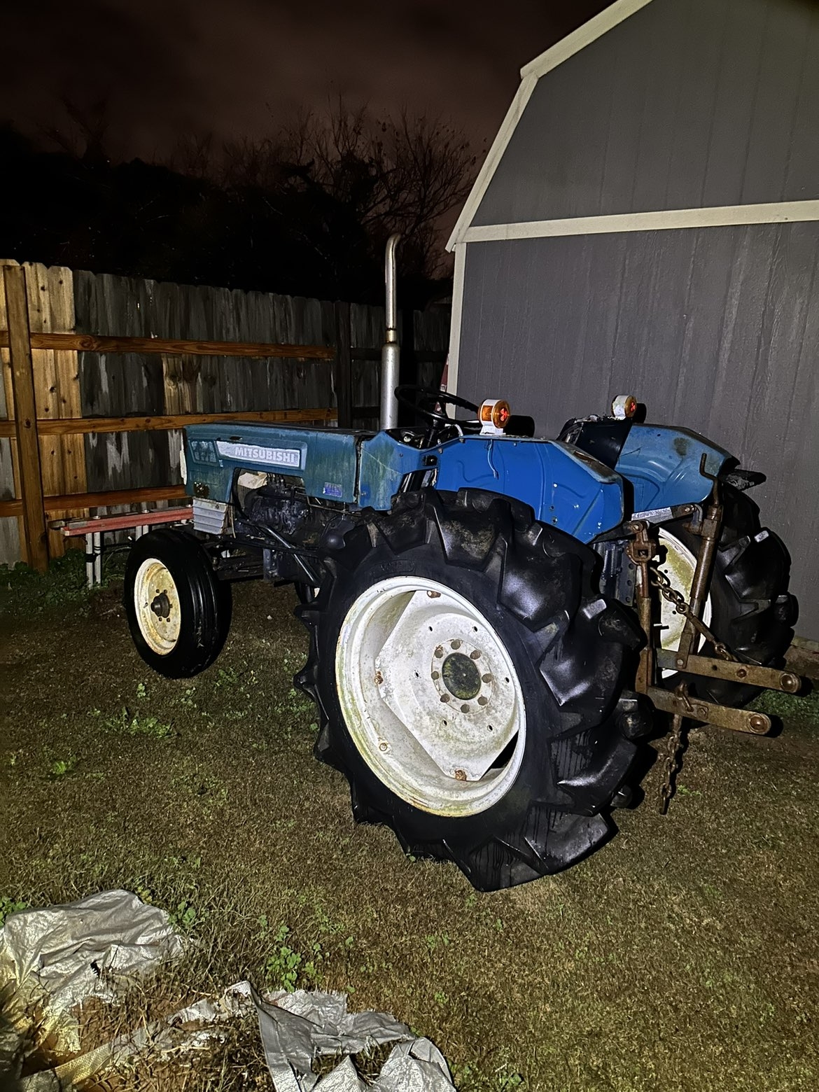

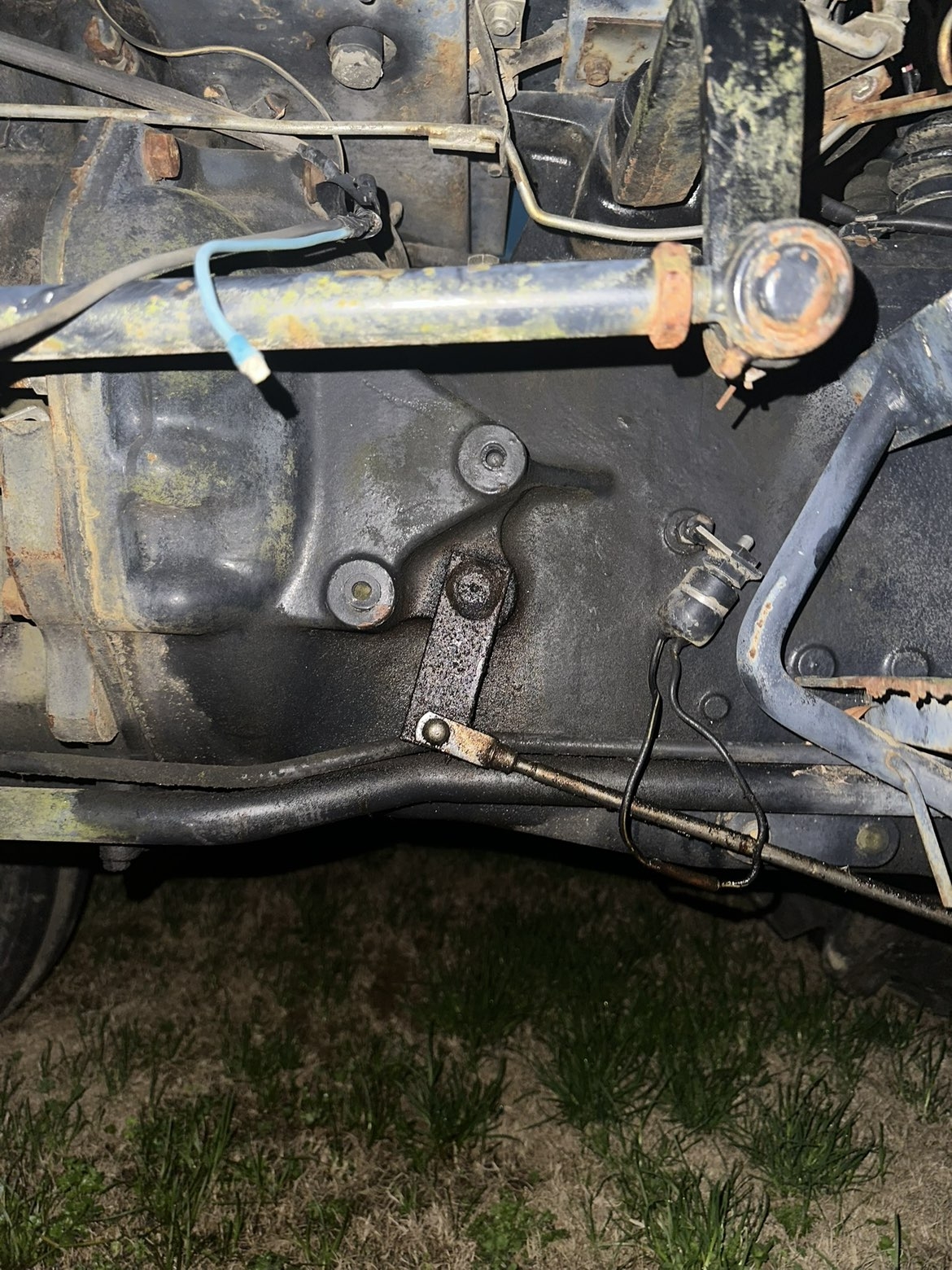

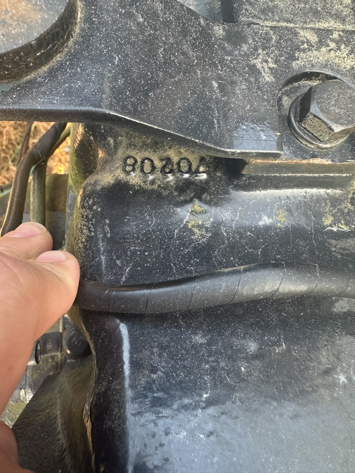

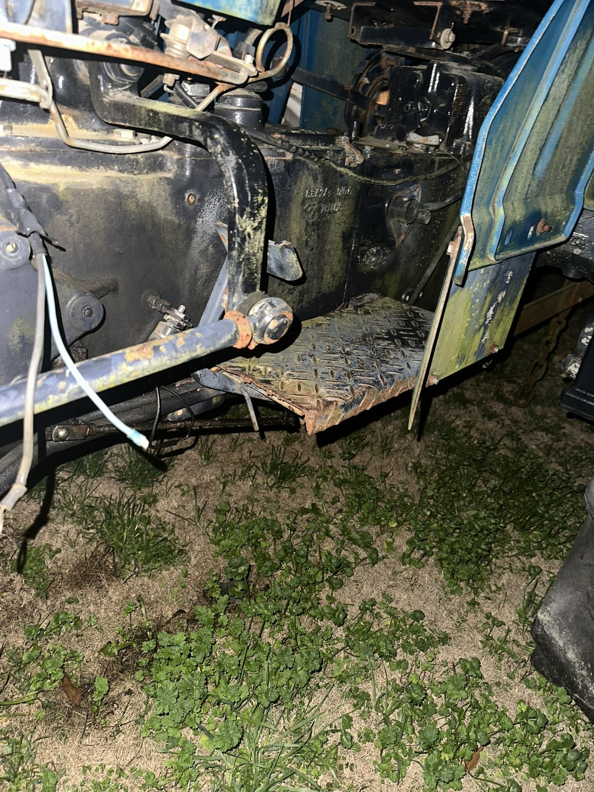

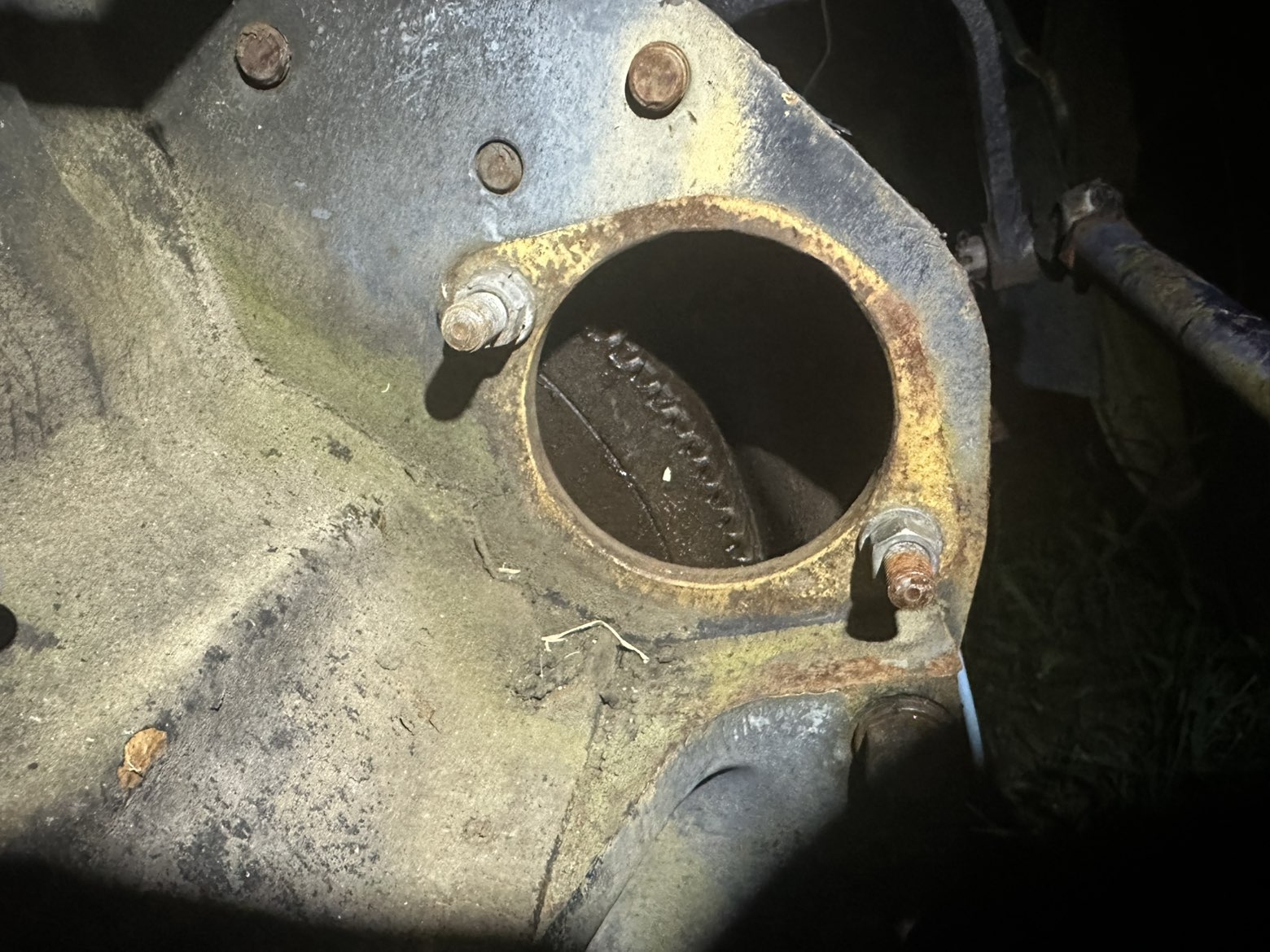

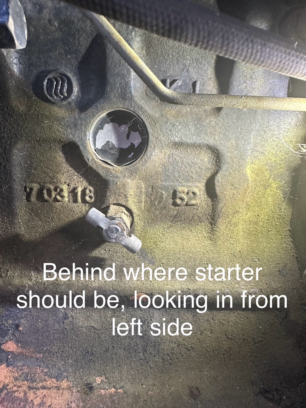

i need help identifying this tractor. its a mitsubishi
   / i need help identifying this tractor. its a mitsubishi #1
cobaltfist22
Oct 1, 2025
3
mitsubishi

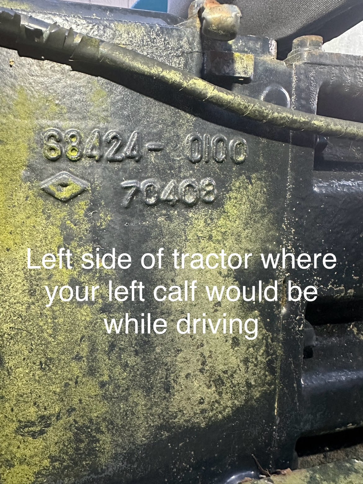

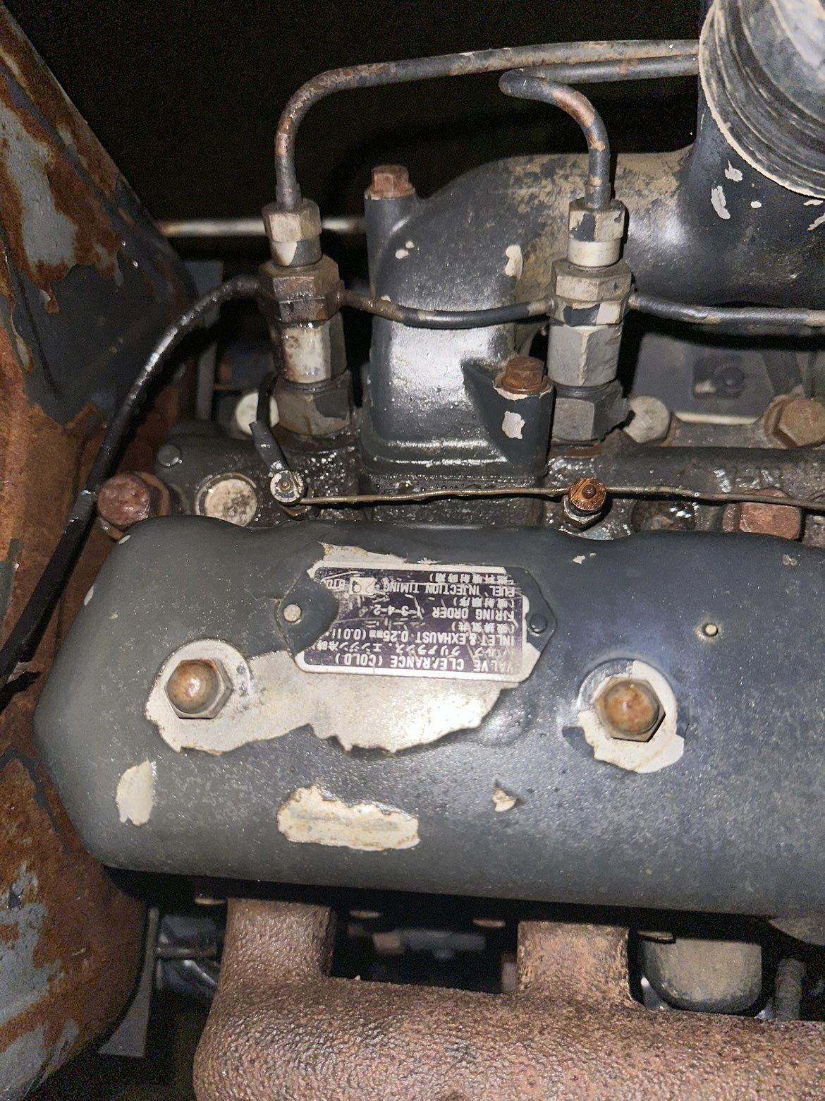

I am having trouble figuring what model mitsubishi tractor this is. I need to buy a new starter for it.

   / i need help identifying this tractor. its a mitsubishi #2

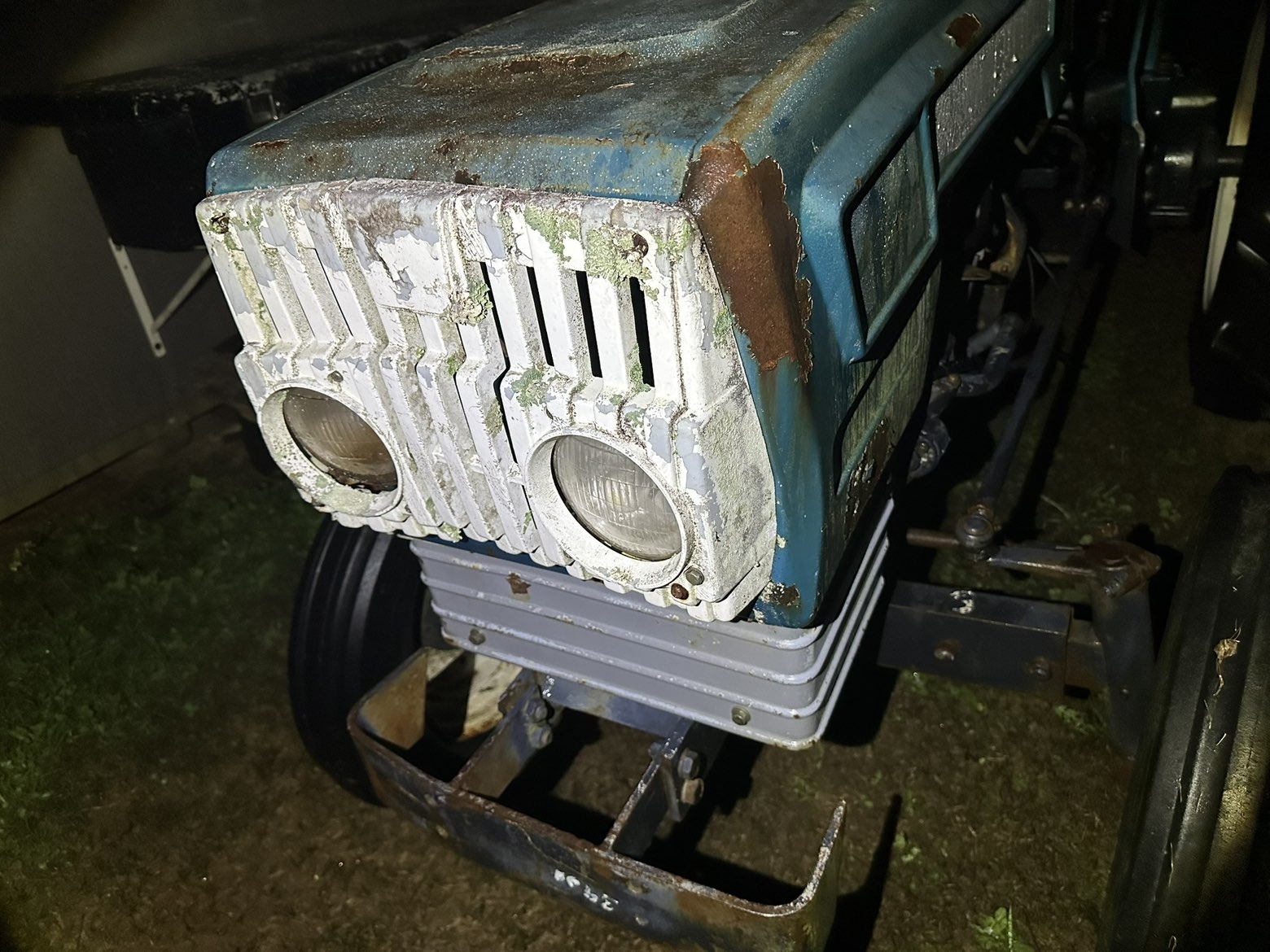

Its the old blue. R series or D series.
   / i need help identifying this tractor. its a mitsubishi #3
   / i need help identifying this tractor. its a mitsubishi #4

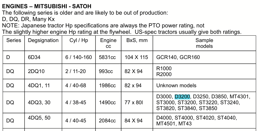

Compare other models on this sheet. It could narrow in on exactly what you have vs guessing.
BTW, this is pinned at the top of this section in the forum too.
   / i need help identifying this tractor. its a mitsubishi #5
If you have a local starter - alternator repair facility take the starter to them. My local repair shop located a new starter for my Mitsubishi D2350 and I had it within a week. The same starter is used on different models and even different brands of Japanese tractors. Mitsubishi didn't make the starter, just the tractor.

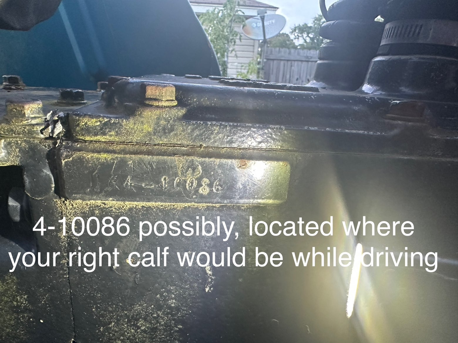

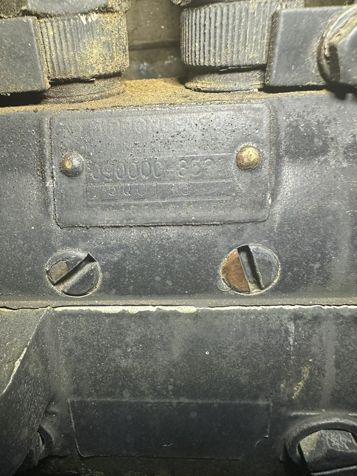

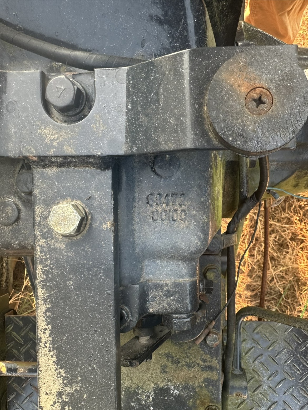

ya i have looked at that i think it has the same motor as that one i also have these 2 other picture of numbers i found.

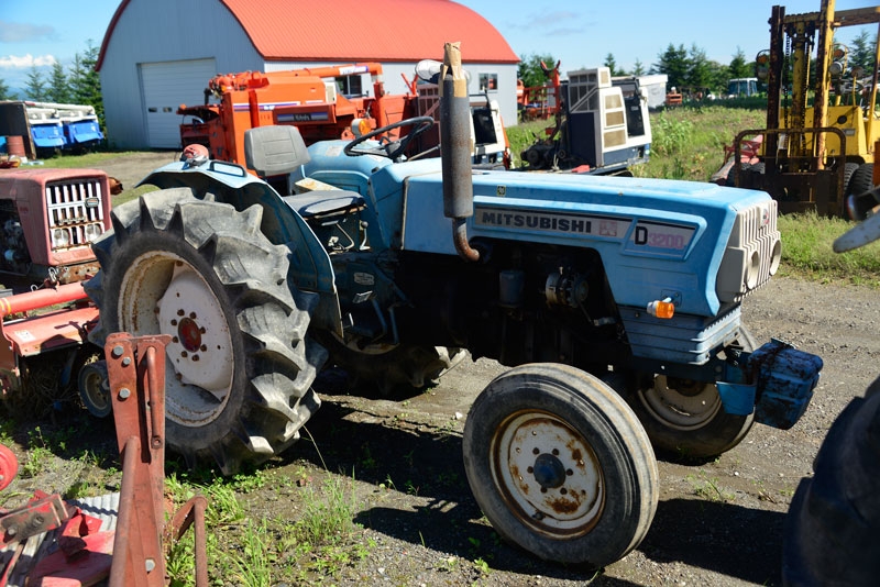

I got this information from a video my friend found the tractor looks exactly like mine to the tee and it's of one in japan

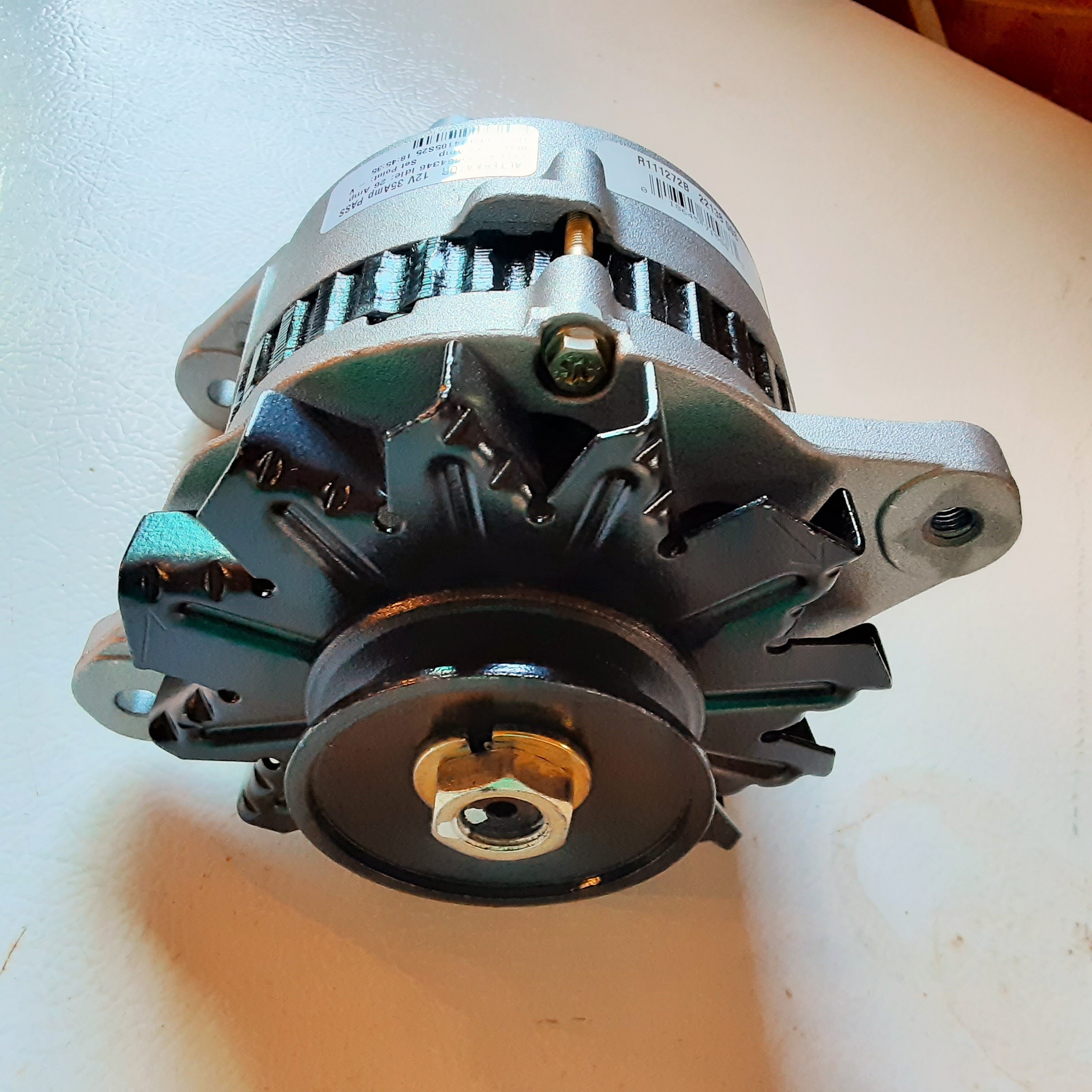

They should of came with OE Mitsubishi starters . . .
Starters – Diamond-Gard
Diamond-Gard – Heavy Duty Starters and Alternators
The tractors came with Mitsubishi alternators too.
Nice, that's the same one I posted here, the D3200.
