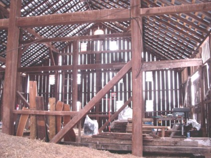

Old bank barns were designed for square bales & air flow.. though you don't need anything that big.. thought it might be interesting to show a couple pictures.

Another..

Thats a beaut of a barn. If it is like the barns here, they would have put all the siding up tight and green off the sawmill and let teh drying shrinkage create the air gaps.
   / I need help designing a hay shed #8
Thankyou.. and yep.. green oak boards.. I think a couple "way up high" boards will need replacing soon. The pictures are from when I first moved on the farm.. now 1/3 of the barn is filled w/ alfalfa hay & straw.. hay equipment in the middle.. and 10 tons of ground corn in 100lb bags everywhere. I feed out over a ton of grain every week for the steers.. so at least I'm getting a little walking room now.
