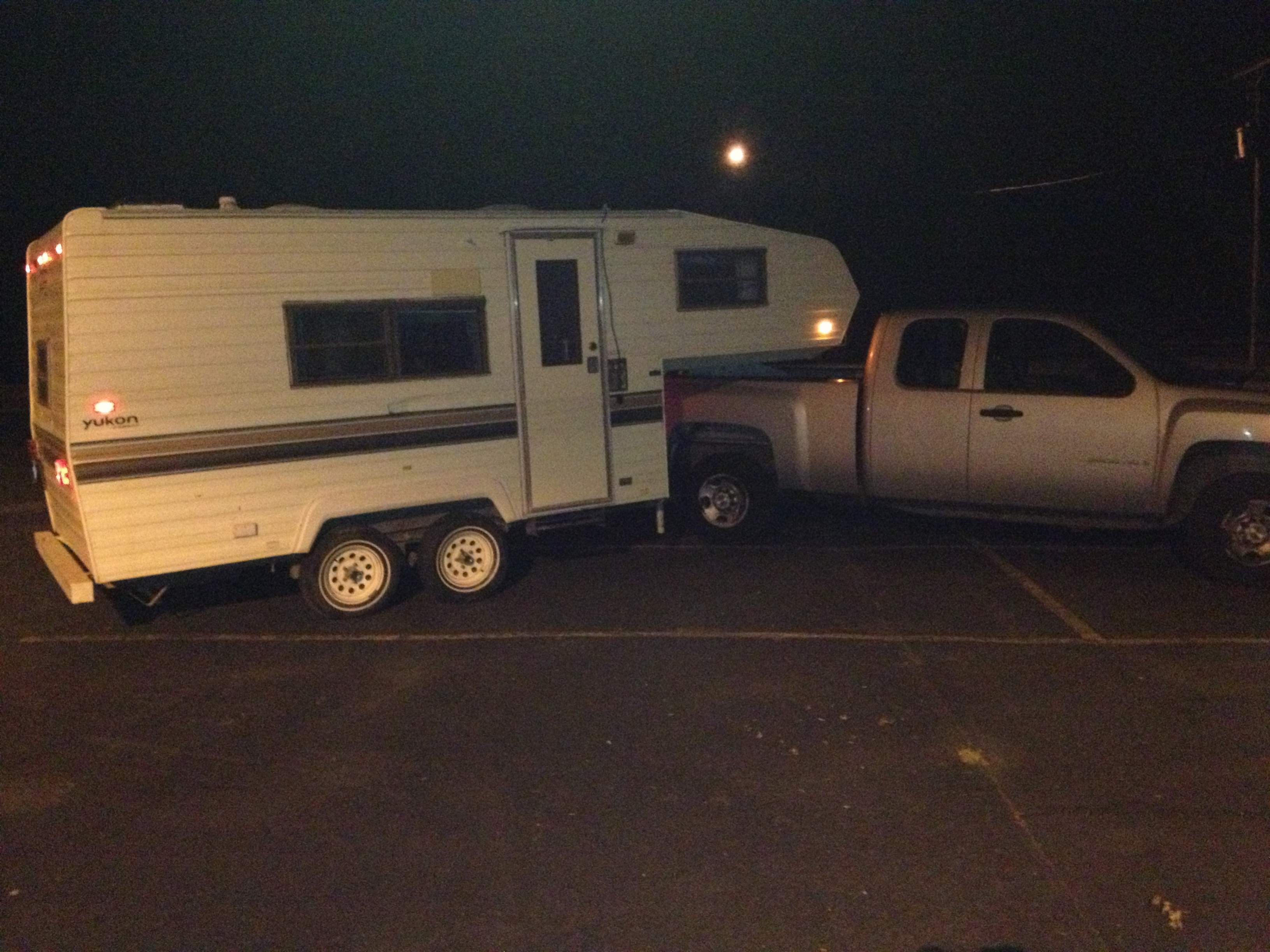

I got a hitch adapter and installed it. It is the popup RV3. I have plenty of turn radius in the truck, but it's not going to work because the camper nose is too high. The camper frame comes uncomfortably close to the bed rails of the truck. The adapter I have is adjustable, and I have plenty of room to increase the height of the hitch. The problem is that with the camper jacks maxed out even with 8" blocks under them I have less than an inch of clearance with the ball.
All this comes of buying a truck with a bed height half a foot higher than my last truck.
I could flip the axles to get more clearance and use higher blocks under the jacks, but my family has almost outgrown this camper anyway. It worked great when my kids were little.
If only money grew on trees.

That is by far the smallest 5th wheel I have ever seen.

I know. It's awesome! It was perfect for us for a long time. It fit my young family perfectly, and it was the perfect match for my half ton truck. Unfortunately both the family and the truck have outgrown the trailer. I still need to sell the old truck, and we're considering selling the camper and truck as a package deal.

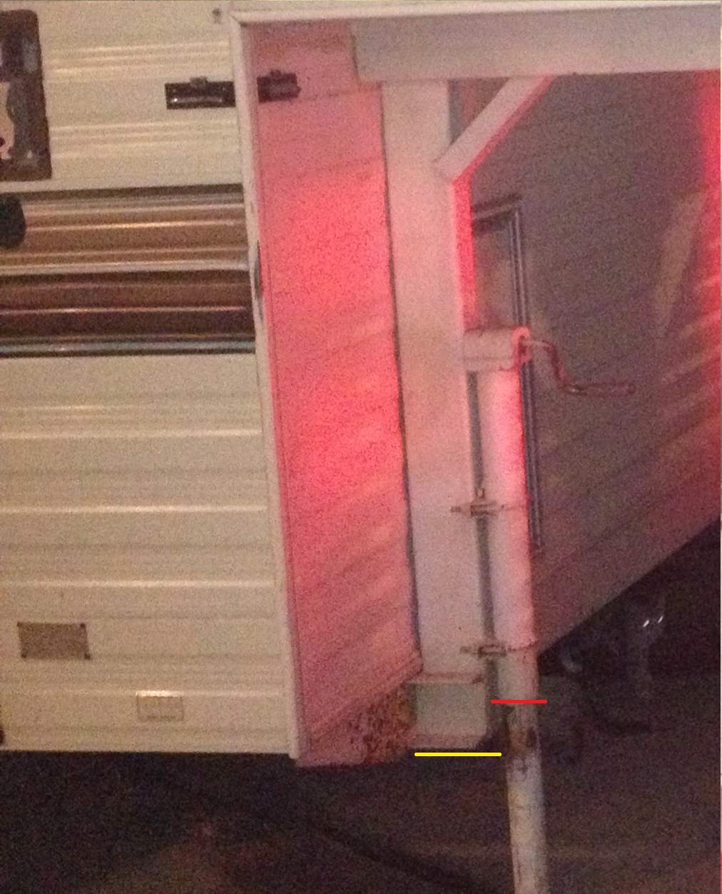

Looks like the jacks are held on with U bolts, Why not loosen them and slide the jacks down 4-5" so the fixed tube of the jack is even with the bottom of the frame ibeam (ie: so that in the attached picture, the red and yellow lines line up)?

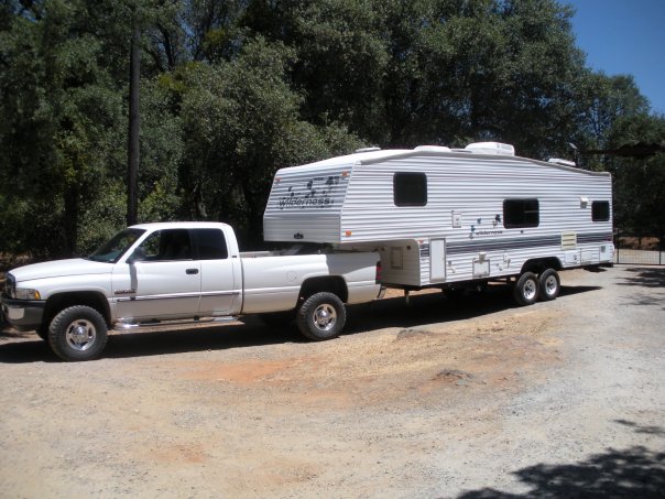

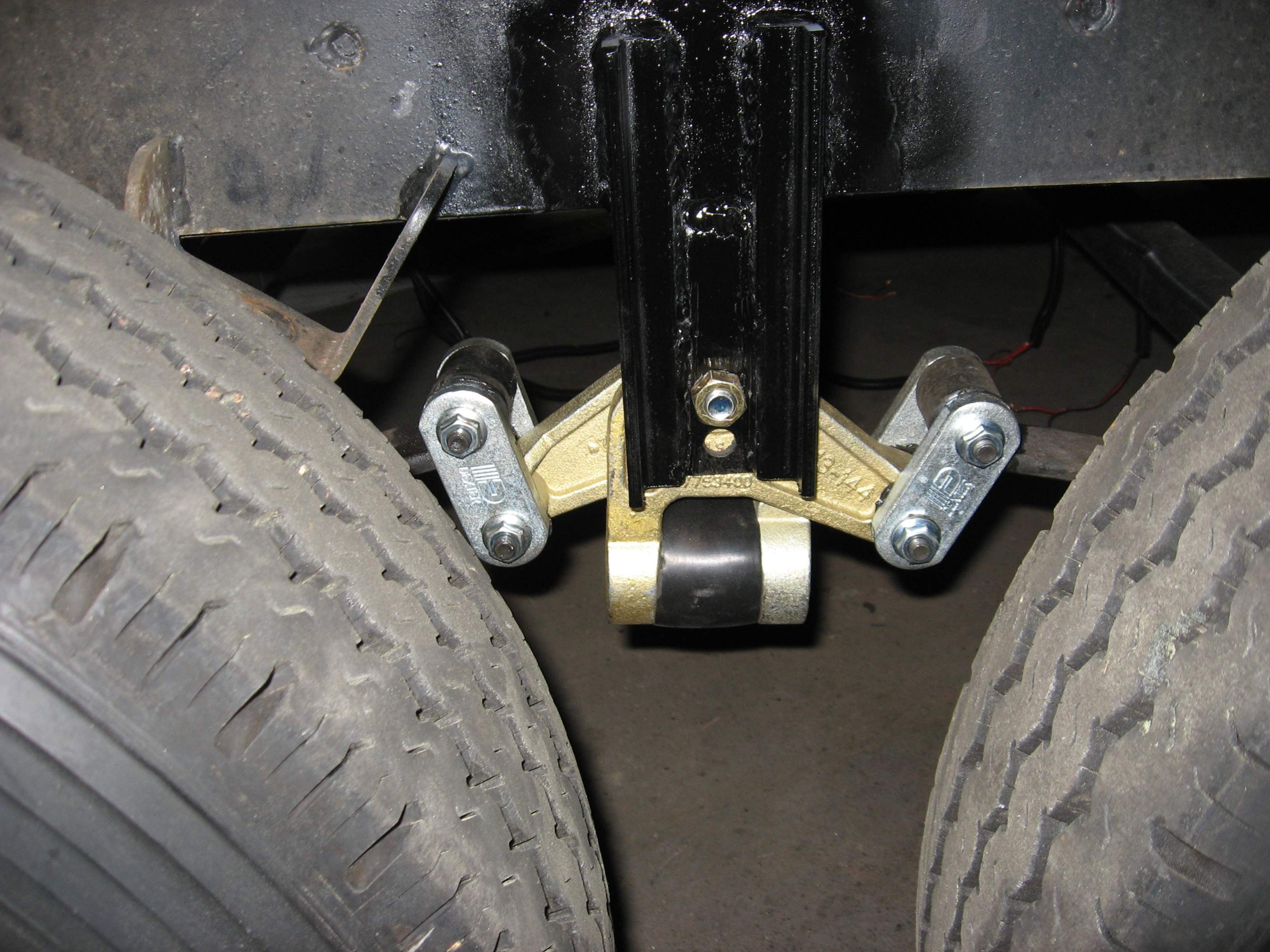

Flip the 5th wheel axles. The truck is too tall, and you can't adjust your pinbox to make up that much(on the compact 5th wheel, do you have adjustable pinbox?).
My stock Ram 2500 is tall enough, that my '98 Wilderness 5th wheel needs the flipped axles. Otherwise the back of the bed would be hitting the underside of the RV. My 5th wheel effectively has about 4" of "lift kit". It matches my truck great, but I carry 4" blocks to put under the jacks. And, the bottom step at the door is at an odd height. And, there is a large space in the wheelwells.

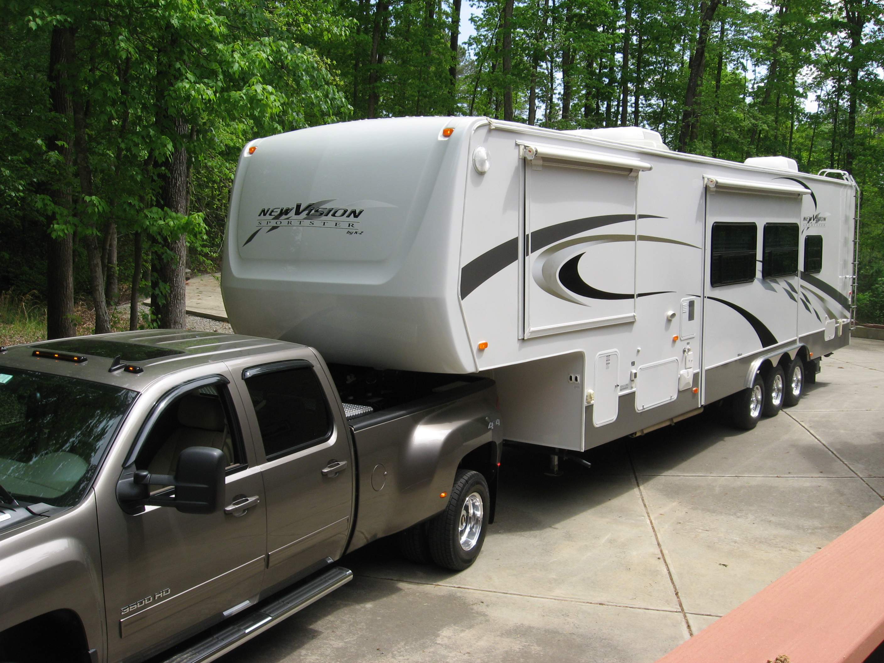

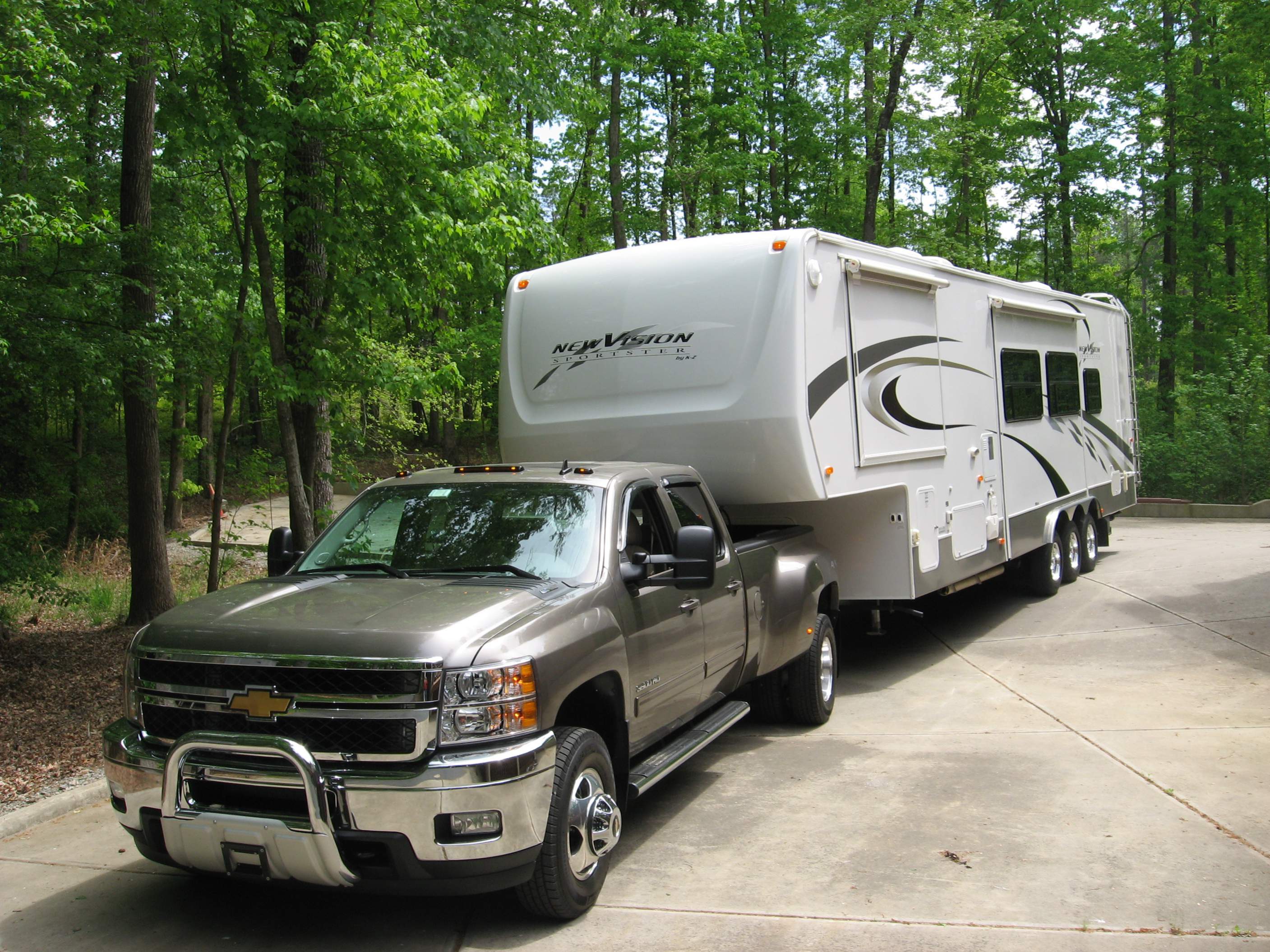

I had to do the same thing when I bought a 2013. All 3 axles on my Toy Hauler. Also had to modify front and rear steps splitting the difference between first and last step into RV. Works OK once you get used to it.camper 012.jpgcamper 001.jpgcamper 011.jpg

The jacks are tack welded in addition to the U-bolts. Taller blocks under the jacks would also meet the need.
Flip the 5th wheel axles. The truck is too tall, and you can't adjust your pinbox to make up that much(on the compact 5th wheel, do you have adjustable pinbox?)...
I do have adjustment in the pin box. I also have plenty of adjustment in the adapter, too.
I had to do the same thing when I bought a 2013. All 3 axles on my Toy Hauler. Also had to modify front and rear steps splitting the difference between first and last step into RV. Works OK once you get used to it.View attachment 336422View attachment 336423View attachment 336424
Thanks all for the suggestions. There are a lot of people around here driving RV's with flipped axles. If this camper were still the perfect fit for my family, I would flip the axles and not look back. As it is we are growing out of it. My kids are no longer toddlers and infants. We've been considering an upgrade, and this is a good opportunity. Not only would the family be more comfortable in a bigger camper, but I have a big enough truck now to be comfortable pulling a bigger camper.
