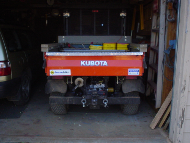

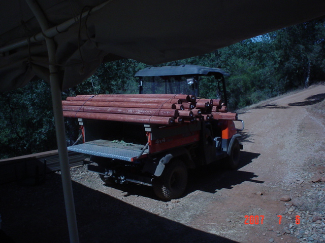

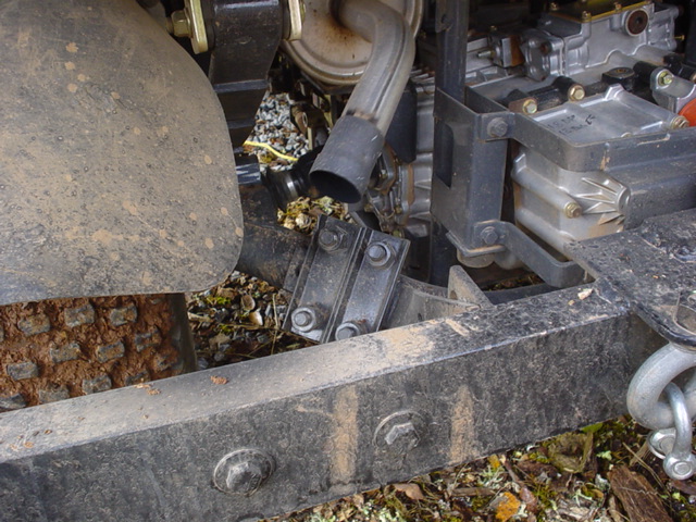

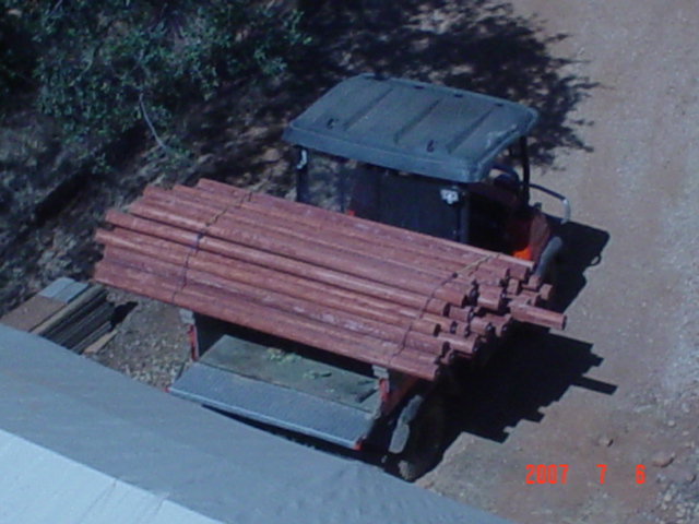

Sorry don't have a spare tailgate but what happened to you points up a weakness in the rtv bed design. If you just replace the gate and dont add a rear bumper or other means to keep the gate out of harms way - probably will happen again. I added a rear bumper with a quick detach feature for filter changes, replaced the cable wires with real chain and stiffened the gate with a sheet of diamond plate. MAy be cheaper in the long run to have a new gate fabbed from square tube and plate.

You did good beefing yours up. I beat out the dents and creases, so it will have to do for now, but it looks much better than before. Now, it's more cosmetic than anything else. I may opt for the diamond plate as you did to cover the lip where it's most noticeable.
