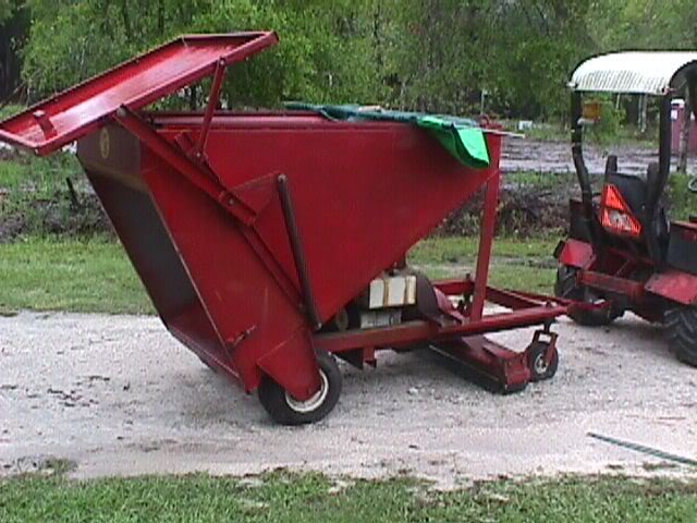

Sometimes it just isn't practical: due to various factors, my lawn (around 4 acres) wasn't cut for the first time this year until about June - the grass was over 3' tall in places.
I cut it in stages, letting the cut grass lie in the sun for around 12 to 24 hours, allowing it to dry somewhat, and reducing the weight by probably 50% to 75%.
Even so, it still took me some ungodly amount (..... 20 ? ...... 30 ? :mur:) of large TracVac loads to get it all picked up - I worked on it for around a total of 5 days, time-wise (not including time for equipment maintenance)
My TracVac is the largest trailer model that they make. The biggest problem with it, is that it is not really designed to dump - the tires keep the unit so low to the ground that you can't get enough angle on the load to make the load slide out of the cart easily - and you have to dig it out with a rake, pitchfork, etc. The unit seems to be designed for folks who might have to empty it only once.
The cat's meow is really a lawn vacuum unit that dumps it's load very easily. There are several units that are designed so that they do - they are primarily used as golf course/grounds maintenance equipment I believe.
The one I'm most familiar with is a unit that was (and is no longer) made by a company up in New England called Giant Vac ..... I believe Toro also makes a similar unit, and that there are at least one or two other companies who produce very similar equipment, but whose names escape at the moment.
Attached are a couple of pictures of the Giant Vac unit that is no longer made - there is a TBN member - sandman2234 - whose neighbor has one of these, that he was looking to sell. I believe that the second picture is the actual unit that is available for sale. Sandman2234 seems to be fairly proficient at getting things shipped around the country, so you might wanna drop him a PM.
If I was flush, I would have grabbed it up in a heartbeat - I've been looking at and wanting one of these units for more than 25 years.
A vac unit for a rear discharge would need a wide throat/pick up area and probably would be expensive as you have found.
The unit I'm referring to has a very wide (4' or more) vacuum nozzle that rides on the ground, although it could be adapted for direct connection via a boot to a side-discharge mower deck.
