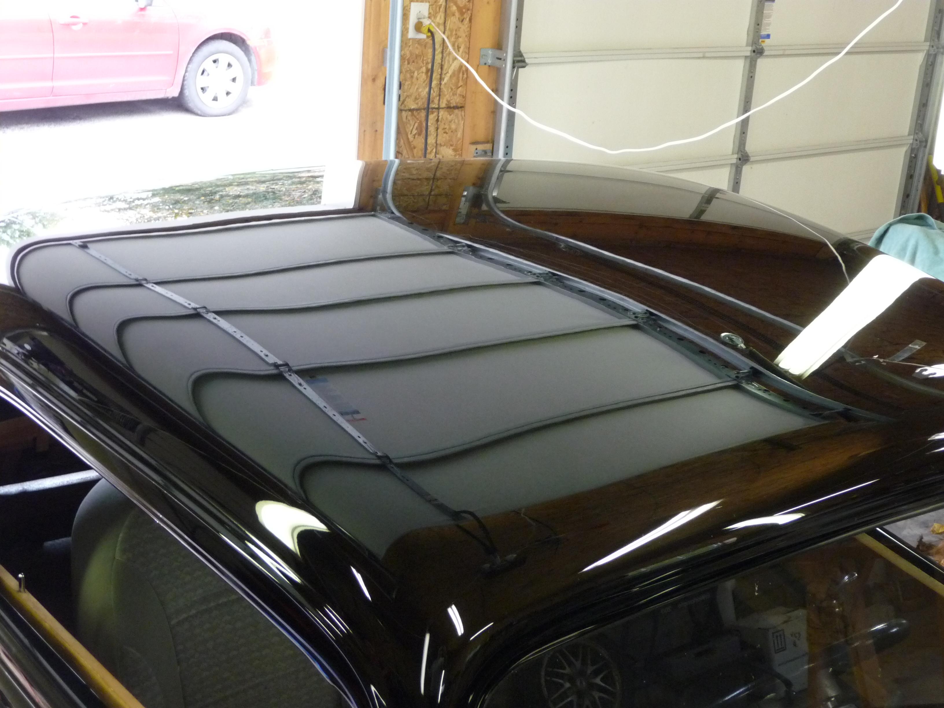

I sprayed this with my IWATA LPH-400. It is a top of the line gun, if that is what you are looking for.
