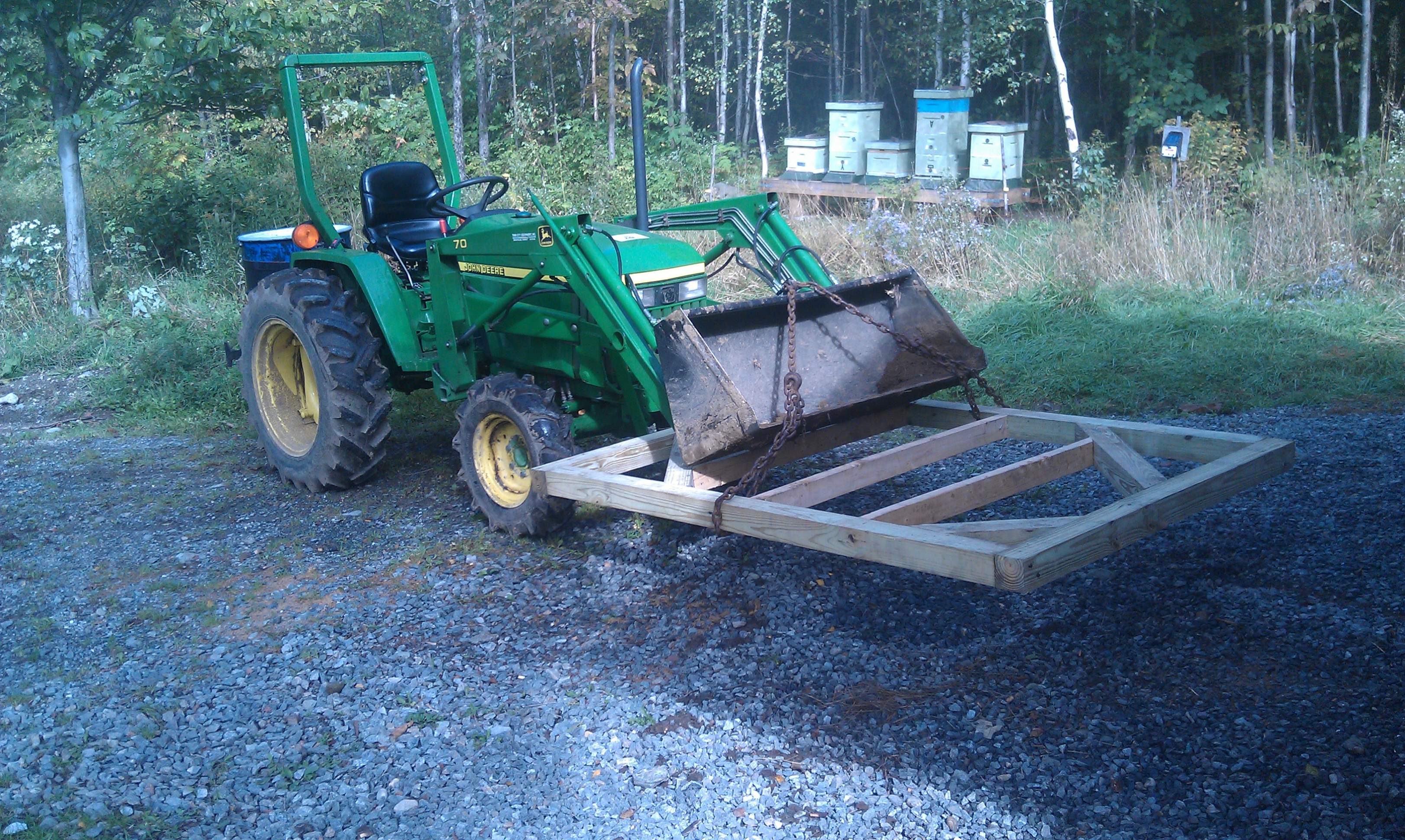

I added a pic of the current bucket....that platform i'm lifting is 5'x7'...so the bucket it probably only 48"! (i should know this from moving pallets)....

The lack of the QA isn't going to help any sales...and a 54" bucket will be for an older Deere CUT (670, x55 series, 770..) IMHO, a 61" bucket would be an easier sale.
As far as regreting selling it...that bucket size is a good fit for a lighter tractor like the 790 in digging or going into clumped up materials. A wider bucket would spread the break out force of the tractor/loader over more surface there by reducing it's effectiveness.
I had a 790 with a 419 loader and 61" bucket...worked great once I installed a tooth bar and a ballast box. I wouldn't have wanted a bigger bucket.
My 4400 (30 PTO HP and about 1000 lbs heavier) also has a 61" bucket...and I still wouldn't want anything bigger.
BTW, have you considered using a loader mounted plow or a 72" rear blade for snow removal?

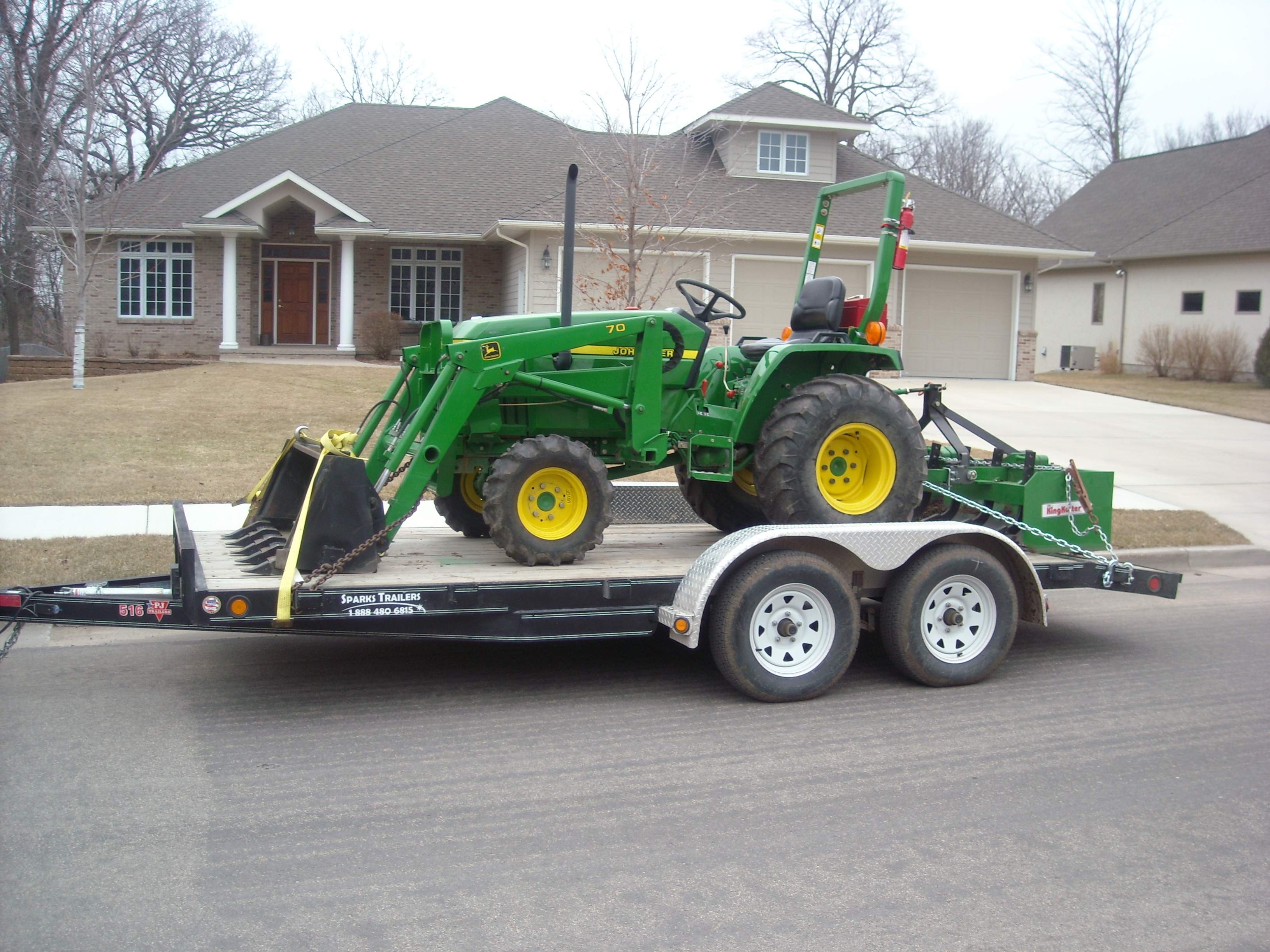

I owned a 790 with a 70 loader. It had a 54" bucket and I put a tooth bar on it. For working in dirt I think it was the optimal size for this tractor/loader combo.
If I wanted something larger for snow, I'd look for a blade, snow blower, small pusher or bucket extensions. Here's my old 790.
