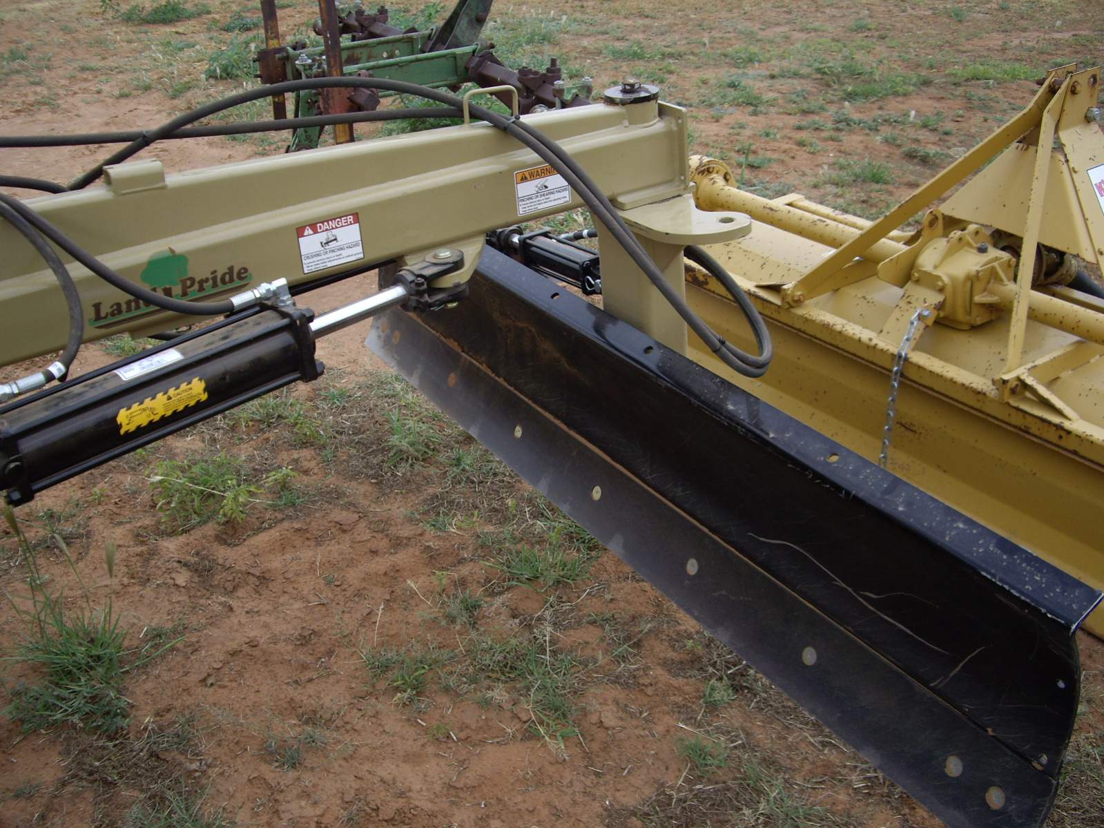

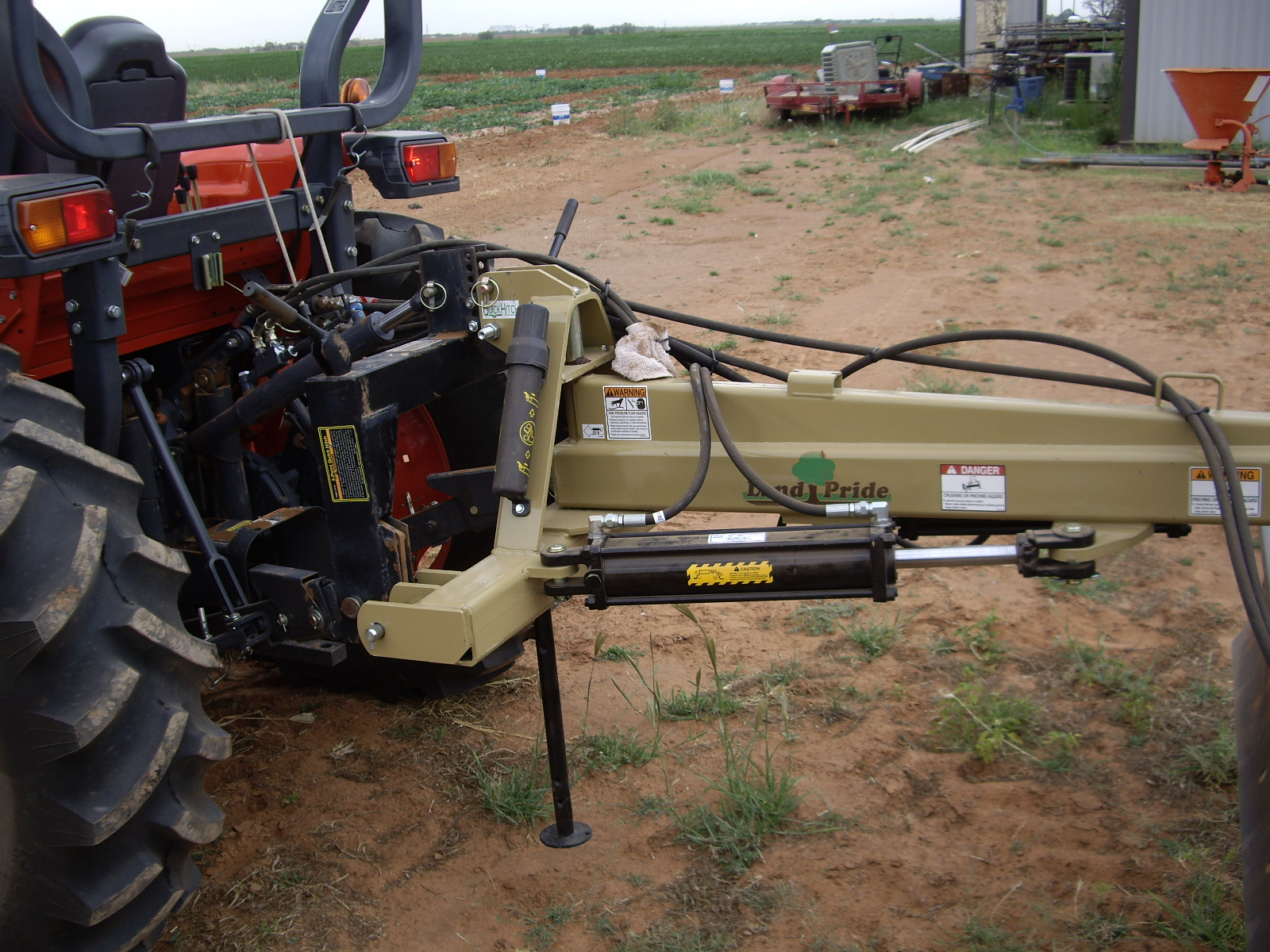

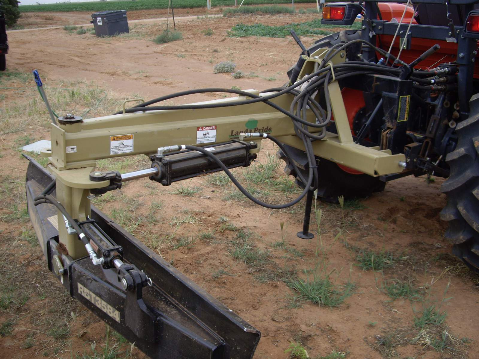

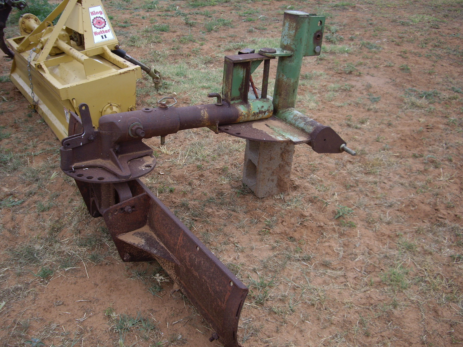

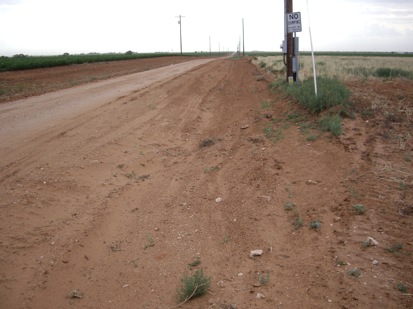

I finally ran out of things to do with the blade. It's been on the tractor since I got it and I need to hook up to the flail. :( So I took a few pics for you guys
new blade 001.jpgnew blade 002.jpgnew blade 003.jpgnew blade 004.jpgnew blade 005.jpg
Three pictures of the blade, a picture of the ditch I cleaned out and a picture of the old blade I struggled with.

Now that's a SERIOUS blade hanging off the back there, but...... how in the world could you have done any work with it??? Those tires look BRAND NEW, you can still see the webbing between the lugs!!! :laughing: JK'ing there.

Great blade. I have the same one and have found the skid shoes to be very helpful as well.

Very nice set up the Hydraulics make all the difference I sure like mine. Great pictures. Good luck.

You might want to turn the 90s on the swing and angle cylinders to point rearward then run the hoses on top of the main beam. Looks like you have enough hose to do that and would make a cleaner setup.

As far as the hoses, yes they are a mess but I can't turn the fittings unless I back them out. I was able to turn one fitting on the swing cylinder to the center and made that side a bit better. The others are bottomed out. I AM addressing that, one solution is new fittings and another is to have the hoses remade to the correct length. They are all the same and are what Land Pride provides.
Hmm funny you should bring up something about "neat" ing up the hoses. After all, It is just a rear blade. Now, where did I leave my MeGuire's polish and wax. ;)
