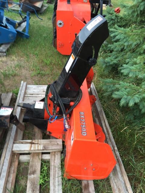

Good evening everyone,
I must be missing winter because I just found and bought a like new Kubota BX2750D snowblower with hydraulic chute to mate to my 1710.
Dare I say that the 96 degree days have me wishing for cooler temps..... :eek:
On a parts and retrofit note I talked with RADTECH in canada and they said that I need to change these blower parts out to match my tractor's mid mount pto. I called my dealer and the below items are about $200 shipped.
4263533M1 - Sprocket40B26
4263532M91 - Drive shaft with sprocket 40C12
4263535M91 - Chain #40 x 34 links
I also will need the subframe and mid pto shaft which is another $700 or so.
Finally I also want the electronic chute deflector and refuse to pay the $500+ for the kit from massey - so I found a slightly used Firgilli FA-150-A-12-6 actuator on ebay for $45 and a momentary led switch for $12 to complete that setup.
All in all I'll be into the snowblower for about $2900, which is about $1850 less than I was quoted for new one out the door. I'll keep everyone posted as winter approaches and I get things retrofitted.
Question, does anyone know what I need to change the chute hydraulic connections out to in order tomake them work with MF?
Oh, i'm also planning on adding UHMW to my chute to ease clogging and maximize throw distance. More to come on that as well.

JWR- I talked with RADTECH before proceeding, the kubota 2750D and MF2360 are identical other than paint - there will be zero custom fabrication. There are also multiple other folks who have done this same project on various forums (including here).
The P/Ns in my post were what RADTECH gave me to retrofit the blower for the MF PTO speeds. Once i buy the MF subframe (with hydraulic lift) and the pto shaft adapter from MF I'll have a functional mate to my GC1710 (other than the hydraulic fitting changeout for the chute rotator). My tractor is a TLB so the joystick controls for the bucket will control the chute and blower lift mechanism.
