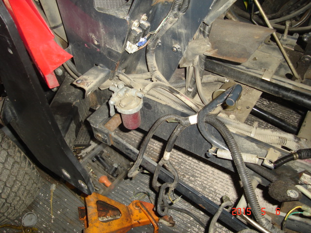

2. Kevin, I stopped by today to look at it and it was all apart, but the fellow wasn't there so I couldn't talk to him. Seems like he'll probably have it done in a day or so, unless he's run into something that wasn't anticipated.

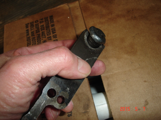

Here's some pics (last pic is the actual transmission cover, from which the offending 4WD lever was removed):

The jury's in, and the verdict: the break in the 4WD control lever is precisely what I had imagined. A poor weld (lack of heat penetration) coupled with frequent use, and it was just waiting to snap. Looking at the weld, it appears that part of the break was old (shiny, worn: upper left) and part of the break looks fresh (crystalline structure still visible). I think that lever was ready to break off for quite some time by the looks of it. New part's weld looks much better.
Tractor is now being reassembled, so hopefully I'll get it back soon! :cool2:

Oops-- here's the new 4WD control lever; weld looks much heavier here.
