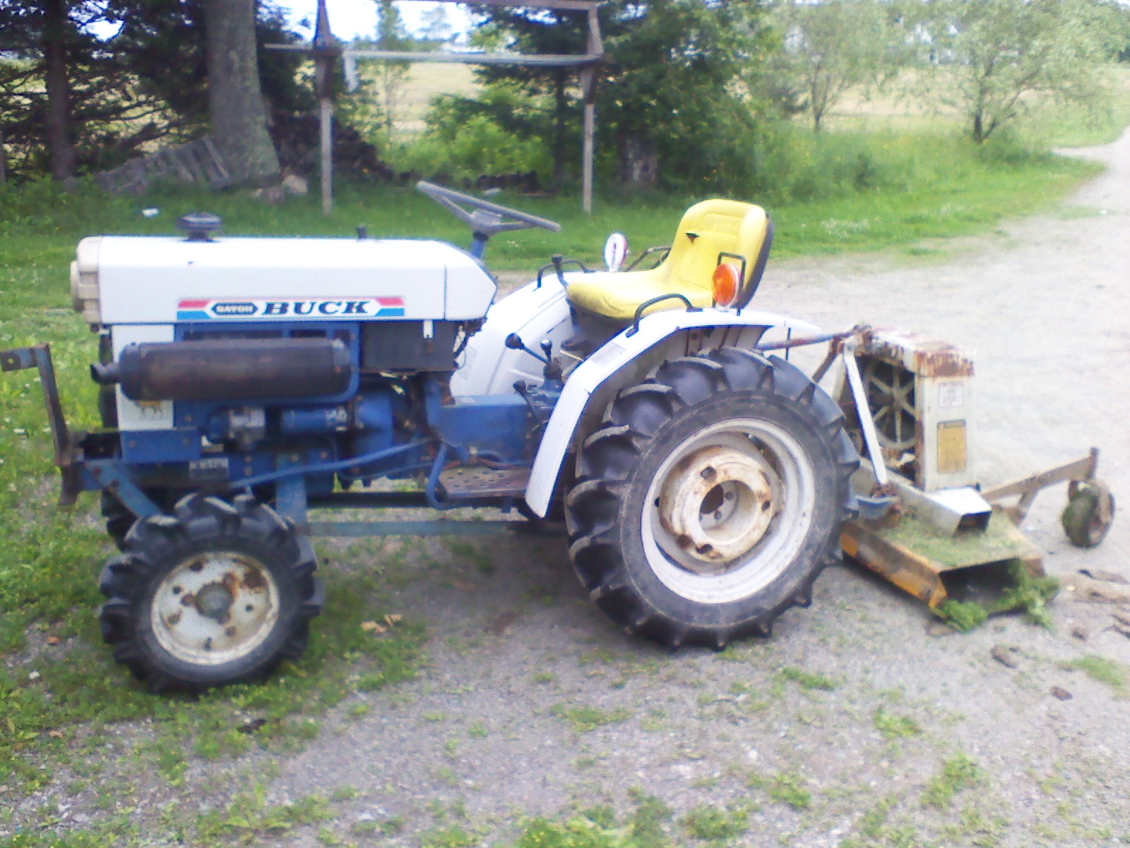

I am the proud owner of a 1979 Satoh Buck, with a 48" Woods mower,
front plow, Land plow (rear), and a rear 3 pt hitch platform for carrying items around.:thumbsup:
I was on the fence, until I heard it run.. super smooth.. and the mower is VERY quiet.. I like it.
I've mowed some.. I seems to like being in 1st gear, with the PTO on 2.
If I put the PTO on 3, its bogs the tractor a little.
Anyway, I'm sure I'll MANY more questions, once I really get into it..
Like, the engine heater, I don't get it.! lol but I have the book, i will read.
Thanks again Guys.

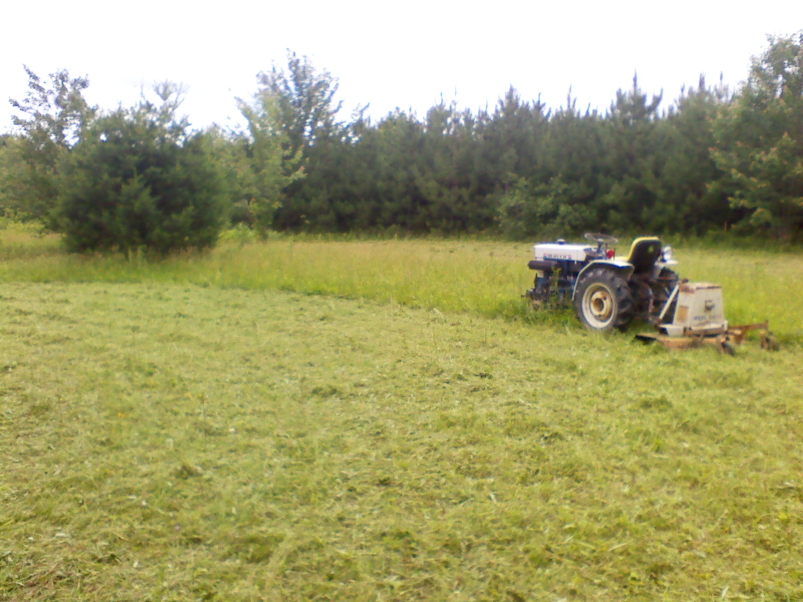

The field I was "mowing" the very next day after I brought it home.
:D

There is a post here that says the PTO speeds for the Buck are 565, 832, and 1000 RPM at 2700 engine RPM. It is very likely that your Woods mower is rated for 540 RPM at the input shaft, which means you should run it in first gear on the PTO.
I'm sure it cuts a lot better at 832 RPM, but it's potentially extremely dangerous. Pull the blades, sharpen them, and run it in first gear. You'll probably be able to pull a gear higher on the tractor for higher groundspeed, too, but mostly it won't be dangerous or hard on your equipment.
WOW.. Thanks 284...
I wouldn't have guessed it would be dangerous, but I guess I can see why. i DID try it in PTO 3, Gear 1, and RPM at 2700.. I'm guessing thats not good at all.!! I will heade the advice, sharpen the blades, and try PTO 1, then try mowing in gear 2..
Thanks again.!

A lot of these old woods mowers were made for Satohs and Yanmars. Second is the right speed, trust me. I can find it somewhere in a manual. I still have the Buck that my Dad bought new in the late 70s with a new Woods RM 48. I have a slightly newer mower now and use it on my Mits. 1450 which is almost a Buck. This link to Woods will help. It references the Beaver mostly, which has the same pto speeds. My model number is YM-1.
