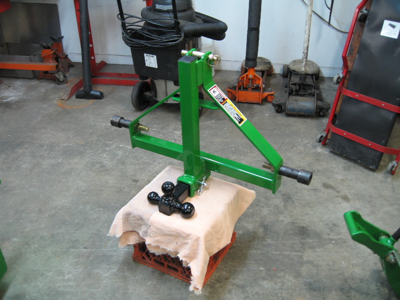

does anyone have the part number for the reciever hitch ......heres a pic I found.....:)

Not sure...I made my own.
   / I Match reciever hitch #4
You'd have to call a dealer to be sure...I am curious what they get for that myself.
   / I Match reciever hitch #5
I have the same one out in the garage. I'll check it for Part#'s today.

hey Kenny...I found this link but im not sure the part number is good......
3-point hitch tractor receiver hitch
That's the one I have. I got mine last year with my new 2520. I'm in Canada, and it cost me $250. Seems like a lot of money, but when you consider freight, I don't think I could have paid someone to make me one for much less. Especially wanting it that nice JD Green color. As I remember, these are not ordered through JD's regular parts and are sort of a "drop ship" item which come from some special warehouse. Mine also came with the bushing kit, so it will attach to my "I" match. It just uses the cheapo bushing kit, not like the one's they use on the ballast box.
I pretty much leave it attached all the time. A great place to wrap up and carry my tow chains on the tractor.

I believe I paid about the same, my dealer stocks them. If you jockey around trailers in limited space's like I do it's worth it's weight in gold.

I've been looking at this as well. Got a quote from my dealer as follows:
LP25001 3-PT RECEIVER HITCH = $145.95 CDN
LP25004 QUICK HITCH ADAPTER BUSHING KIT = $31.19 CDN
However I have also been looking at this unit which offers some unique accessories, can be ordered in JD green and is iMatch compatible:
http://omni-mfg.com/OMNI-Combo-3-point-Trailer-Hitch-P320197.aspx
