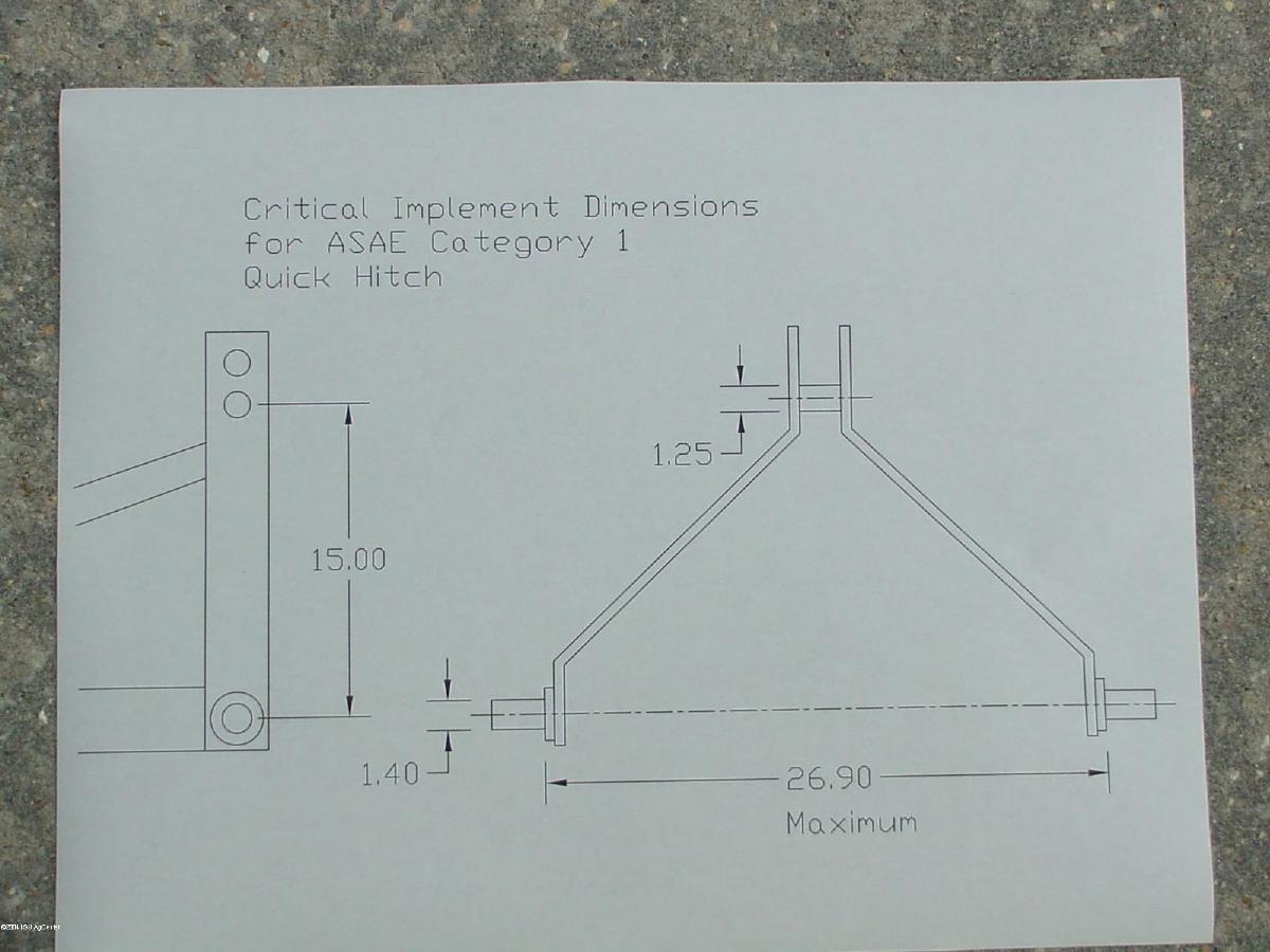

I am looking for the dimension on an I-Match hitch. I am going to set up my bagger for the 955, I need the width and height between the hooks. I have ordered it, but don't have one yet. Nobody stocks them here in NC!

I found the ASAE standard dimensions for the quick hitch and downloaded a copy, attached.

I may be mistaken but I thought JD changed the dimensions of the I-Match so only their implements would fit.
   / I-Match Dimensions #4
Deere is using the ASAE standard. Many implement manufacturers do not have three-point hitches compatible with the ASAE standard. When I bought the Land Pride quick hitch a number of years ago, not all of Land Pride's own implements were compatible.

I have a JD Cat 2 Quick Hitch. It is 32 3/4 inches inside to inside and the top link is 15 inches high. I have a Speeco Cat 1 Quick Hitch and it fits my I-match MX6 cutter.
