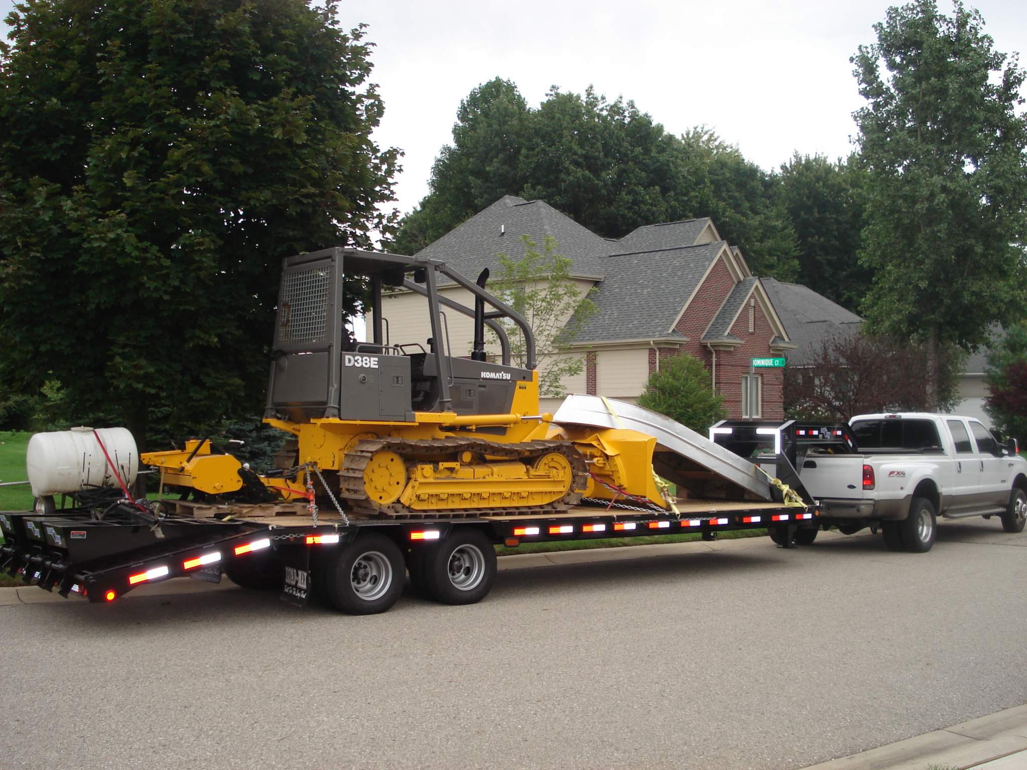

I decided to start a new thread, about my search for the perfect trailer for my needs. I had asked previously about the best deal on a gooseneck trailer, and also got a lot of advice. It boils down to this. I need a trailer that is big enough to move a full sized backhoe, from time to time, and possibly a small dozer, both around 15000 pounds max. I am putting a deposit down next week, and I am trying to decide between a 19+5 triaxel 21000 gvw, and a 24+5 tandem dually 24000 pounds. I know I should go for the bigger trailer,just for the one time I need it, and I know I'll need it. The difference on price is only $1100, and for that, the bigger trailer comes with two 12000 pound jacks, and a full size spring assisted ramp. I want some opinions, I do not do a lot of trailering, maybe 8-10 times a year, but I am moving an 8000 pound tlb etc, and I am looking for a dozer, and full size back hoe, Case 580 etc. My truck is a ford super duty f250, with a v10. I usually do not go to far, 30 miles tops.

As an ex owner operator of tractor trailers, my personal choice would be the dually tandem. Both for the added legal weight and more so,, a dually tired trailer will "follow" the path much, much easier than a single tire axle times three axles,, With the tri axle, at every turn, you will be scuffing the tires and prematurely be wearing them out and very quickly I may add..

I had a 25' tandem GN that was rated at 25,000#. It would have done what you wanted but weighed almost 6,000# empty. While I love the Fords I really think you are going to find out you need a bigger truck. A F-350 dually with the V-10 will do the job.
I was in the same situation as you back in 04. I had a spanking new F-250 Diesel 4x4 and a 10,000# boat. We had a baby and the wife said we need a boat with heat and AC if I wanted to continue living on the boat 3 nights a week like we were. So late that season I bought a new boat that weighed 15,600# and the F-250 was just not enough. I then bought a SRW Dmax 3500 1 ton 4x4 and it was not enough plus had tons of issues so 9 months later got a new 2006 F-350 and it will handle this load and more. I have towed 25,000# 8 or so times with it 30 miles each way with no issues.

In this case I think the bigger issue is the choice of GN over a tag trailer. I recall the rule of thumb on a GN is 20% of loded trailer weight on the pin. In your examples you will be looking at between 4K and almost 5K of weight sitting in your bed. Even with bags, Timbrens, whatever you can't stick 5K pounds over the rear axle of an F250 (unless I am missing something)

I was in a similar situation a while back, debating between a tri-axle and a dually. Ran a thread, tri-axle vs dually tandem, and ended up with a Load-Max tandem dually with 12K axles, absolutely love it. However, am pulling it with the F-350 diesel. Pulled this load 400+ miles, the truck and trailer did great.
good luck!
Just to stick something out there, we did put 4.5k in the bed of a stock Chevy 2500 extended cab, long bed, 4x4. Only things not stock is the tires. You definitely knew it was back there, especially since we don't have a diesel, (we have a 6.0l V8), but it did handle ok. We don't have any helper springs.
