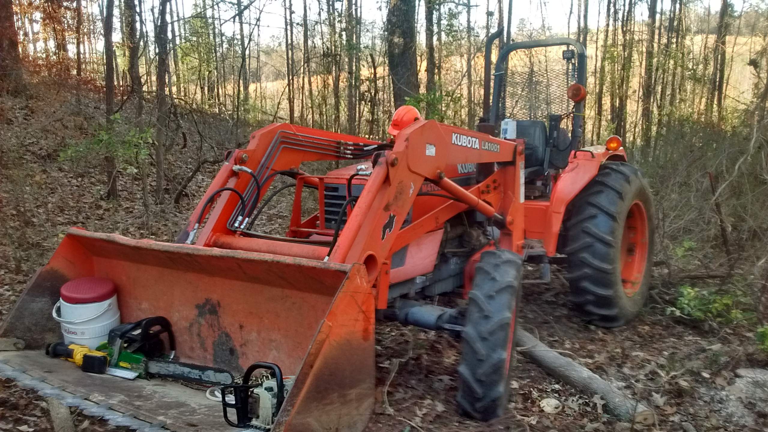

I'm in a similar situation in NE Mississippi, 70+ acres around the house, moderate hilly, trail maintenance and moving trees primarily.
Off the cuff I'd recommend a 40 to 50 engine HP tractor w/ a FEL, 4WD, probably HST. You don't want to go to big if you have to maneuver through the trees. You don't want to be to small if you are dragging trees.
I got this:
451540d1451020851-i-have-no-clue-i-img_20151207_150524186_hdr-jpg
1995 Kubota M4700, ~1400 hrs, 4WD, FEL 50HP, 2 remotes in the rear $11.5K and change in 2013. It will lift 1K kg on the FEL and 2K kg on the 3pt.
So far I've had to put about $1K into it for front tires, a new battery, hose, a FEL cylinder rebuild, etc. I've also put about $5K into attachments in my sig. A comparable new geared MX4800 would cost list about $35K WITHOUT ANY ATTACHMENTS. In 2 years I've put on about 200 hours. I couldn't justify spending an extra $20K on something that's basically a big toy.

TLB's of the size he needs are rare on the used market. I looked long and hard and could not find anything in decent condition.
