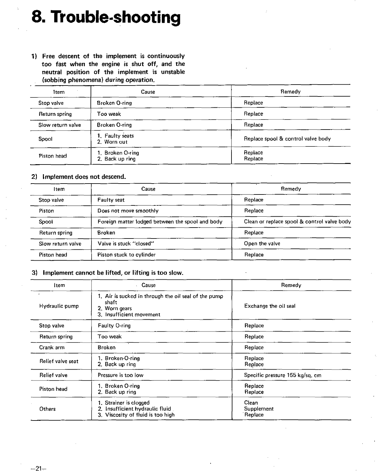

There are several O rings that could be bad and would cause the 3pt to fail Harry's air pressure test.
There are one or two O rings on the drop speed adjuster or "stop valve" - which is usually located under the front of the seat. That adjuster is just basically a needle valve with some O rings to seal the threads in the bore. Not all O ring materials are compatible with all hydraulic fluids....
And then there is the lift piston itself. That piston often has an O ring backed by a metal ring. If any of those O rings mentioned have gotten old and failed the 3pt won't lift.

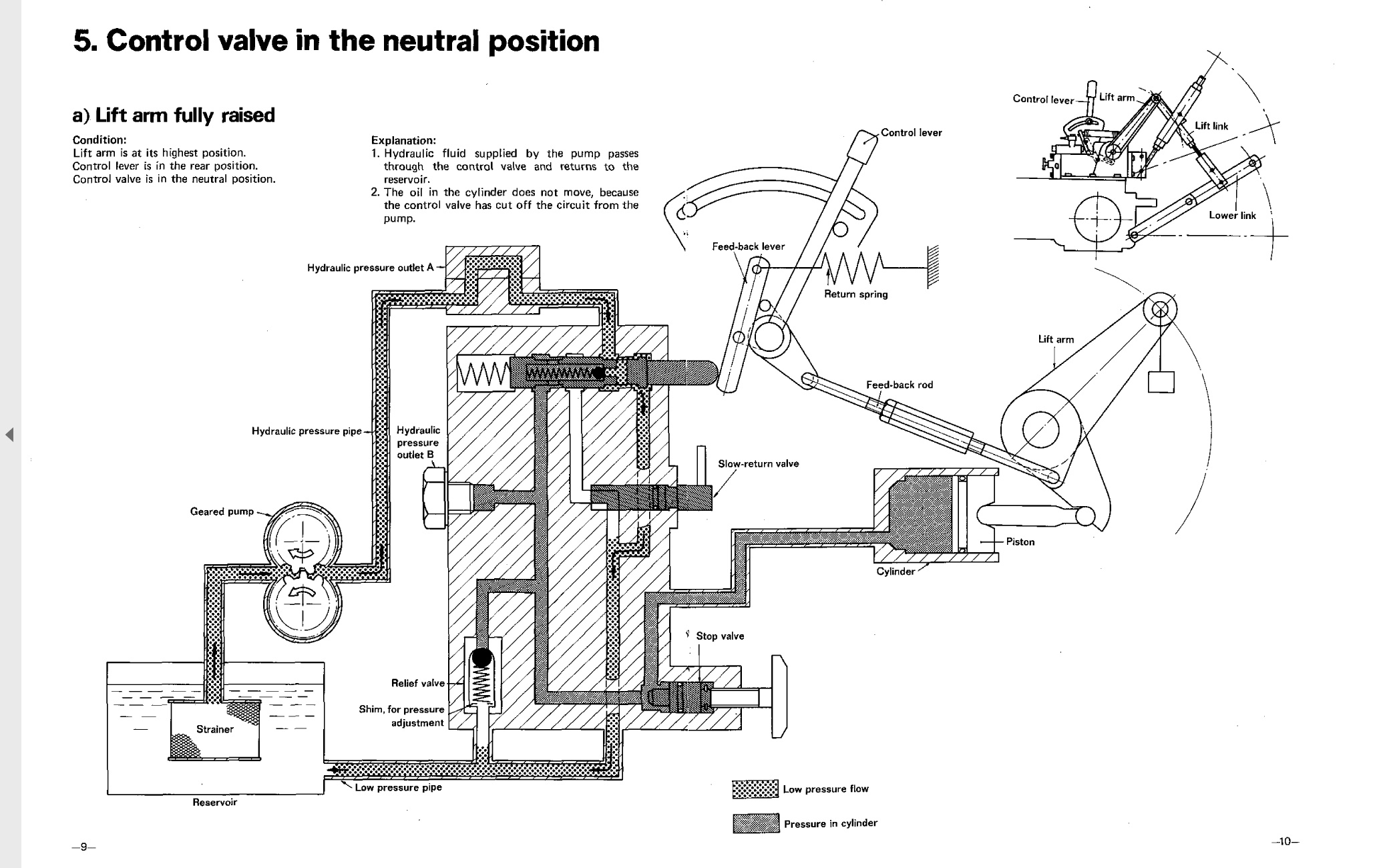

Note that the system relief valve is often on a circuit right there with the stop valve & accessible under a cap in the same area under the front of the operator's seat. A stuck relief valve would also cause the 3pt arm lift problem. Flow wise, the relief valve is downstream of all those O rings. A piece of O ring could conceivably jam the relief valve open. That's where I would look next; the relief valve and stop valve are easy to access & inspect.

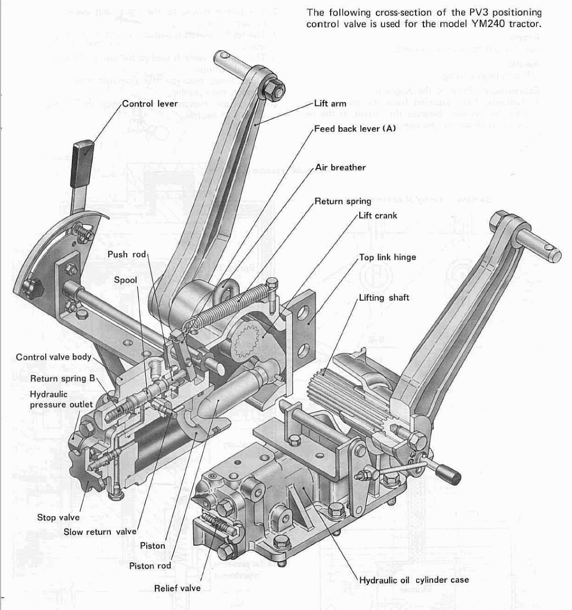

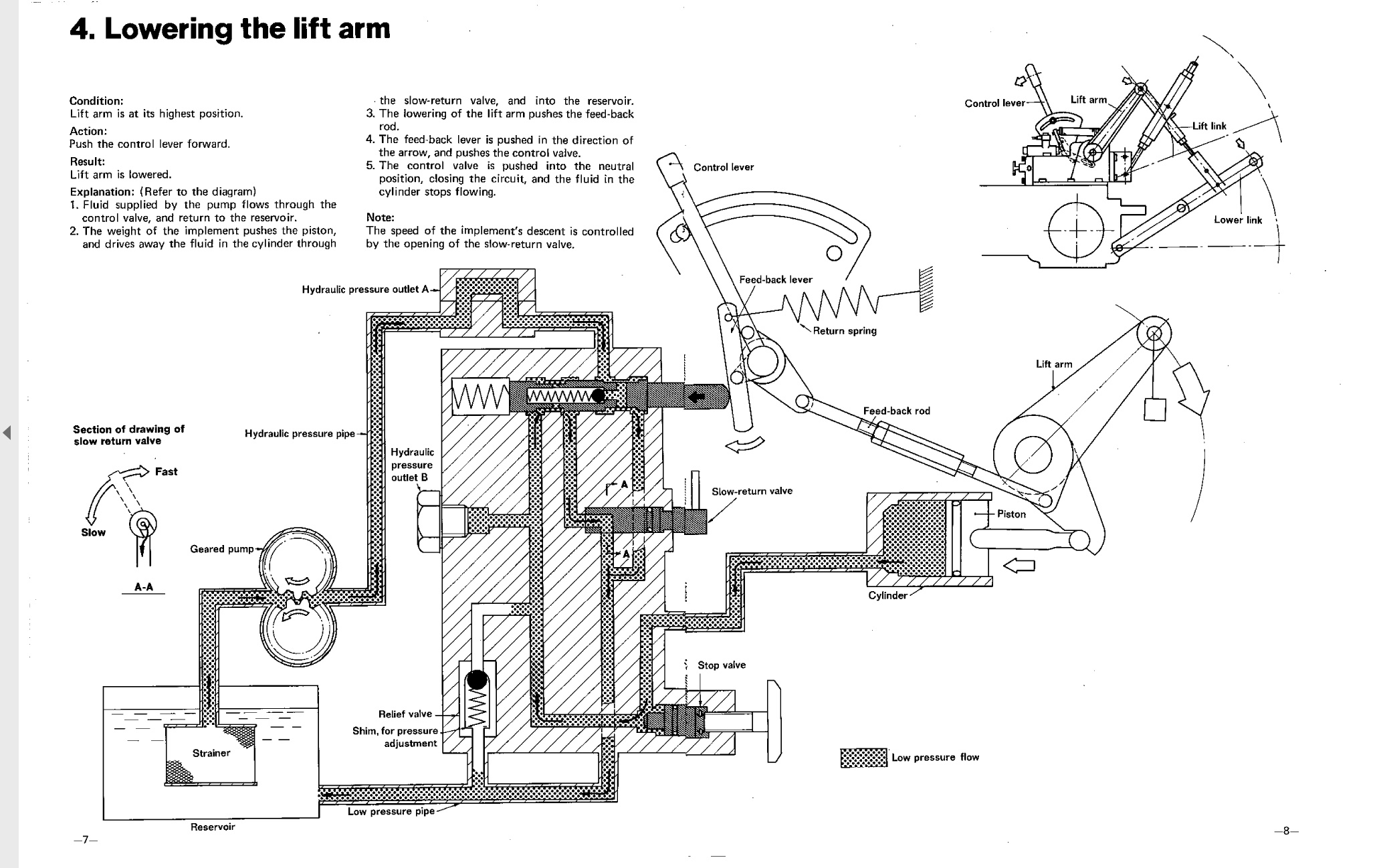

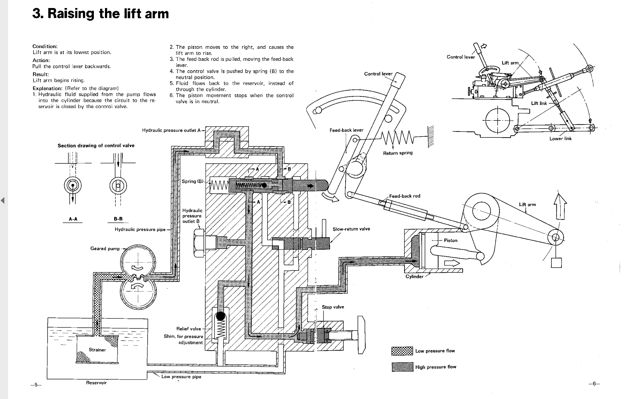

Here are some illustrations to study.
1_Artist Cutaway view of YM240 3pt hydraulics.png3_Raising the 3pt lift arm.jpg4_Lowering the 3pt lift arm.jpg5_Control Valve 3pt in Neutral position.jpg6_(8)Troubleshooting the 3pt lift system.jpg

It’s not going to be complicated when you find the culprit. Something is just broke on the inside. Like the big cylinder that moves the lift arms. Just use your vision
