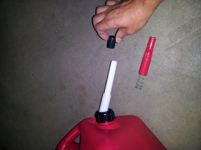

Here is a pic to help out.

Yeah that is one of the new ones the stores are full of.. I did not want one of those.. I found an old stock lever action can, in a low volume store, and it works pretty well. Especially if you pull out the safety mechanism. Of course yours probably works pretty good now.
James K0UA
Add a vent like I did with the valve stem and it will work great.

Unless those black plastic chair leg caps are made of HDPE (which I doubt), they likely will not hold up to gasoline well.
